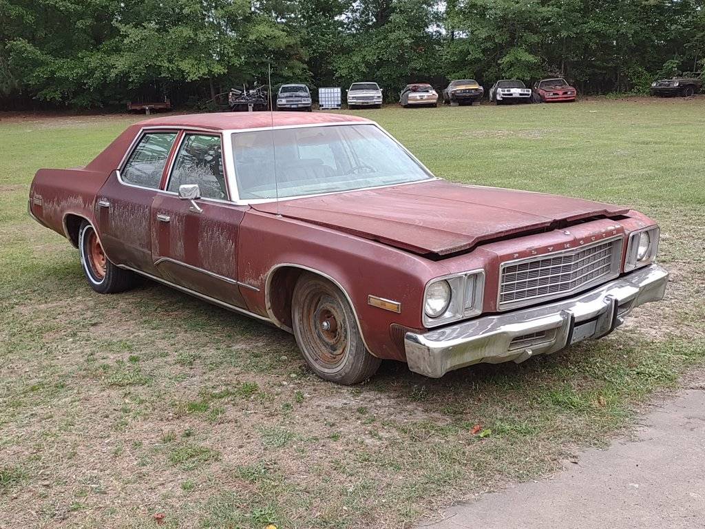

I'm debating whether or not I should fix this car and drive it. It's a 77 Gran Fury that was used as an undercover police car by the Cumberland county sheriff's office. It's got a lot of problems, a broken left torsion bar, broken front door handles, dead gas in the tank and some body rust issues. My dad bought the car about 30 years ago when they were dirt cheap as a source for heavy duty parts and 440 engines, he didn't dissect this one because it has a 400. It sat for the last 20 years in a field and I just recently got it running. It runs good, goes into gear and drives around, all the lights work and nothing appears to be wrong electrically. I love these old cop cars and they're getting hard to find, I wish there were more out there I could use for parts but I can't find anything. I don't want to spend a lot of money on repairs because of the body panels being shot and they're impossible to get. New torsion bars are several hundred dollars and I don't want to invest that kind of money if the car doesn't turn out to be streetable for some reason. I don't want to make anything fancy, if I can just get it in a drivable state I'll be happy. Do you think it's worth it?

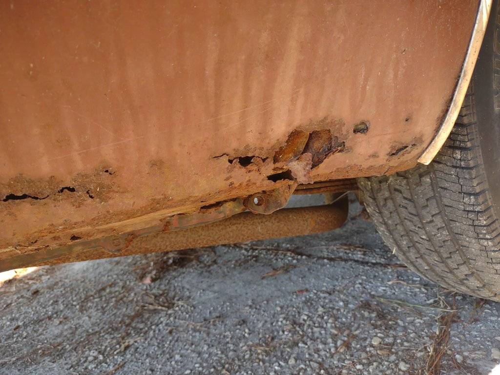

Other than the uniqueness of the police car, the main issue would be rust. Where it is and how much. Fenders and quarter panels are one thing, underbody and such are quite another.

The rust is worst in the lower quarters and trunk, it's completely rusted through there. The floor pans have a few small holes, but the frame is still solid at least. I'm not going to pursue this car as a roadworthy project for now because of the rust. I'm just trying to get it where I can move it around the yard. Also I found a potential source for torsion bars - I have 2 1965 Polaras that I can take the bars from, if they'll fit. I pulled the broken bar out of the 77 and it measures 47" long and 1.060 diameter, really big for a stock bar. For now I stick welded the old torsion bar back together to keep the car up, I'll see if it holds temporarily. I'm probably going to end up pulling the engine and transmission to use in my 74 Challenger. I guess I'll have to make due with my 81 Gran fury cop car for my bluesmobile, its in way better shape and has excellent road manners... unlike the gas guzzling 400, it will burn a gallon of gas just idling for 2 or 3 minutes. My dad is helping me with all of these projects, he's a Mopar guru and has tons of cars and parts laying around here.
Thats the rust?
