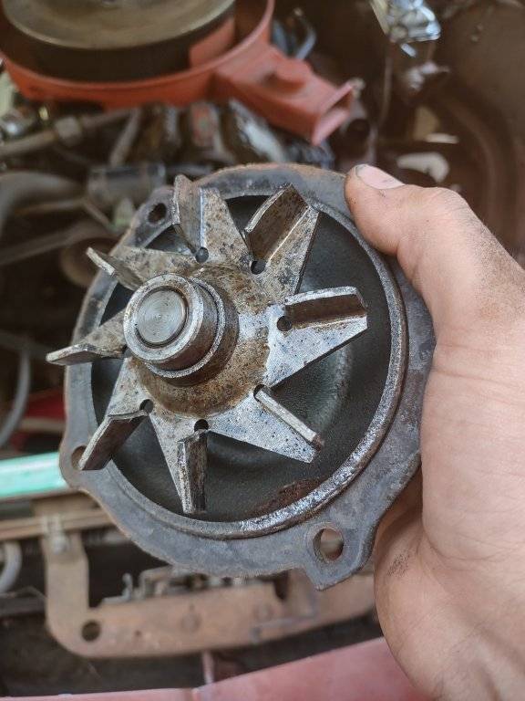

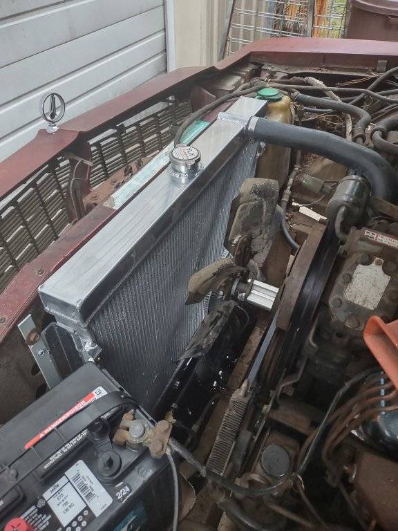

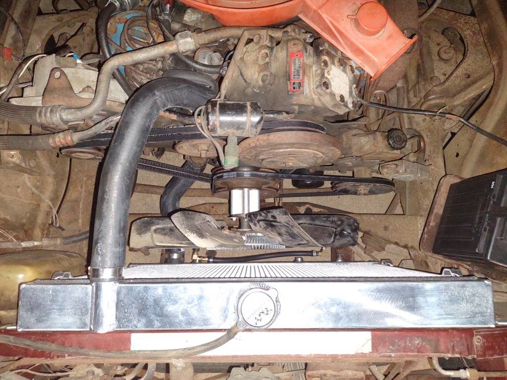

Well, I got the water pump and thermostat changed, this engine is incredibly clean inside. It's actually less rusty inside the cooling system than it is in the trunk, the old water pump looks perfect, I'm saving it in case this crappy chinese pump craps out. I got the radiator in too, as I suspected it doesn't even come close to fitting. The mounting holes don't line up, neither do the shroud holes or the trans cooler lines. I got it mounted and the hoses at least fit but I cannot physically mount the shroud without it hitting the fan and having a giant gap. I'm going to finish it tomorrow, use a fan spacer instead and just run all the trans fluid through the auxiliary cooler, drive it and see if it tries to overheat.
Went and drove the car around town with the new radiator, no leaks, and in the early evening with temps around 80 it never went over 190. Interestingly it actually idles cooler in traffic than it runs at high speed, would that seem to indicate I'm not getting enough water flow at high speed? Anyway, for how I drive it should be more than adequate even when it gets hotter, my commute to work is only about 3 miles in moderate traffic, if I decide to take it out on the road I'll see how it fares. Oil pressure is a tad low idling in gear, the gauge reads about 10 psi with SAE 40 Valvoline VR1, then again this engine has 135k miles and was made with loose bearing clearances to begin with for HP use. Even though the performance is adequate for me I wouldn't recommend the champion radiator for C bodies since the bracket and cooler lines just don't fit and I had to fabricate a mount and rely on the auxiliary cooler.
Took the car on an 80 mile road trip today, temps were in the low 90s and it ran fine at 70 mph on the highway. The gauge stayed about 180 on the road and never went over 190 in traffic. The shroud is apparently not necessary on a big enough aluminum radiator with the stock 7 blade clutch fan.
If you were towing OR sitting in bumper to bumper for an hour you'd probably need it.

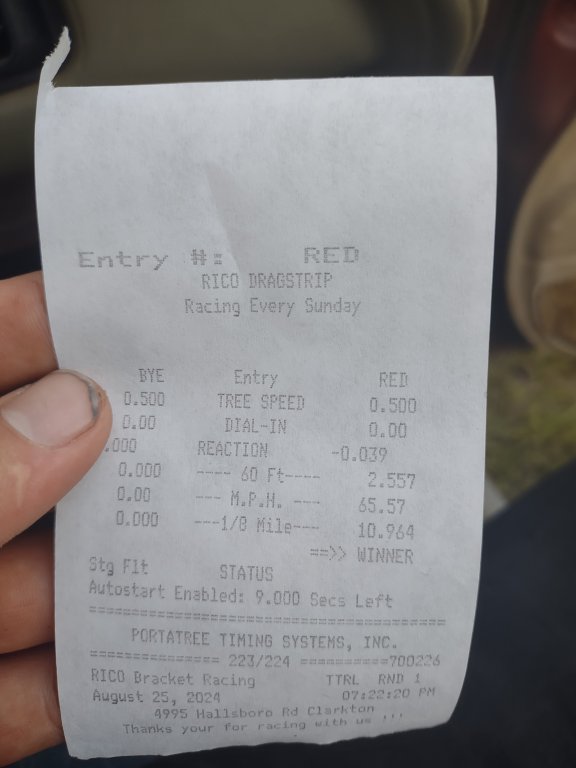

I took the car on a road trip to the drag strip yesterday and made a time run just for fun. It did about what I expected, 10.96 at 65.5 mph in the 1/8. It weighs a bit over 5000 with me, the spare tire, a full tank of gas and all the spare parts in the trunk in it. The 60 foot sucks because it's so slow getting off the line but once it gets in its RPM zone it takes off.
