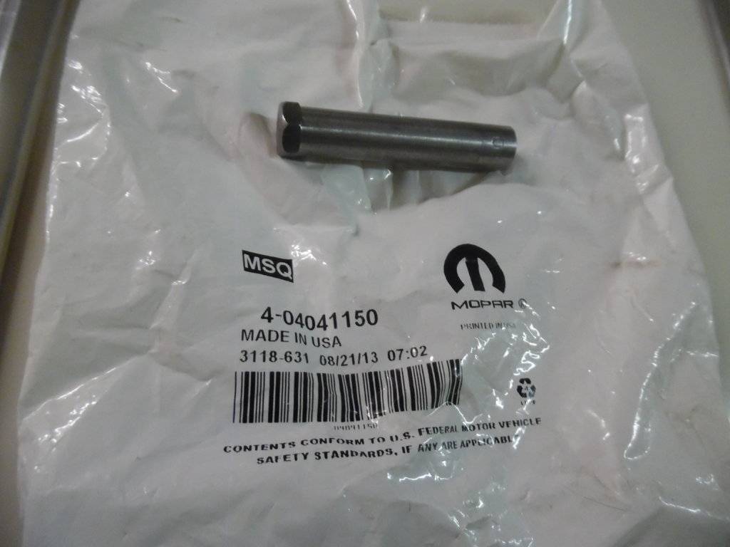

Yes 440, log style with studs nuts, and the various long style nuts, That is what I am struggling with. Will check Mancini.

Thanks, I get studs from many places, and Midwest Muscle Car can make a set, I just need the length and number of the long nuts.

These might still be available through FCA, they are 2-7/8" long overall. The earlier versions were open at both ends, these should be correct for the late engines. Lynn

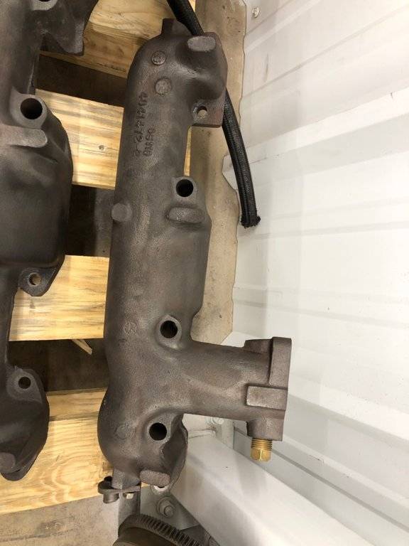

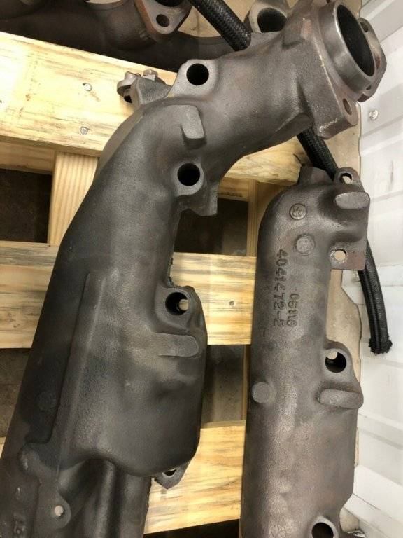

Dave,
Pictures of exhaust manifolds below. Looks like I need 6 extended nuts.
