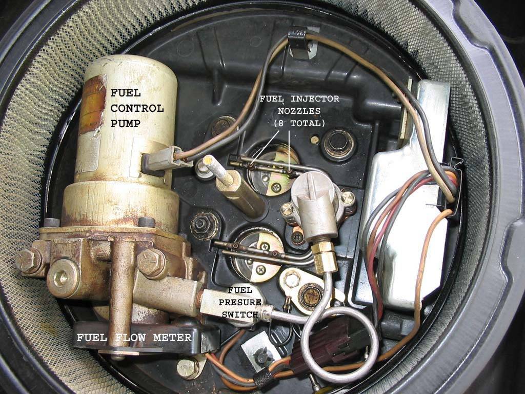

EFI module (electronic fuel injection module that replaced the standard carburetor) has been completely rebuilt. Used NOS parts sourced from a former dealership parts man. This includes the high pressure fuel pump and electronic module and circuit boards.
The car will crank but not start. This is probably due to the actual fuel injectors that should be removed and cleaned - usual maintenance. Mechanic is a one man shop who worked on the car when time allowed. Has too many cars in house now so cannot complete this work. Vehicle comes with a Chrysler EFI Tester tool made to be used with this car.

If it cranks but won't start, probably needs the air cleaner lid clamped back on! Mass air flow sensor in on the fuel plate/bottom casting of the air cleaner assy? No sensed air flow, no "run, " fuel, just starting.

For many years, I'd heard about how troublesome the particular efi units were, that Chrysler Aerospace rushed them through R&D into production. I can see that as GM and Ford each had their own efi units back then, as crude as they might be. Plus the upper level models the Imperial might have been positioned"Befo against usually had efi. Be that as it may.
To me, it was a somewhat neat system, having everything on the "fuel plate" (i.e., air cleaner base housing), rather than spread throughout the engine bay. Less production complexity and easier to add-on. There was a primary spray bar and a secondary spray bar, but the limiting factor was the basic cfm of the unit and its adaptation to an existing 318 intake manifold. NO performance orientation, just "EFI" for what it was worth. More about better fuel atomization than anything else.

These EFI's were a total disaster. I wouldn't waste anytime trying to get it to run. I would as others suggest and put a modern 5.7 or a 360 with a sniper fuel injection system. Why not...

The only special sensors were a simple magnetic speed analog-to-digital convertor (next to cruise control) and an analog-to-digital flowmeter in the fuel curcuit. The latter was changed when factory conversion was done. Between those two, all the cluster computer functions were possible.
