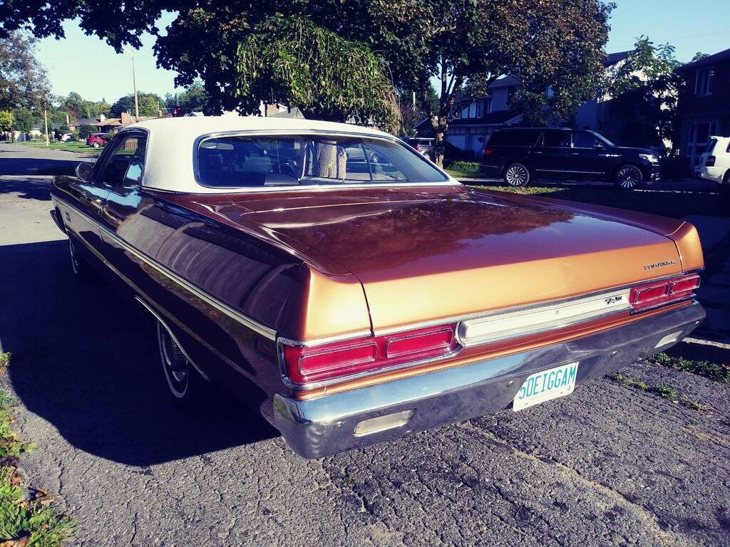

To re-cap:
318 poly in my '67 Monaco was replaced in 1986 by reman LA318 bought from the same chrysler dealership where the car was originally bought from. I had to acquire oil pan, rocker covers, exhaust manifolds and possibly intake manifold, distributor and carb to complete this engine swap.
I put about 10k miles on the car from that time up until maybe 1995, car was in storage from 1999 and only last year did I fire it up for a few miles of driving before it went back into storage until a month ago. I don't recollect if it idled well or not back then, I'm assuming it did.
Current issue - it doesn't idle well. Very rough. Carter 2-bbl carb.

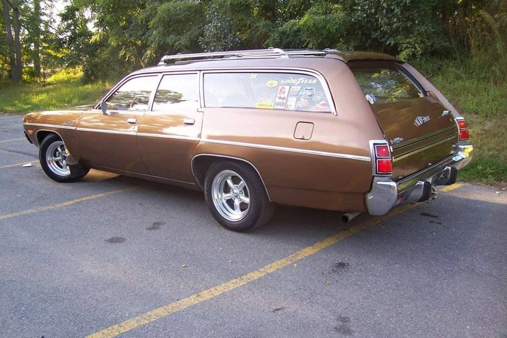

I have two 318 cars. 69 Fury III and 73 Satllite wagon. Both have higher initial timing than factory to run smoothly on today's gas. The 69 has 12 degrees with Pertronix ignition inside factory point distributor, and the 73 has a recurved electronic ignition distributor set at 20 degrees, and all in at 2800 rpm with a total of 37 degrees.
Both cars have hotter Accell Super Stock coils, and plug gap is at .37 ( not .35) for a better spark.
You can benefit by going electronic ignition and recurve the distributor.

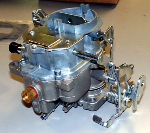

The car is in storage now, but I did buy and install one of those "Dromodary" brand BBD clones off Amazon for under $100:
It came with a couple thin gaskets, and my original wasn't up to snuff so I had to go buy a new one locally (about $15). It's about 3/8" thick. I'll have to do something about the choke pull-off linkage because it's not long enough. This carb has a bunch of ports I had to close off. It's got integral throttle spring which apparently doesn't replace the existing spring, I guess at some point regulations required it.
This type of "tin-hat" BBD is new to me. The power piston is directly driven by the accelerator linkage, vs only vacuum with the older type. I was putzing with this carb for a week around mid-october, it works, maybe it's better than what I had, maybe the idle screws are more responsive and actually do something. But maybe the so-called gasoline that I was using (87 octane, unknown amount of ethanol) is a confounding factor. I drove the car to storage with the carb, so it worked ok for that.
