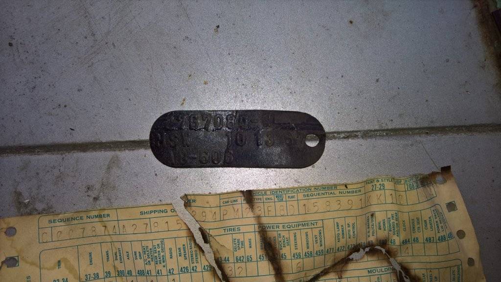

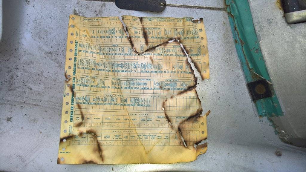

reviving a dead thread here but anybody know what this is?( I'm having an issue uploading the picture but ill put it up as soon as I get home.)
That piece of paper is your build sheet. That is a checklist illustrating (among other things) the options the car was built with. It usually gets stuffed under the back seat when the car is assembled at the factory
I have no idea what that small tag is, though.
the metal tag has to do with the manufacturer of either the rear seat frame or cover. i don't think we ever found a conclusive answer for it.
