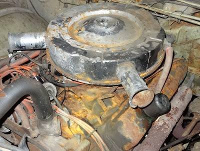

I didn't realize I had such an oddity. The valve covers each have a pipe out the top (as normal I believe), one for the PCV and one for the breather. The air cleaner and breather have a nipple and they are connected by a rubber hose, as shown in Nick's Garage air cleaner site, and he identifies it with CAP stuff. Here's my engine with the breather connected to the air cleaner (yeah, it's filthy):
