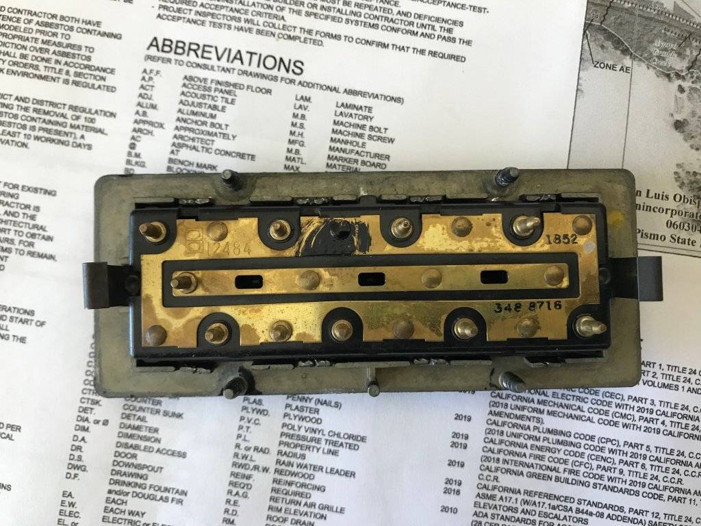

I am looking for a good working or NOS 4-gang power window switch, part number 3488716.
Fits: 1973 Chrysler plus probably other years....
Thanks,
Thanks x 2.

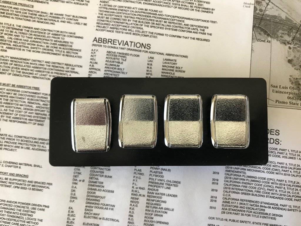

It doesn't look like these switches can be taken apart. Mine works, but the drivers door switch is "flaccid" and its contacts are intermittently failing. I seem to recall spring wires in these that kept the buttons "at attention".....

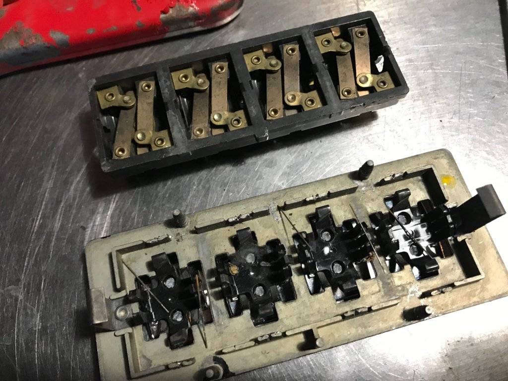

Update....got the switch apart. The contacts seem ok, but missing spring wires and broken plastic clips on one button which hold the buttons "up".
We'll see what Devinism says - if he's got the technology and parts to rescue this one....
