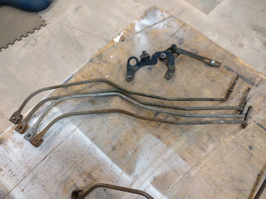

For Sale 440 kickdown linkage
No, I don’t have anything yet except a 400 and a 727. Going in an A body swap. Thanks
I'm not sure the single rod kickdown will work in an Abody because the whole rod moves back into the firewall... the older 3 rod version from a 383 will though as the middle rod moves downwards to the lower pivot on the side of the transmissions bell.
Hope that makes sense.
This was the case with my '67 Dart,I needed the three piece kickdown to work properly.
