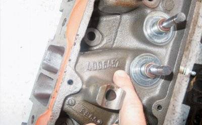

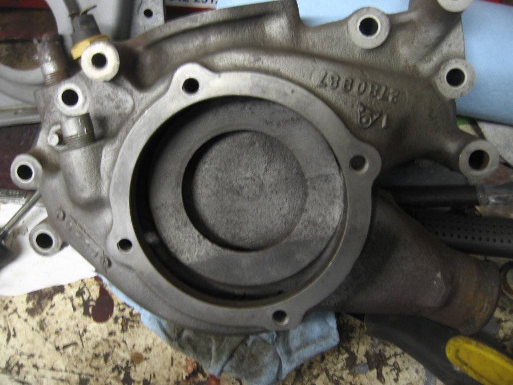

Both do have casting dates. Both could have been swapped out over the years too.
The heads will have the date on one of the runners similar to the casting number's location.
w/p housing typically has casting date right next between the heater hose fitting and mounting boss for alternator brackets..

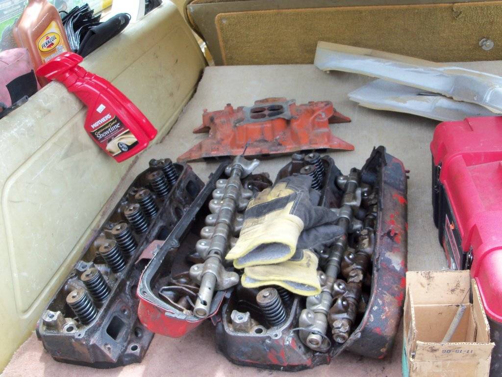

516 heads do not have core/freeze plugs in the ends, and have 6 bolt covers
Nice! Learn something new everyday!! :thumbsup:

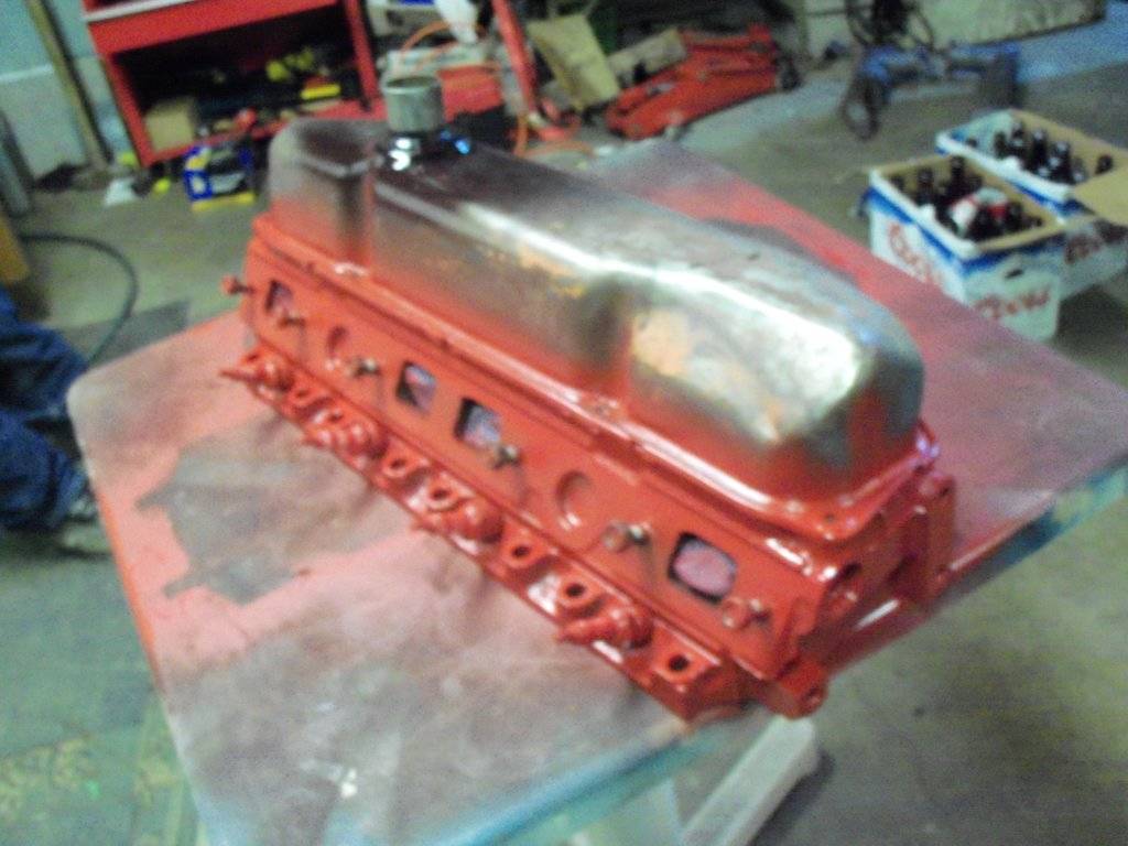

Found a pic of the 66 300 516 heads...no freeze plug at end of heads...
And the 452 head painted Canuck red before going on the motor..has freeze plug at end of head.

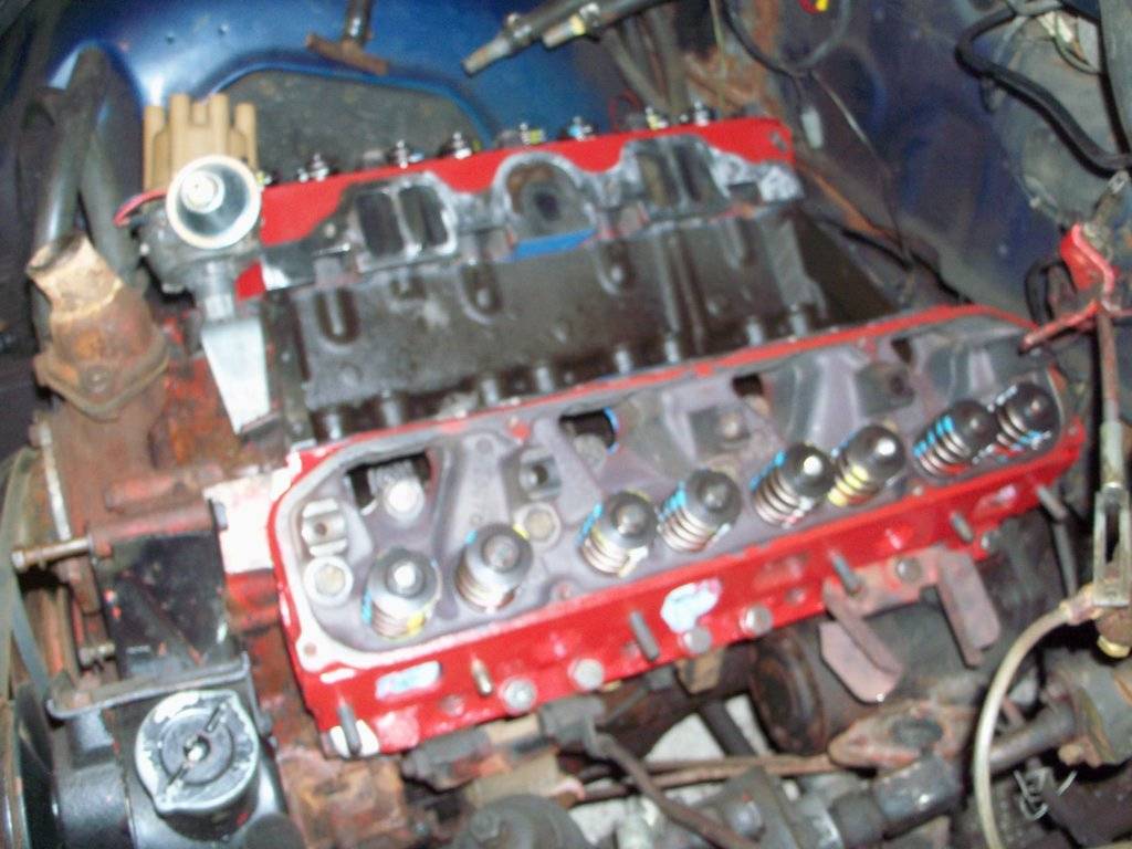

I personally wouldn't fool with any of them unless they were fresh from a competent machine shop for cheap. You can't build a set for what 440Source Stealths go for and once you paint them red they vanish. Have them inspected and corrected (valve job will be awful as is all aftermarket heads) and all your unleaded pump gas pinging problems will be a thing of the past.
Kevin
My ‘67 is an early build and had 516s which I replaced with 915s that I installed bigger exhaust valves in. I have no problems running pump gas with them for many thousands of miles and the rebuild of them was a shade over a grand. I’m still waiting for iron heads to give me a reason to not prefer them and frankly I hope it never happens.
