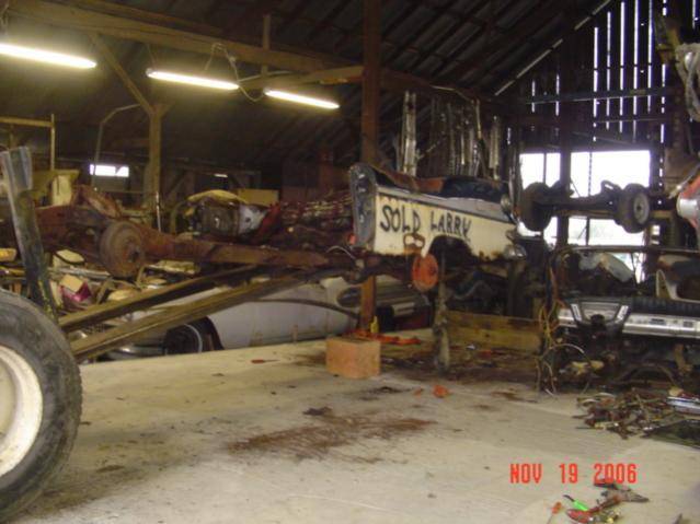

A friend then picked the trailer up, and we unloaded the car here with help from a forklift.

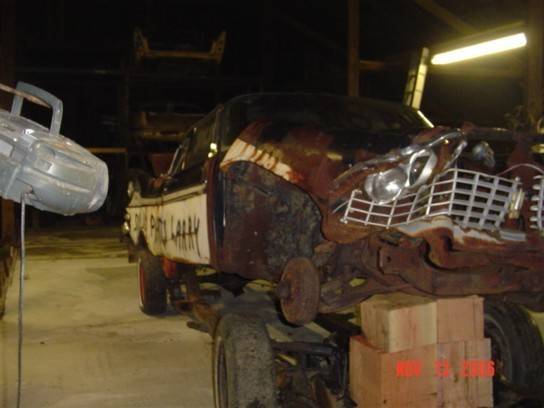

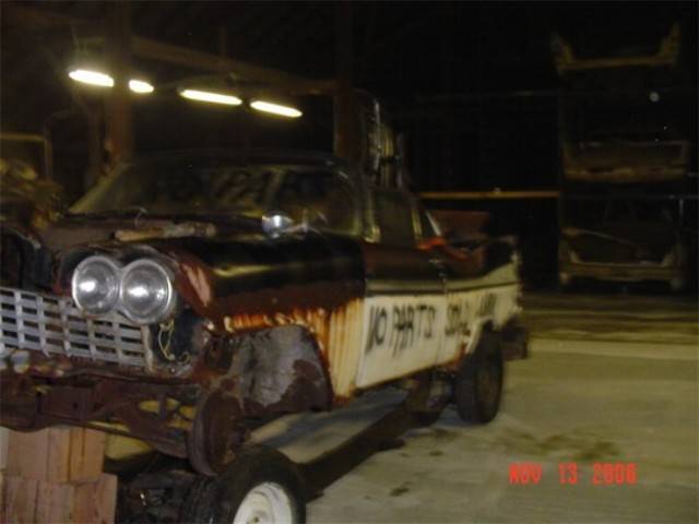

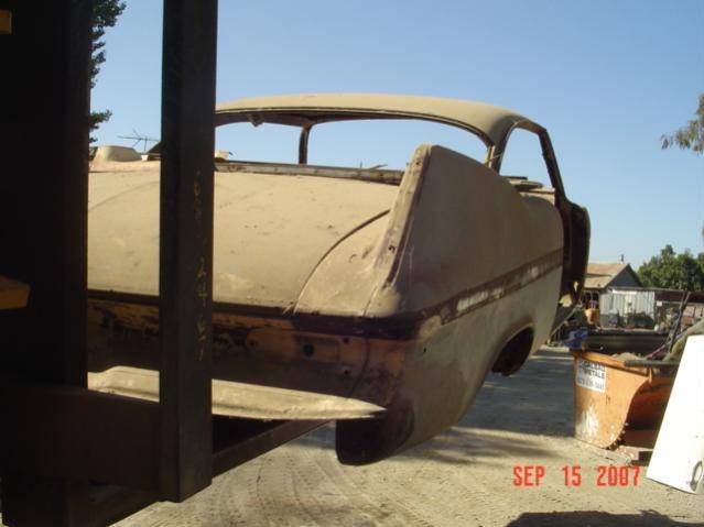

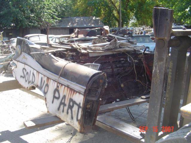

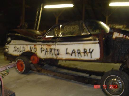

This is what the car looked like when we unloaded it into the barn. '59 SF convertible 002.jpg'59 SF convertible 003.jpg'59 SF convertible 004.jpg'59 SF convertible 005.jpg'59 SF convertible 002.jpg'59 SF convertible 003.jpg'59 SF convertible 004.jpg'59 SF convertible 005.jpg'59 SF convertible 002.jpg'59 SF convertible 003.jpg'59 SF convertible 004.jpg'59 SF convertible 005.jpg

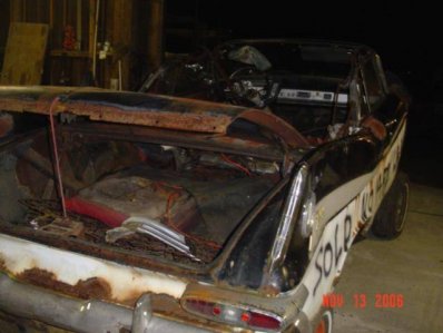

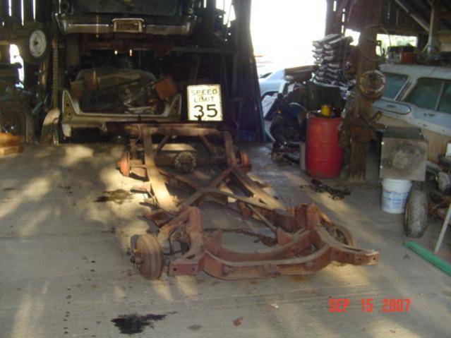

'59 SF 002.jpg'59 SF 003.jpg'59 S.F. convertible 002.jpg'59 S.F. convertible 003.jpgLooks like I loaded a few too many of the same pics!
Next, was to determine what was usable, what was not, and separate into two chunks.

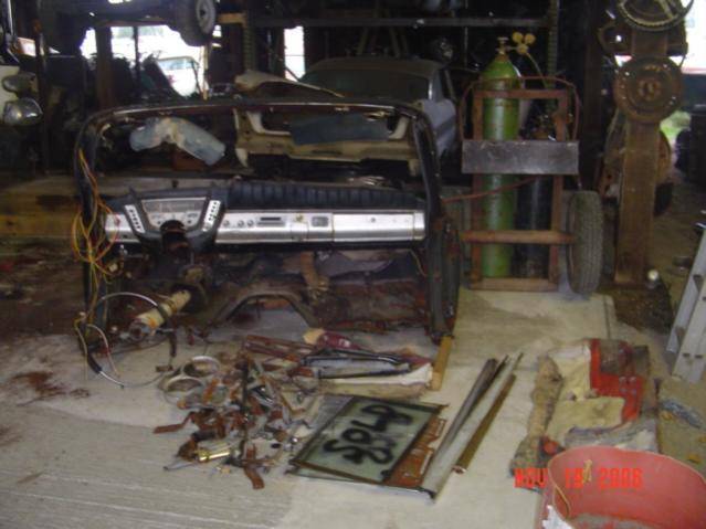

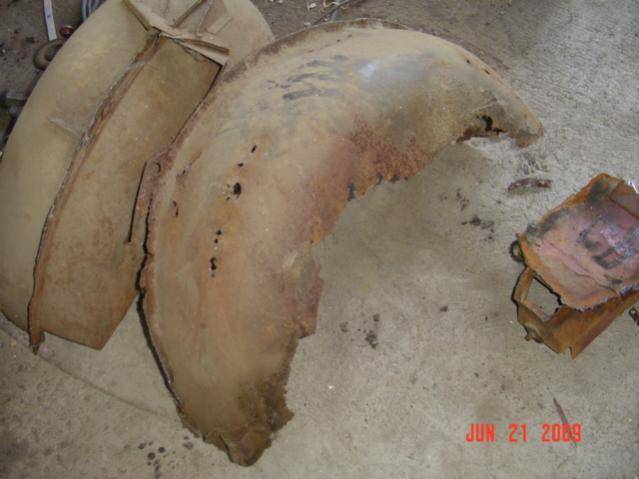

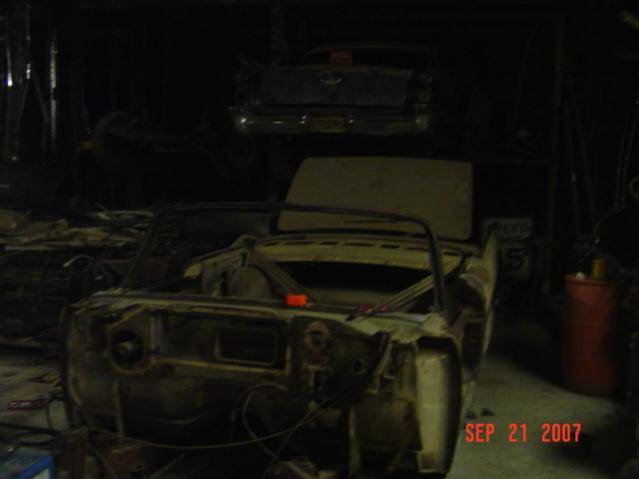

'59 S.F. convertible 005.jpg'59 S.F. convertible 006.jpgI bought a '59 Fury coupe that had been setting in a goat pasture for years, the entire top of the car was nothing but dents, and the glass was opaque from hooves sliding across it. There was some rust in the lower areas, and shag carpeting inside that had the distinct odor of cat urine. Looks like a good pats car candidate!
I stripped off the usable parts, and removed the body from the frame.

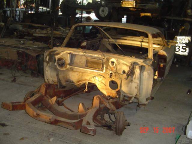

'59 S.F. convertible 008.jpg'59 S.F. convertible 009.jpgI placed the coupe body onto the convertible frame, and fastened it down. Next, I drilled the spot welds out of the A-pillar, and cut the C-pillars, in order to remove the roof.

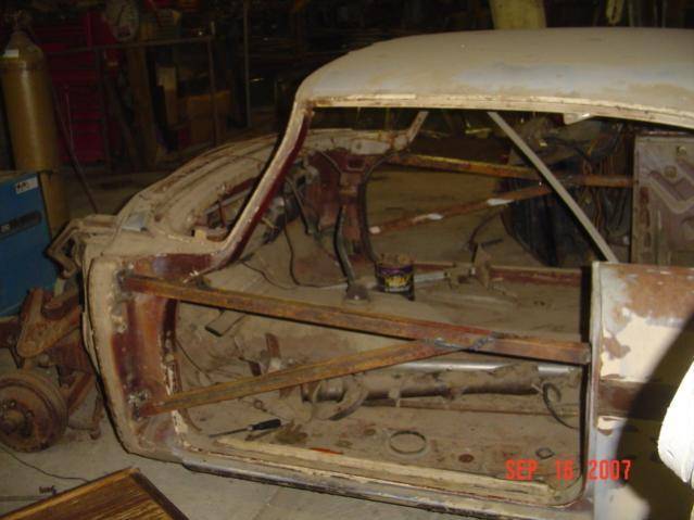

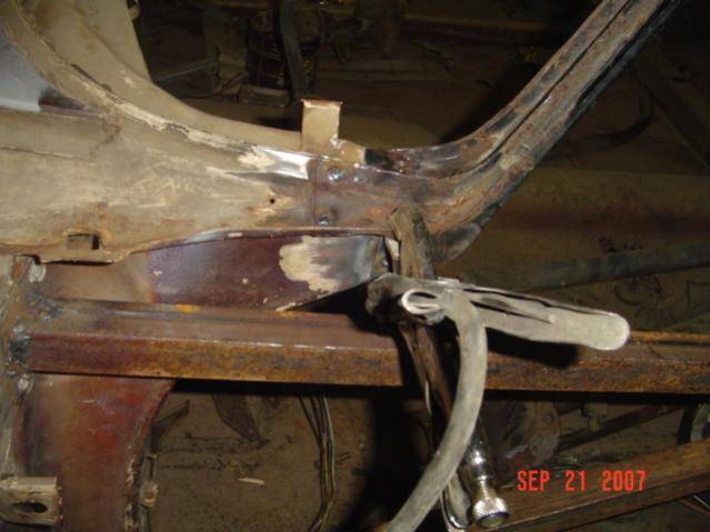

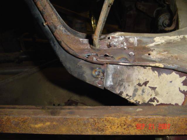

'59 SF windshield frame 001.jpg'59 SF windshield frame 002.jpg'59 SF windshield frame 009.jpg'59 SF windshield frame 008.jpgBefore removing the roof, I made side braces using square tubing, these fasten to the striker plate mount and the door hinge mounts. I can re-use them on any '57-9 Mopar, except Imperial. After removing the windshield frame header from the convertible, I rosette welded it onto the cowl of the coupe. This will give a factory appearance and strength.

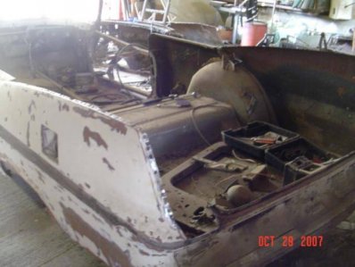

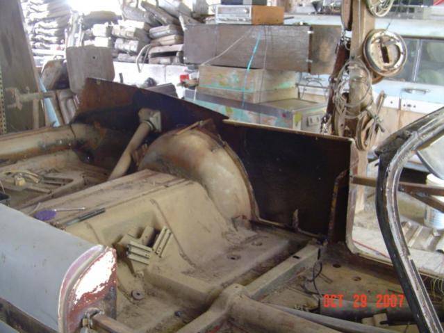

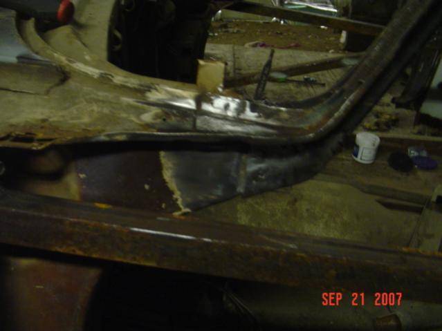

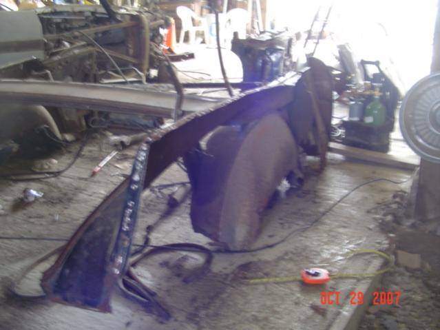

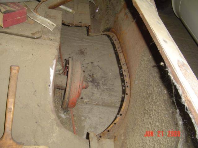

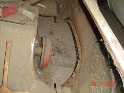

'59 SF 010.jpg'59 SF 008.jpg'59 SF 012.jpg'59 SF 009.jpgThe rear tub area was next. I drilled all the spot welds out, and removed this entire area from the coupe. This allowed me to access the rear wheelhouses, which would need to be removed, as the convertible ones are different. Next was to remove the wheelhouses.

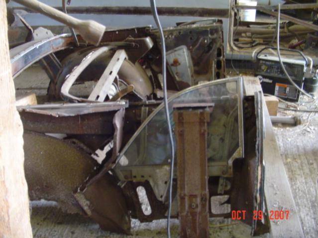

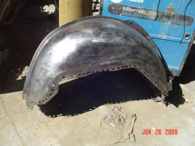

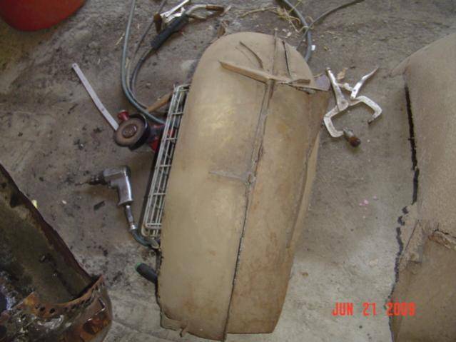

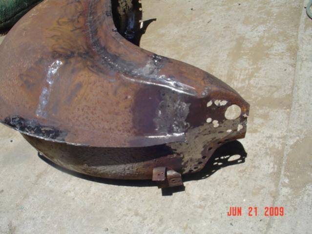

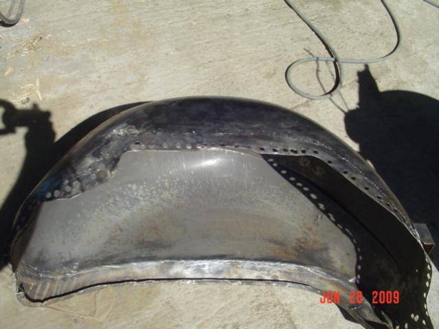

'59 SF convertible 010.jpg'59 SF convertible 008.jpg'59 SF convertible 009.jpg'59 SF convertible 011.jpg'59 SF convertible 012.jpgNext was to remove the wheelhouses carefully. The lower portion of the coupe's wheelhouses will be used to repair the special convertible ones, butt welding is used for a good outcome. Not an easy task to get done!

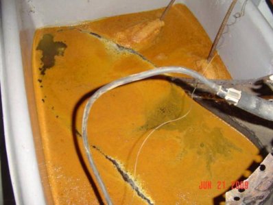

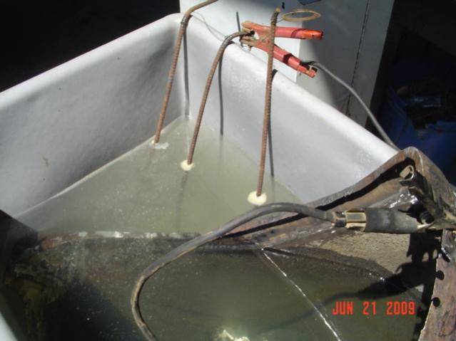

'59 SF convertible 014.jpg'59 SF convertible 006.jpg'59 SF convertible 016.jpg'59 SF convertible 017.jpg'59 SF convertible 018.jpgAfter cleaning up the welds, I submerged the pieces in a mixture of baking soda and water, and ran current through the mix with a battery charger. Reverse electrolysis is one of the better ways top clean rusty metal, and there are no hazardous byproducts. Note- this must be done in a well ventilated area, as hydrogen gas is created.
