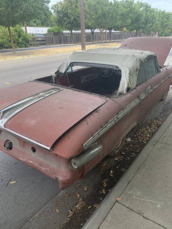

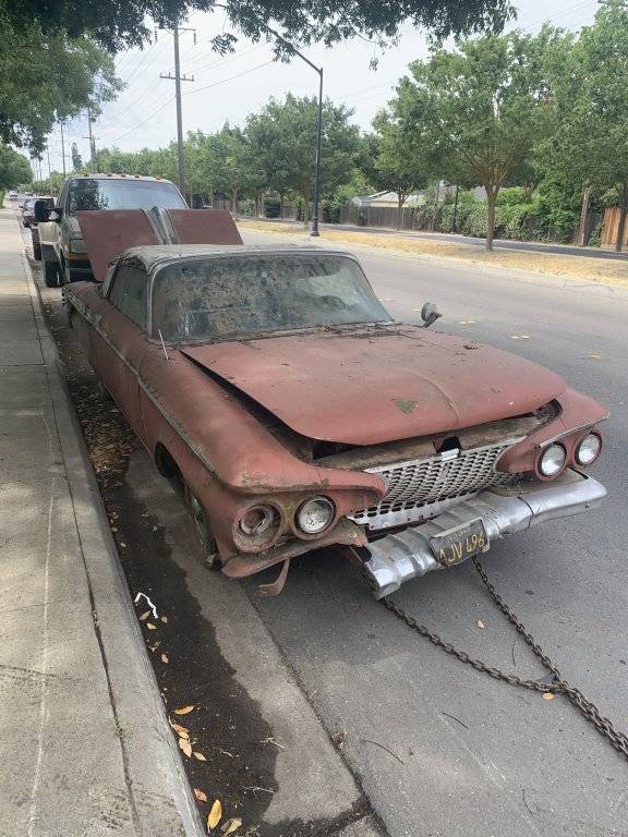

I picked up another red 61 conv today at an estate sale.
I believe it only has 71k miles on it.????
Plate says last driven in 67?
Rare Poly 318 with 4blb/Air cleaner.
Decent interior,uncracked red dash pad,Mint door armrests which are VERY hard to find.
Nice aero wheel, solid body.
Has NO rust spots under rear 1/4 glass.

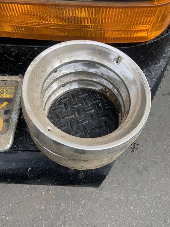

Found 4 NOS headlight rings in shed…….!!
The bad is it has a very wavy drivers 1/4 that will likely need replacing.

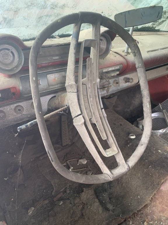

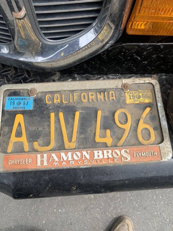

Good find! The license plate is an early yellow & black one, I suspect that it was the original one put on the car.
Plate tag suggests conv was on the road 1967?
