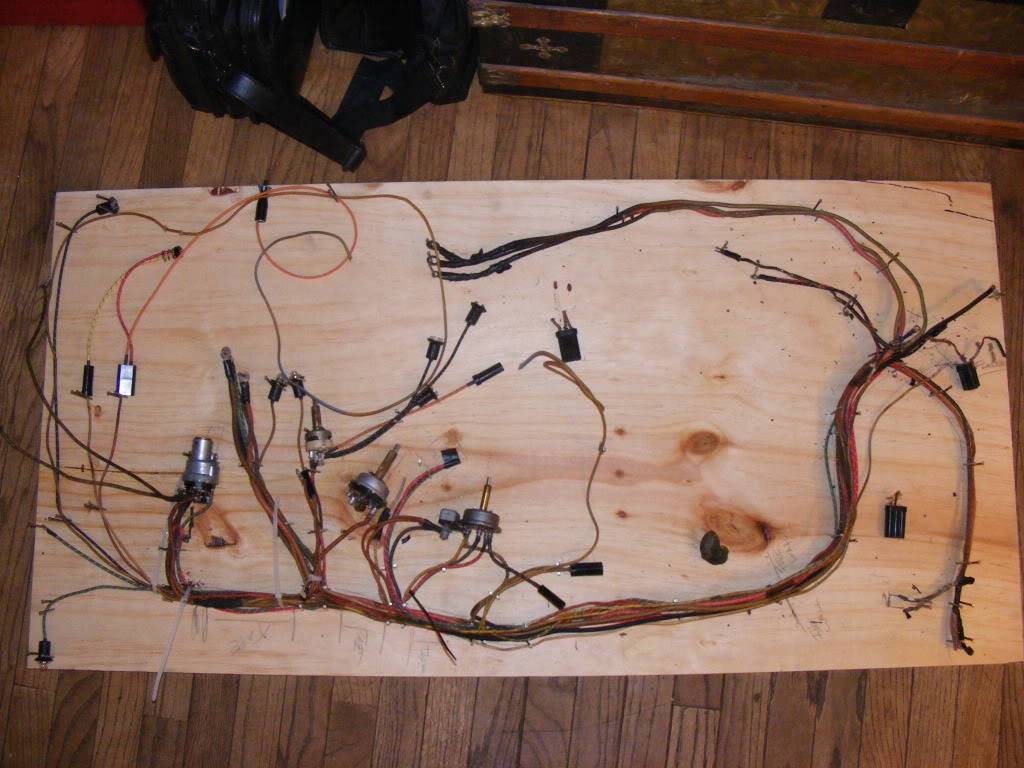

Another option and one I have used myself on a couple cars, is to rework the existing harness. You'll need the FSM for the wiring diagrams, a piece of plywood or particle board and some finishing nails.
Get a FSM here if you don't have one. MyMopar - Mopar Forums & Information - Service Manuals
Grab a parts book while you are at it. MyMopar - Mopar Forums & Information - Parts & Accessories Books
You lay out the old harness, remove the tape and replace the wires one at a time.
Get the wiring supplies here: Rhode Island Wiring Service Inc.
Finish with non-adhesive electrical tape like this: 1 Roll Factory Electrical Non Adhesive Wiring Harness Friction Tape OEM A NOS OE | eBay
