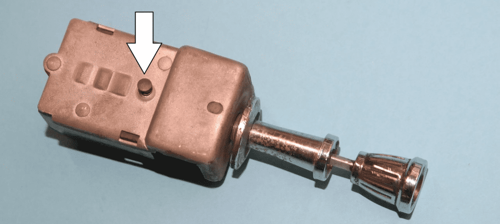

If it's a pull type knob, and you're attempting to get the knob out and then remove the switch entirely, then the knob and its shaft are held into the switch by a little detent button.
Reach under the dash and feel around the switch for a little pushbutton on the top, side or bottom of the switch behind the dash. Push it and the knob and shaft should come all the way out. Then you can remove the trim bezel and nut and the switch should come out from under the back of the dash.
The HEADLIGHT switch is pictured and the instructions are correct for that. Did you mean headlight switch or wiper switch?
