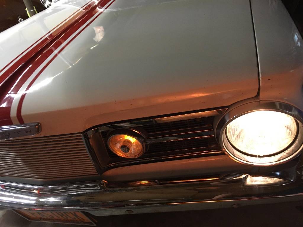

Not necessarily... One of the differences between the '64 and '65 Barracuda is the parking lights come on with the lights on the '65 models. This fact seems to be pretty well documented.
This one is my '65.
From what I seem to be able to figure out, there's not any set year for the change. I was really curious about this and there's a ton of conflicting info out there... So I can't say what is the truth.
