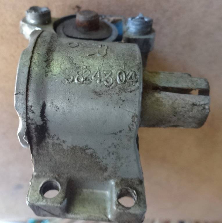

I need a right side vent window regulator for my 67 Polara. part number 3824304, stamped on the part. 65/66/67 .... same. Not sure about 68.

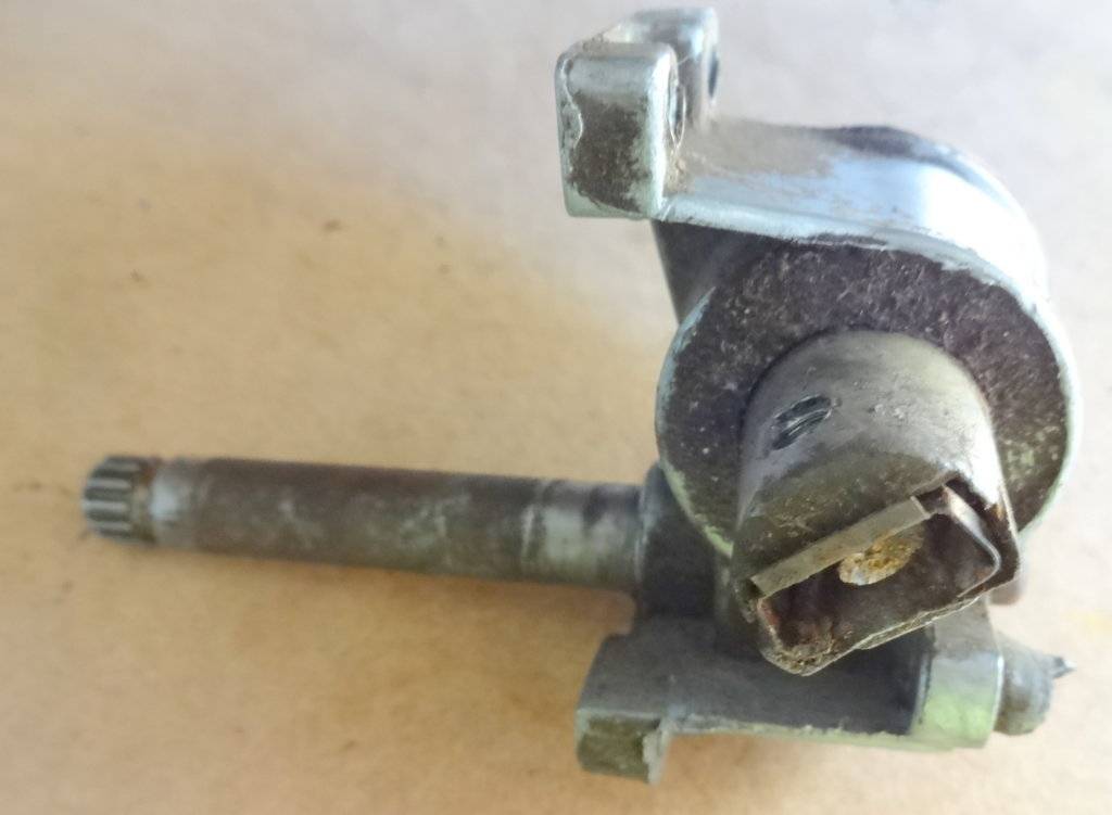

I have had good luck with drilling and tapping the staked pins for a 10-32 screw and putting the plate back on after replacing the grease....if that helps you any.
Thanks, I have done that in the past with these but haven't found the missing part. I can't imagine where it went to, no place I could see where it could fall out of the door. I'll look again tomorrow.
im thinking left and right are different numbers..3824303 LH /3824304 RH Oddly I think they are also used in 65-68 corvettes...
I have a set of doors in storage, I'll head over tomorrow and see if they are the same number, 66 Polara.
I have four spare doors, all with the regulators inside.
Your correct. There's a left and a right. The number on the housing is apparently not the part number. My 67 books shows 2486802-3. 65/66/67 I think. Imperial is a different number.
