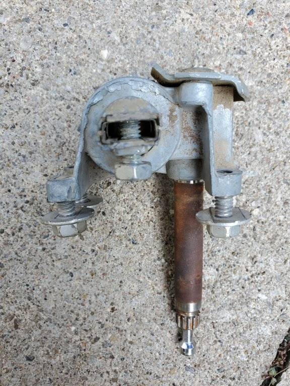

The above pic is a top view showing the correct alignment of the pivot slot on the gear. Note that the slot has a steel liner inside which I suspect is there to prevent crushing damage from overtightening the bolt. The original gear was missing that liner. You will need to reach inside the door to hold the gear as you remove the last bolt.

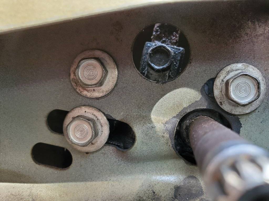

Note the position of the pivot bolt at the top. Reach inside the door with the replacement gear to align it with the pivot shaft. Once the slot has received the shaft screw in the pivot bolt. I found using a wobble extension helped with this finicky task. Then put in the remaining 3 bolts and Bob's your uncle.

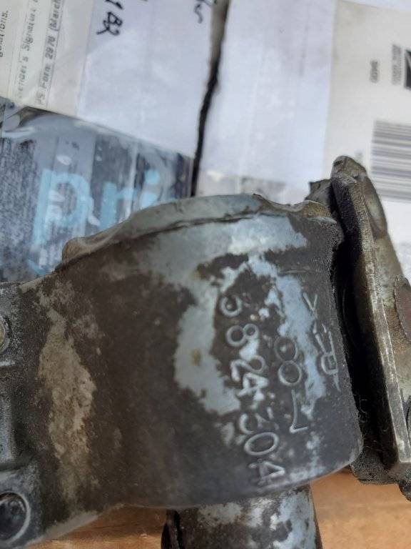

Here is the part number if anyone wants to source a replacement.
