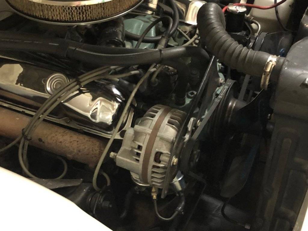

It looks like the alternator was on the drivers side but couldnt seem to make it work, so I’m mounting it on the passenger side like I’ve seen in pictures. Now I need to buy a regulator and figure out where it’s suppose to go.

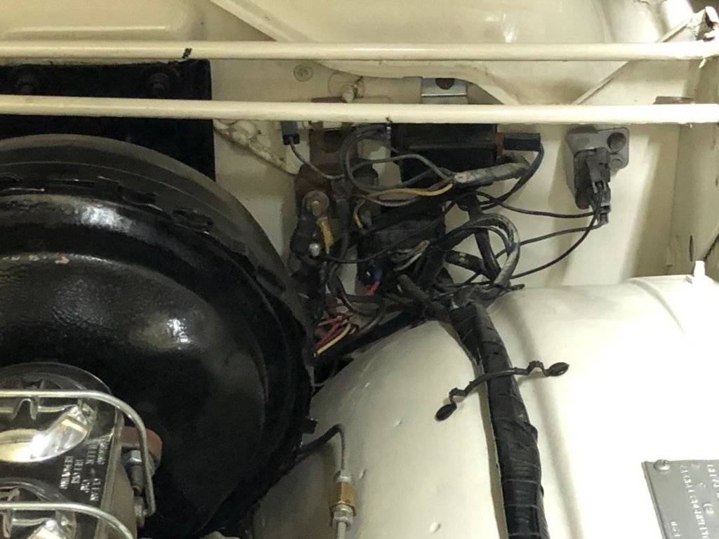

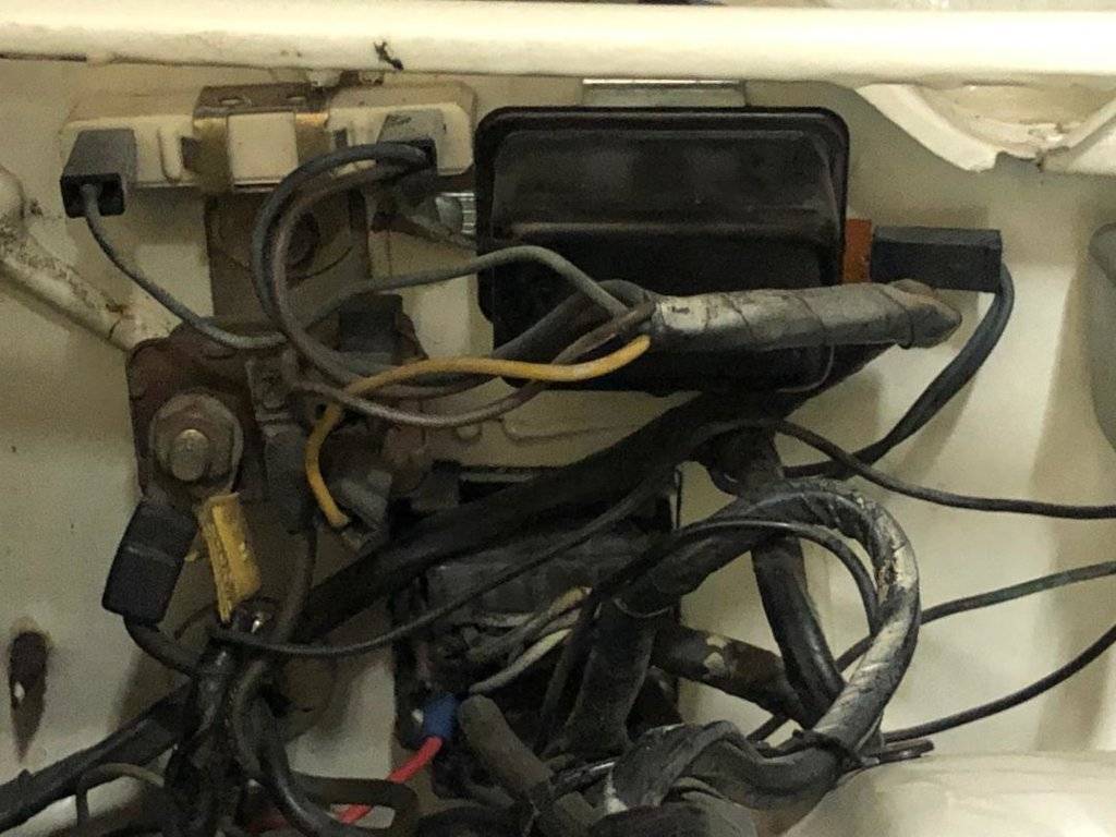

Someone has done some hacking on the wiring. I think they may have tried to put a GM internally regulated unit on it.

Hope this helps, from my 65 Fury
