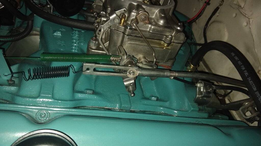

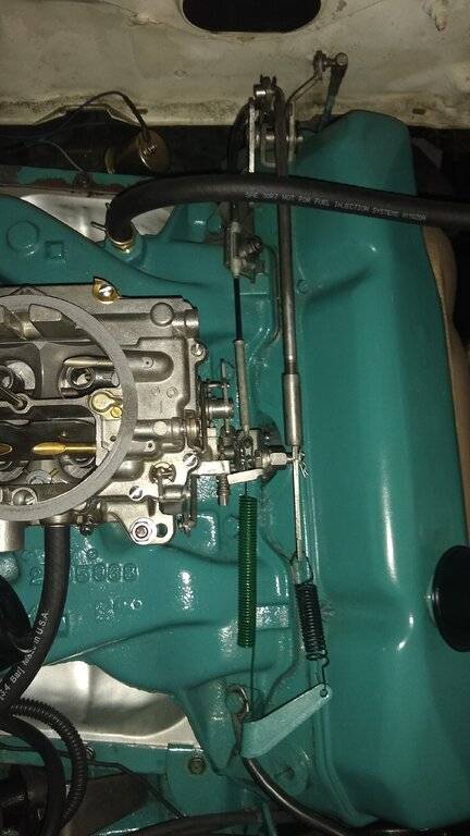

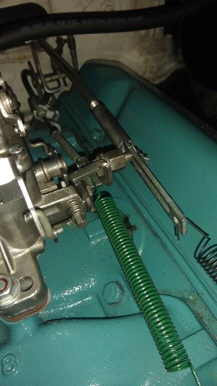

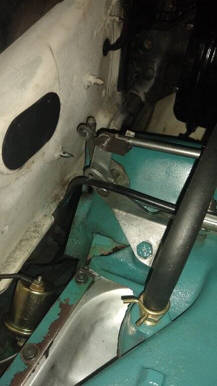

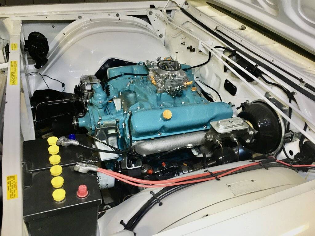

Hiya Mate. Sorry I'm jumping in this one a little late. I haven't been on the forum lately.
Here's mine, and it's factory on the factory Carter AFB.
My block was setup for a late 64 Chrysler model and somehow made it's home in a Plymouth. I changed out the return spring bracket, and ground mounting point, as well as painting all accents black as they were all blue. The carb I have is specific to a Chrysler as well.
So I can't say 100% OEM accuracy, but after months of research, I feel it is.

Great info. Thanks for the pics they are a great help

Don't think Terry's using aftermarket on this one, stock is the goal here.

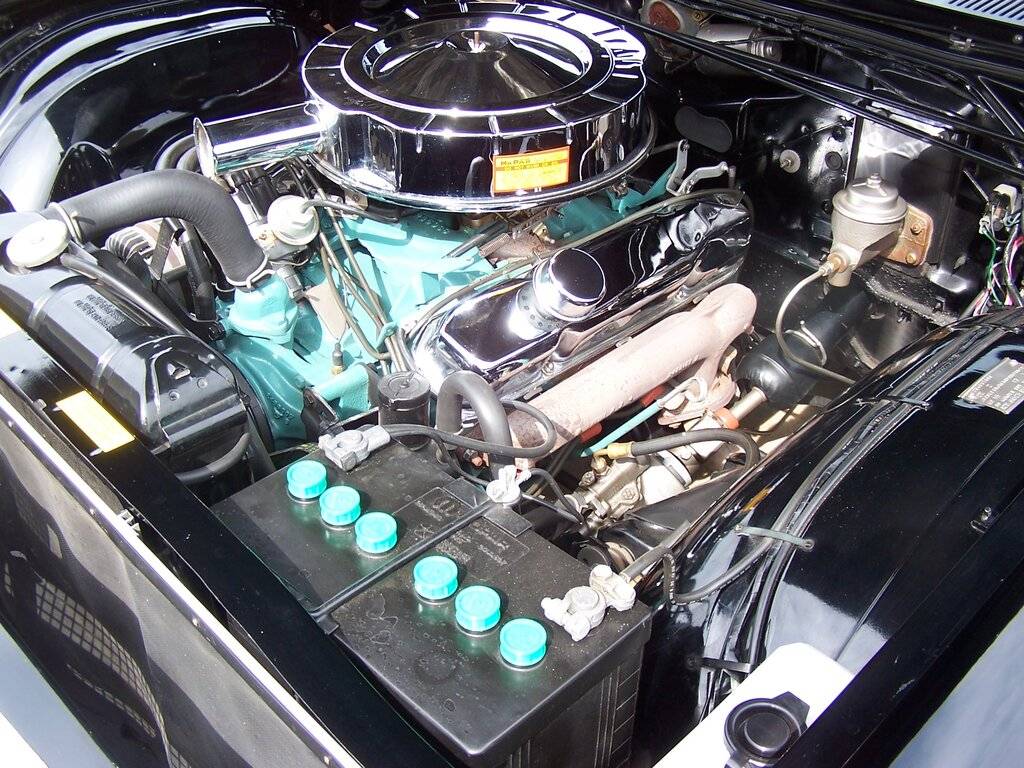

Thanks for your awesome pictures. Previous owner swapped on Eddie intake and the linkage doesn't work like it should. I also have to point out that those engine bays are spotless. Like wow.
