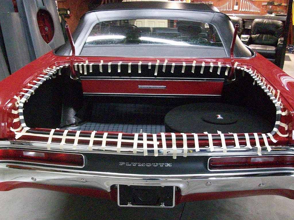

The large, higher wave goes to the outside and maintains contact with the underside of the trunk lid. It's best not to use contact adhesive as it will not allow alignment of the strip after setting in place and don't close the lid to secure the strip as this may cause it to slide. I used high quality silicon and taped it down where necessary for a couple of hours. You do not want compression on the strip until after the adhesive has cured or the strip will try to shrink back to original size and affect the bond. Joining the ends of the strip can be done at the rear of the trunk with crazy glue or whatever you wish.
Oops, I did it wrong, i used trim adhesive and gently closed the trunk, got lucky I guess.Thanks for posting the proper way.
