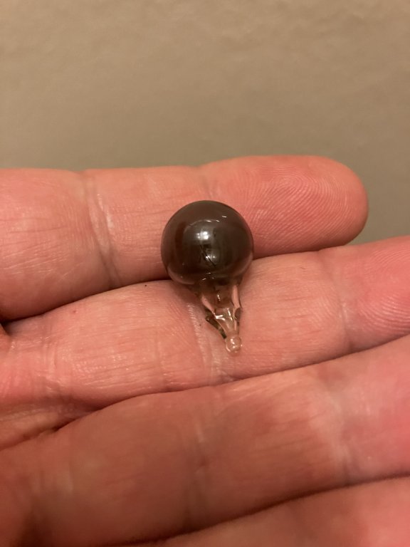

This is the glass part of the bulb itself. It’s smoked looking glass. Anyone know what bulb this is so that I could order one?

It looks like smoked glass because of deposits from the filiment have darkened the glass. The bulb should be clear glass.

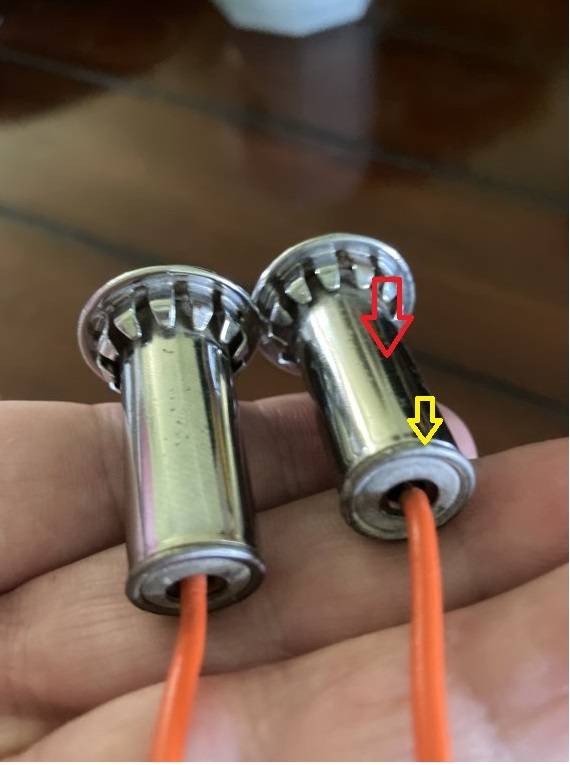

See the red arrow in this pic? Grab that with one hand. Now see the yellow arrow? Grab that with the fingers of your other hand and pull out.
Big John, I thank you so much. Honestly, I feel a little foolish to have not figured that out.
