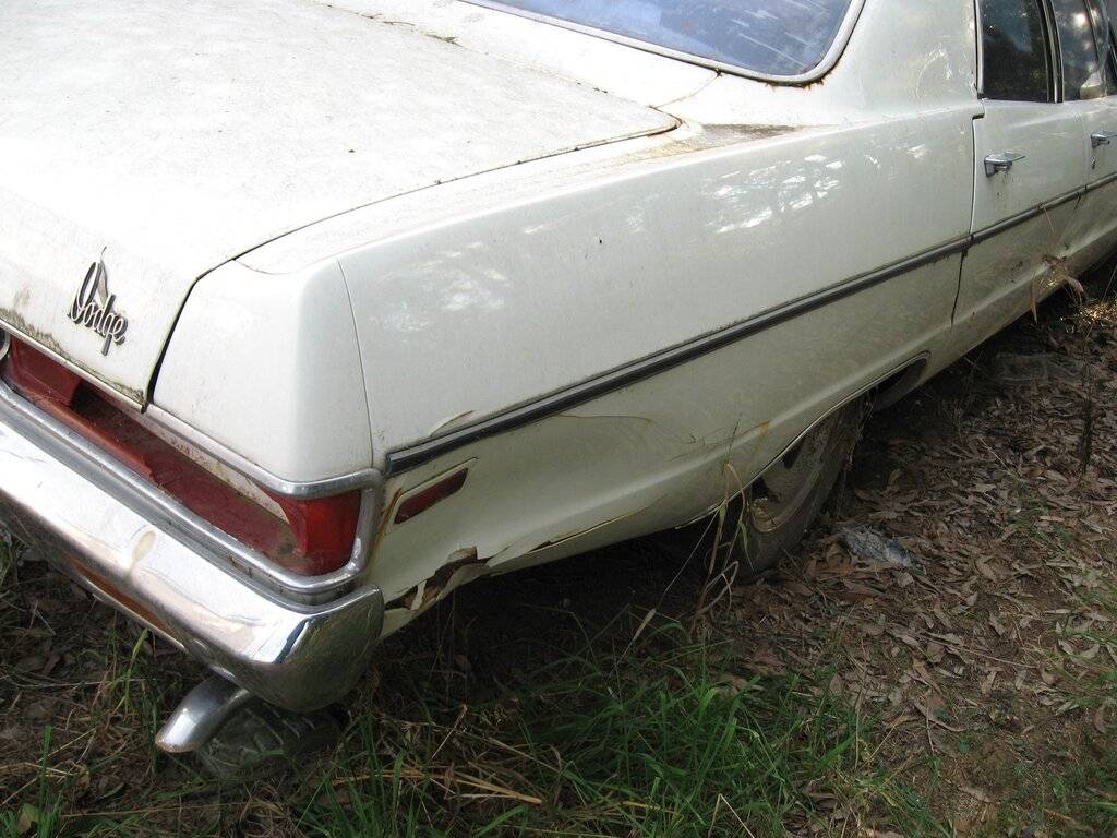

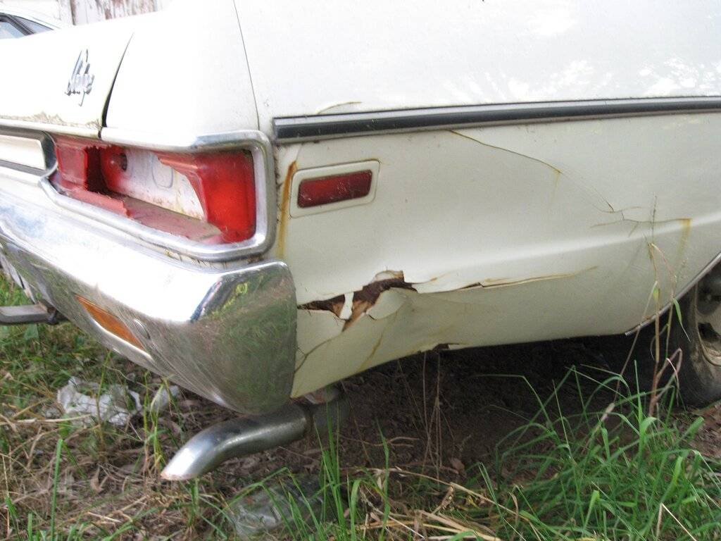

I'm in the Process of re-building a 69 BB Sedan that was "Written off" (Insurance Terminology & Family "Wish" as they felt the Elderly Owner was getting too C-Nile to Drive)
Admittedly the Old Boy was Getting on, But I figure at that Age you may as well Enjoy Something.
( Engine mounts were "Chained" so I figure he WAS Enjoying Himself!)
Now the Car was in Storage for 10 Years, ( He couldn't bear to Part with it & I had to Promise to Do My Very best to Put it Back on the Road before he'd sell to me, Not use it for Parts.)
It took me Four Years to find a Panel Beater who was prepared to spend the time on the Car & then only on Weekends as a Side Job. (It's just too easy for them to make money fixing a Modern car + quick turn over. Our old things take Skill & Patience Not just Bolt off / Bolt On).
Anyway (I tend to Ramble on, Apologies) After 14 yrs of not being used, It is my Intention to have the M/Cyl Sleeved in Stainless Steel & I'm considering having the Booster rebuilt (Not much point in rebuilding the Car only to have the Brakes Fail at a Critical Moment. Nobody wants a Honda Zot as a Bonnet Mascot)
Anyway I have Rambled Enough, But in Future if Possible put in some Pics Please.
(Have included a couple of Pics of the Car. Doesn't look all that Bad But the Body was twisted & needed to be Racked.
Also having the Back Window Rust repaired while he's at it)

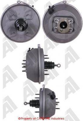

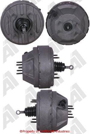

is the 1968 chrysler power brake setup applicable?
While there may be aftermarket boosters that fit and do the job, these as far as I know are what the cars came with from the factory. Please correct me if I'm wrong.
Disc Booster 65-70 Bendix Dual Diaphragm tab-lock style
Drum Booster 65-70 Midland Ross clamp ring style
Disc Booster 70 and up single diaphragm Kelsey Hayes I believe
