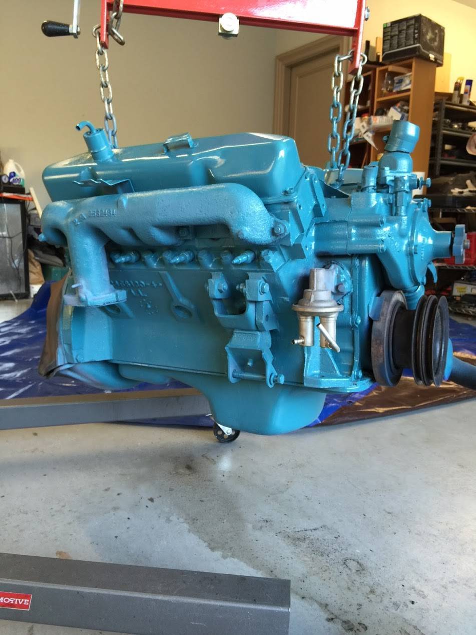

Yes the '66 came with a fender tag. You can look for a build sheet if yours is missing. Post pictures of the casting numbers you found so we can better help you, please.
For example, a 383 will have the casting number 2468130. Is that what you are trying to find out?
engine-6-jpg.70176
3tCtyMBsddzPmj1EMj8bTmFPdY9GtRU6YDAjRkHJVPGXfsmPOj2WkRvCvMmLyOhckLDnQrgo2tu5-zZvdrDQlFYWtTr_11AhJMb_oWuIQDG2HfLk-W0KJphb6UG87Idptce6qDw3lxnIcldS2cDlh_bIjDzZDJ_FMilplJa8I8ppjlJR7yt6sAVSb4Vj3j6lcgxU1-dddmt_hYR0-co06KSllzBoZop8gRPpMfAKhc4oZyNsBPExQuYXbQ4fv3-YlsUuUZGxvScEowczm4Mu4-aF3owFJE5ot_Eks3vz5dVRX3l8DjKLm0Oj_kWVWK_B7WJlAZ0lwvYoXk_Vlg6a2sJGw73aeL-wrzlM_DiR_HQd6S6u_DJ6xAxaoj2-h646-Z-okovzGqYc8DXNV7919ydQOMa6n_XIkL-eCP2H8lh8aV2RZOkw6zTm4Fa8cJz4yvsKtPKD8SPLprIHdMbgIkZ7kIDMlxaVb4rT0Tzg7JR9G_6MMV-jS7-qotJggRSesTZBtICPlmBSPVQ74GNUCvHZ3y_vadQ8jzpZPC0srmjKt3aUOkoqVsqgwCWqKlgQdiA-4LfAHsH7m7kSkrWL86pgm0PILxw=w1827-h1370-no
The second casting here is the build date.
Mine has the exact same casting number. Didn't see the build date below it so I'll have to check it out when I'm home.

[QUOTE="The Horvaths,
engine-6-jpg.70176
QUOTE]
Nicely detailed, painted manifolds and oil filter, just like OEM.

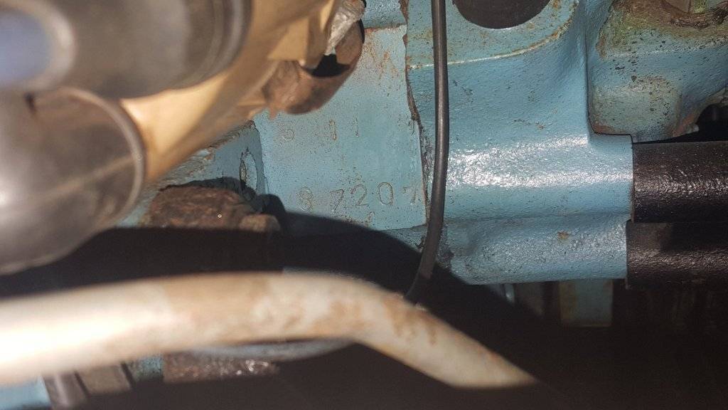

This is the number I found that sits under the dizzy.
The 5 digits match the last 5 of the VIN.
also my casting number matches yours, 2468130-4.
unfortunately the headers block the build date. ill have to get under the car to get a better look sometime.
however, im still trying to locate the engine number for registration purposes. i cant use the casting number obviously as its not unique to this block, unlike an engine number
Those are not typical factory stampings. It appears as if someone has stamped them on the block.

I don't know what to tell you other than what has already been posted.
Chrysler did not stamp a VIN on an engine until '68.
When they did stamp the VIN in '68 it was on the back of the block near the oil sending unit.
In 69, they moved the VIN stamping to a pad on the passenger's side of the block near the front.
Those are not factory stamps. Someone has put them there after the car left the factory.

little update, i spent some time and searched the block and found under the dizzy B383 3 11 (then it has 87207 under)
i assume that means 1966 383 11th of march casting date?
is there any other numbers on the block that are unique to that block?
sorry if these questions are dumb, never owned an old car before.
also someone mentioned a build sheet earlier? how would i obtain one?
The build sheet will be found somewhere in your car if it exists at all. Usually under the rear seat springs, front seats, under the carpet etc..
3 11 is the engine assembly date.

To the best of my recollection, the most accurate thing that you find for an engine identification for a '66 is the stamp under the distributor. If you clear away the paint/build-up on the pad you will find numbers like "B 383" or "B 440". The "B" denotes the year 1966. What comes after is more obvious!
