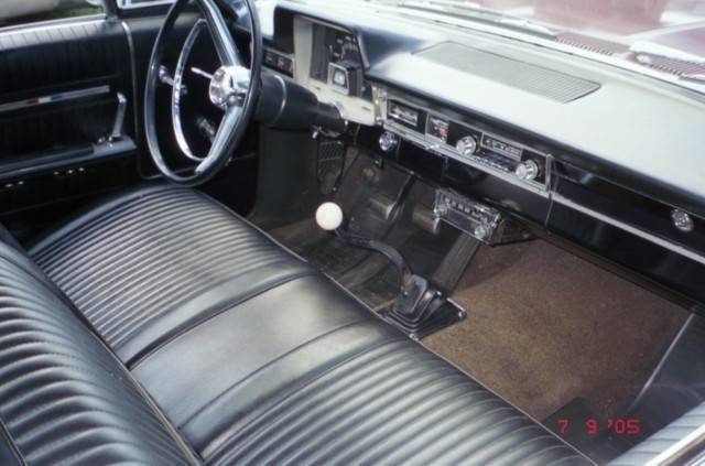

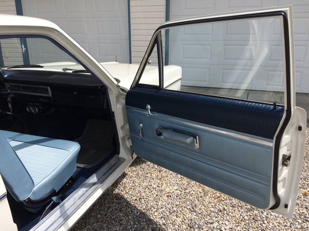

Correct in saying 2 dr sedan door panels are unique as they are cut to fit around the door frame. 65 and 66 had different style door handles and arm rests as in pics below, otherwise the size and shape of the door panels should be the same for post cars in both years. I highly doubt 67 and 68 would adapt but can't say for sure.
65 note the arm rests and handles
door handles and arm rests changed in 66 and up models
