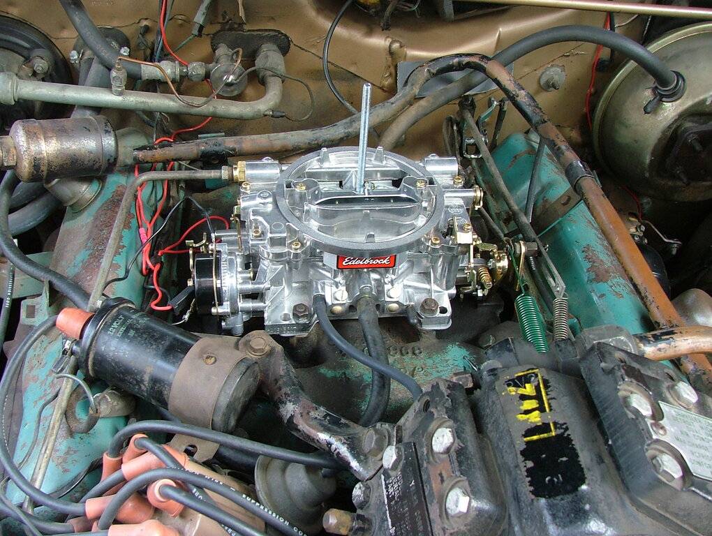

On Saturday I pulled the Edelbrock off to check it out. I had been having symptoms of it running over-rich and blowing sooty water out the tailpipe. This is a 1406 600 cfm unit that I bought new on Ebay in a Spanish printed box and I just bolted it on out of the box. I pulled the top off and checked the float levels which were a little off, I also noted some dirt in the float bowls which I cleaned up. It ran better when I reinstalled and now I will get a new filter on there.

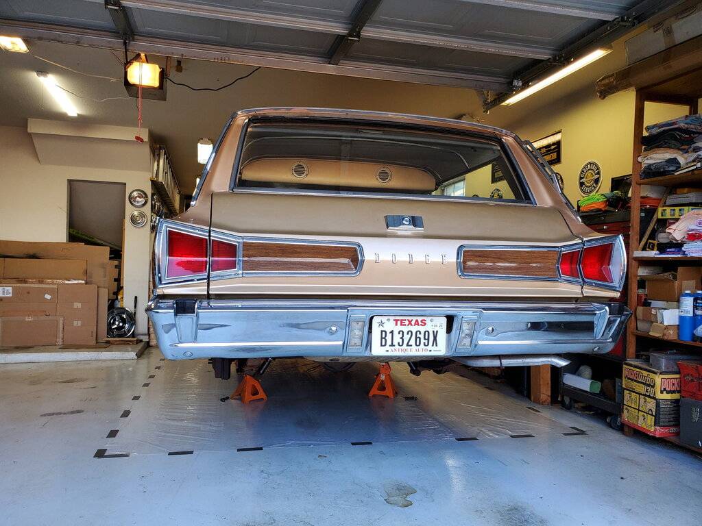

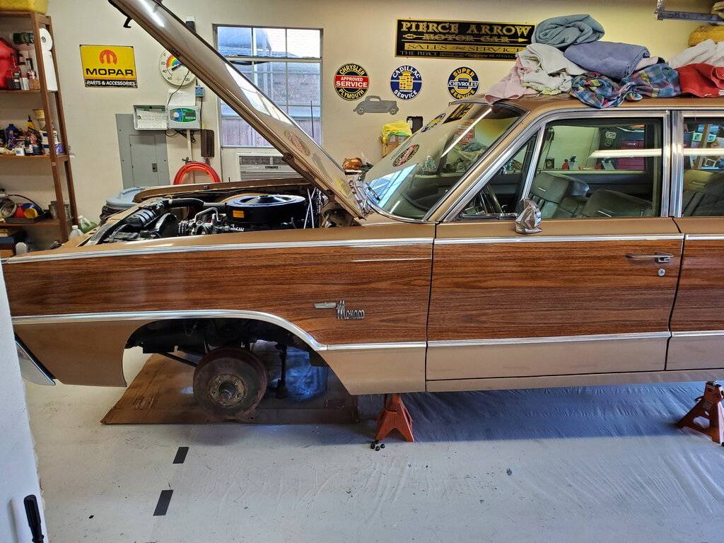

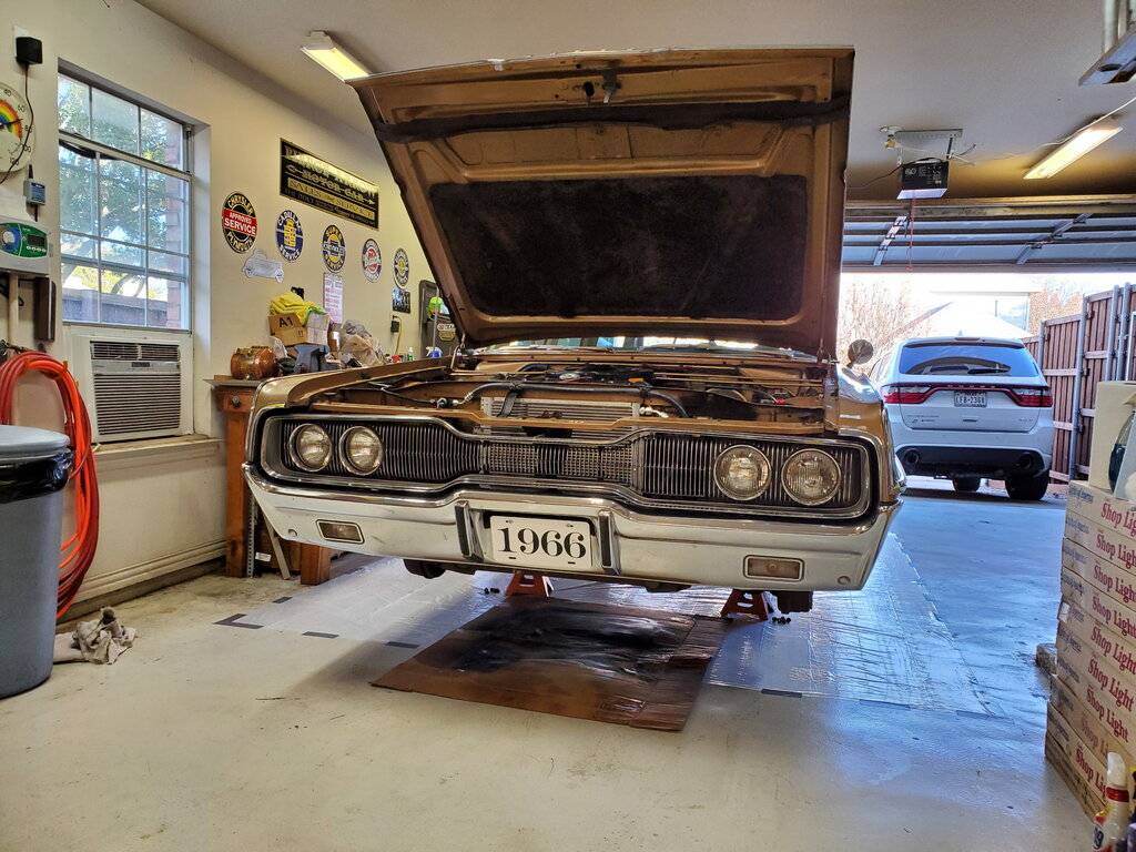

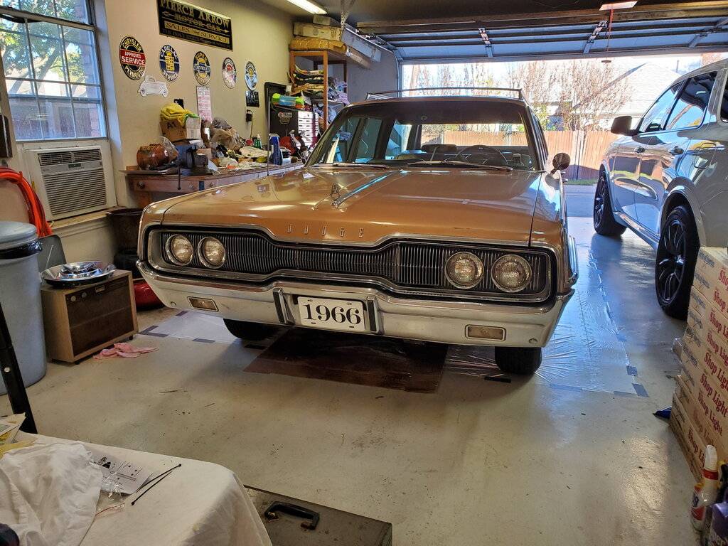

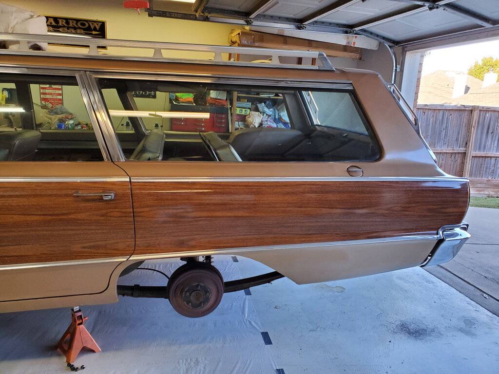

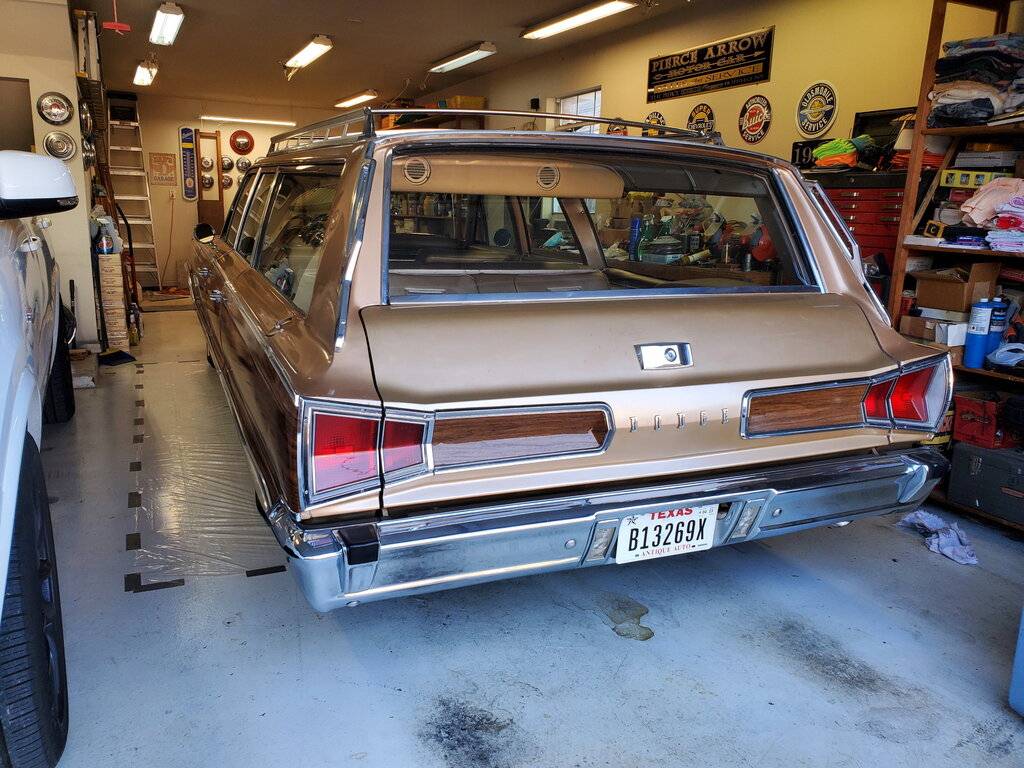

After far too much time and too many excuses I am finally working on the brakes for this car. I cleared space in the garage, put down some 2 mil plastic sheeting and got the car up on stands yesterday. I have all the new parts and will start disassembly today.

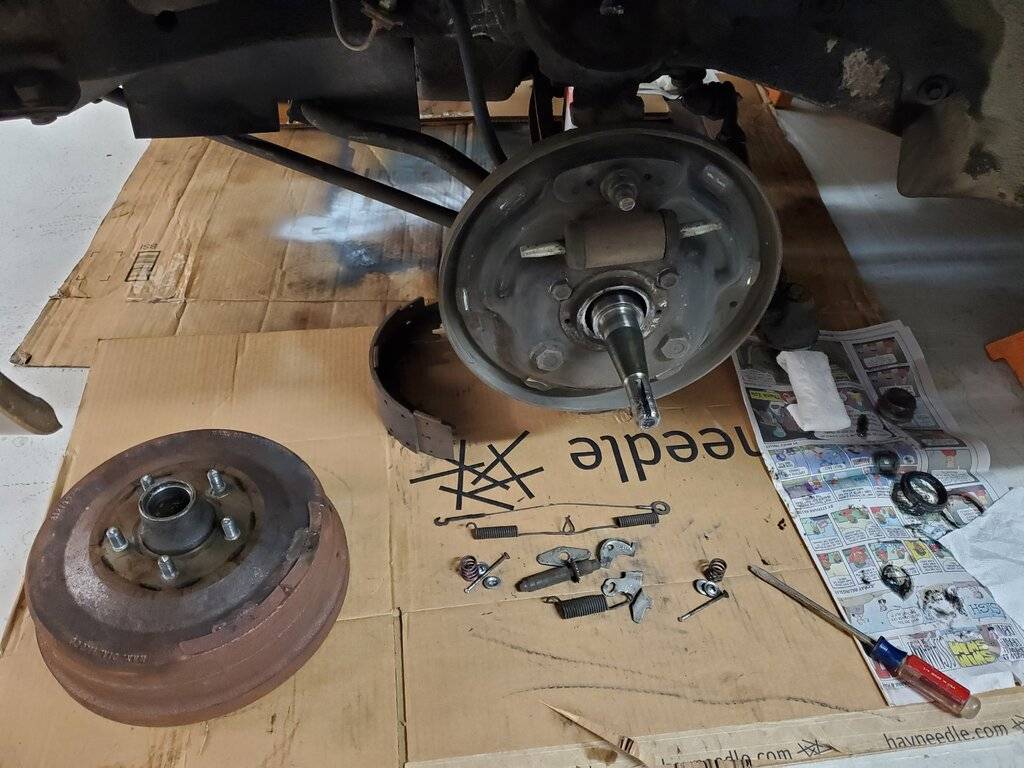

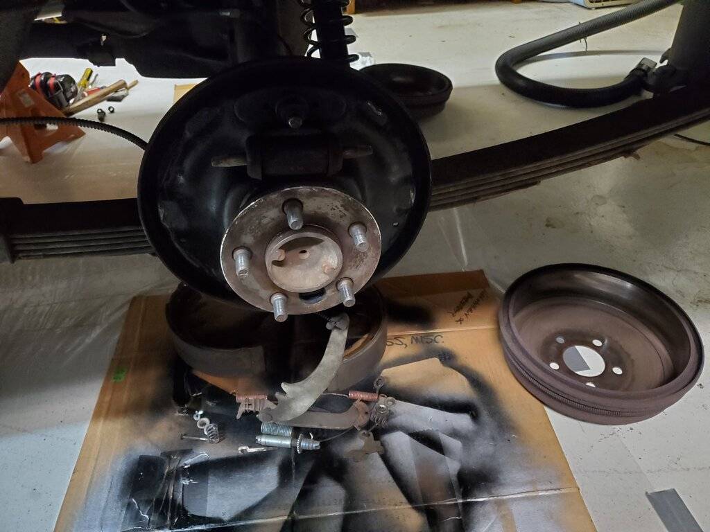

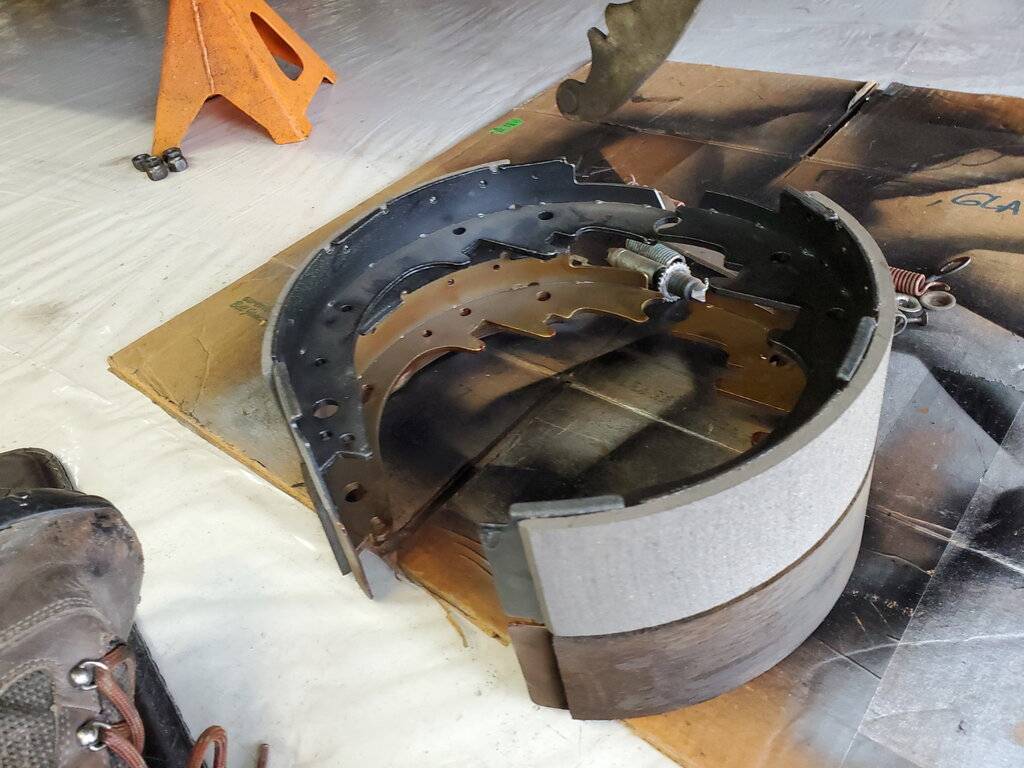

Today I disassembled the brakes on all four wheels, cleaned and vacuumed all the brake dust, and cleaned the wheel bearings in gasoline. The bearings and races all looked fine. I cleaned an enormous amount of grease out of the hubs in preparation for getting the drums cut, tomorrow I'm talking to the manager of a nearby O'Reilly's who still knows how to do drums without taking too much off. I decided I'm going to replace the front hoses even though they look ok. Tomorrow I will check all my new parts against the old ones to be sure all is correct then I will start taking the hydraulics apart.

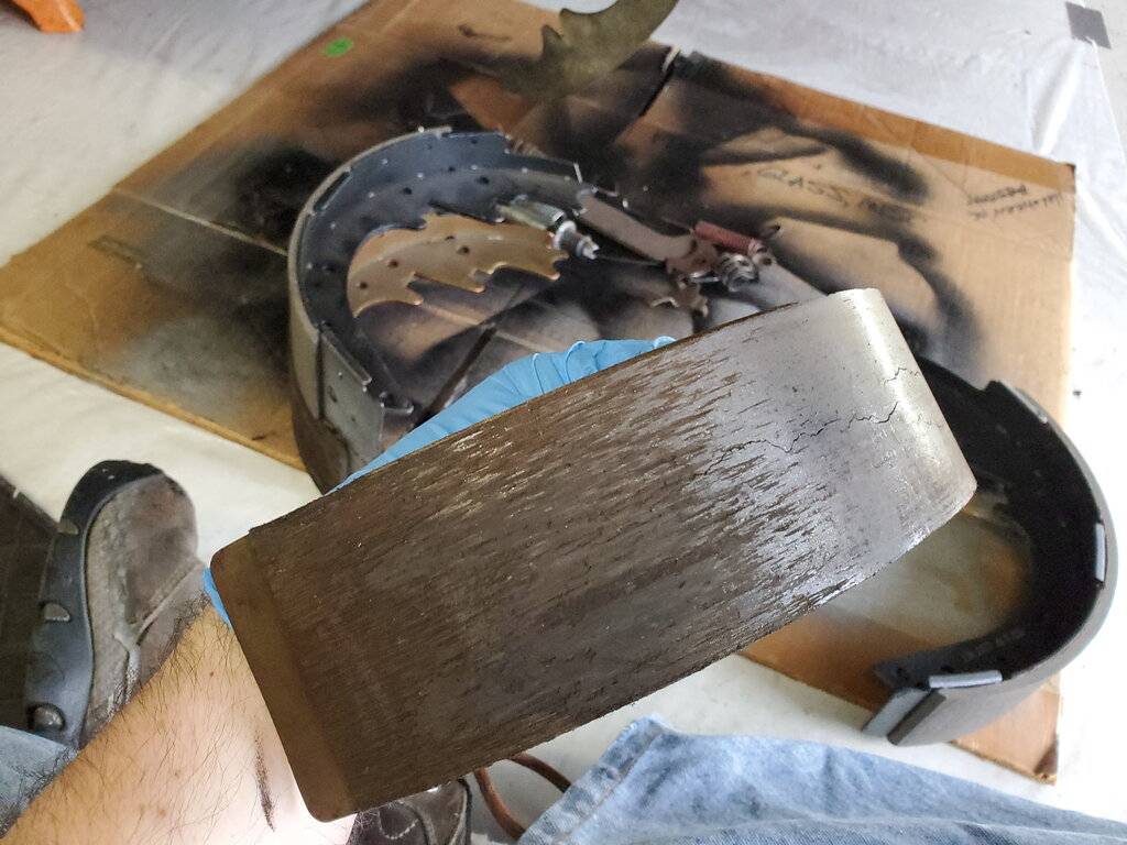

Parking brake shoes done with a brake shoe arcing machine. Watch this video to see how it's done. The guy talks a lot (and some of what you see is of no value), but you can see that he knows exactly what to do and is very good at telling people like you and me how to do it.
Check around your neighbourhood and see who's got a brake arcing machine. If they been in business a long time they likely have one. One place I would start to look are places that service larger trucks and not cars. Most large-scale truck still run drum brakes.

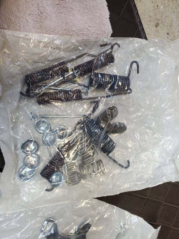

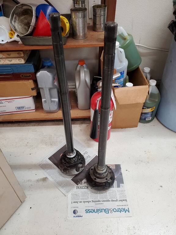

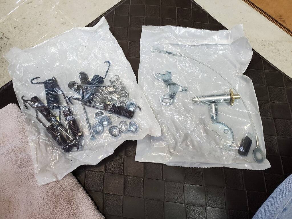

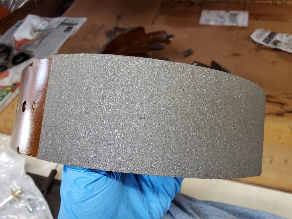

I compared the new parts to the old and all looks good, the linings appear to have quite a bit of metal in them. As always the job has become more complicated as all of the old rear linings show signs of axle seal leaks. I pulled both axles and will repack the bearings and replace the seals, this is covered more in another thread:
Rear Axle Bearing Noise | For C Bodies Only Classic Mopar Forum
Some will say that high metallic content will chew up drums and rotors more quickly, and some even claim they can feel the difference.
I would tend to think the wear issue is not of great concern unless your car is a daily driver. Collector cars getting driven less than 5000 miles a year will have brakes that will still last for years and years.
The feel thing? I dunno...
Not concerned about the wear issue, we will see about the feel.
You can also see that the wear patterns on the old shoe in the pictue you posted are not even, indicating they weren't arced originally...
