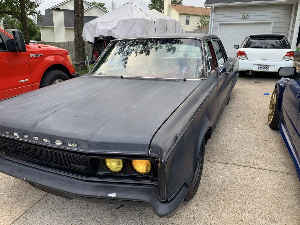

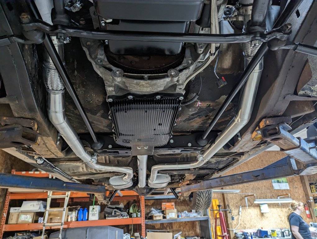

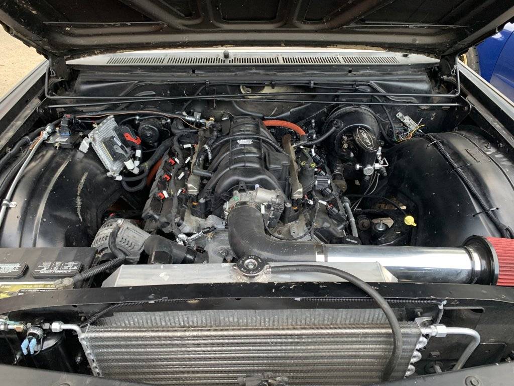

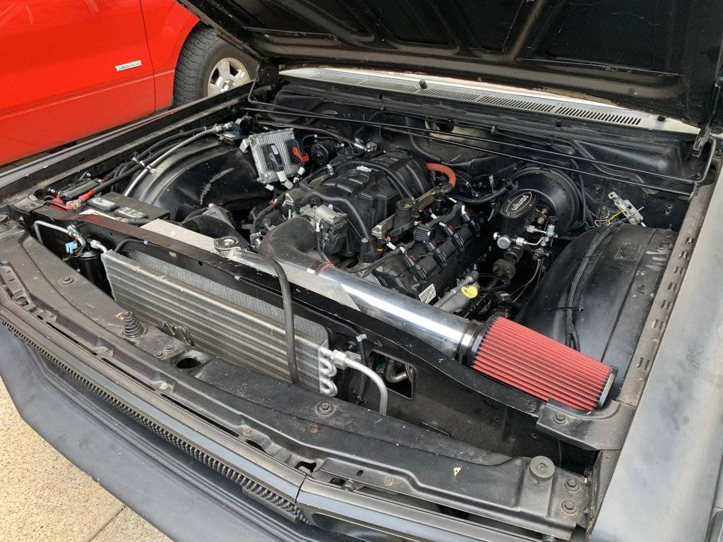

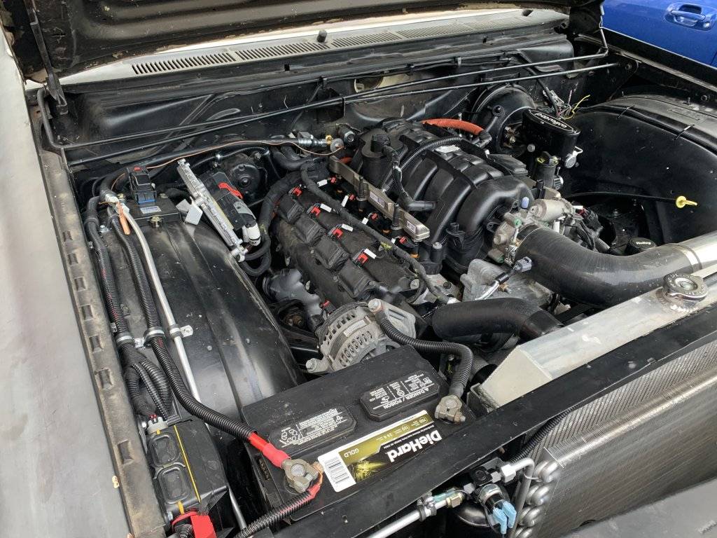

I’ve been browsing the forums for a few years. We just finished up with the 5.7 swap and 8 speed auto on my wife’s car. This post is meant to be informative as possible as no one has really done this yet.
It started with a pullout engine and transmission from a 2017 challenger with 35k miles. It also came with the pedal, engine harness, fuse box, and shifter.

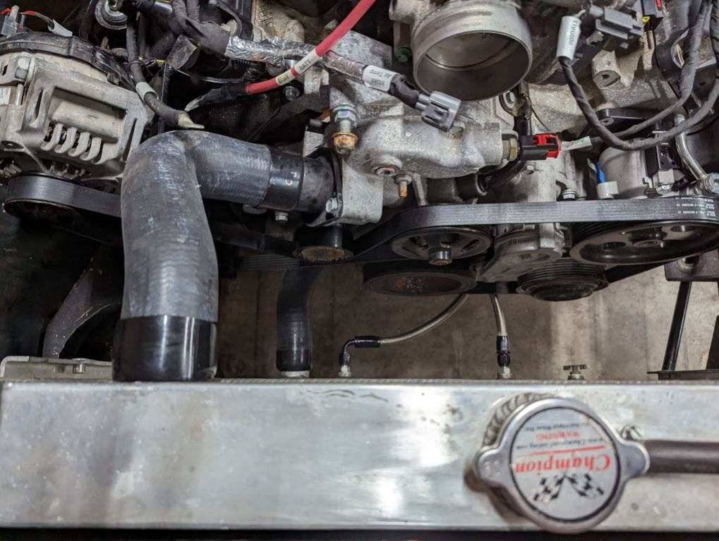

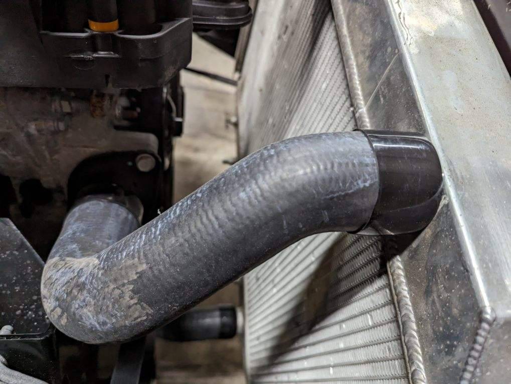

Installation looks good! How did you interface the radiator to the thermostat housing? Which hoses and such? I suspect the computer is running the transmission?

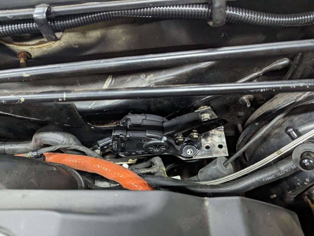

-Wiper motor. There isn’t one installed. How do I know if it’s a 2 speed or 3 speed that came on the car.

Yes the installation is great my good buddy installed everything and has an eye for detail.
I have those hose P/Ns somewhere I can get that
Yes the transmission is controlled with a TCU.

Would love to hear more about the engine and trans electronics.
Sound German automotive?

No cooling fan (s)?
Mopar crate ECU, Mopar Crate Harness modified significantly, BMW TCU from PowerTrain Control Solutions with a very modified TCU harness from them(they have revised the harness and now comes much closer to what we ended up with).
We were the first TCU from that company. They have since then did some revisions.
