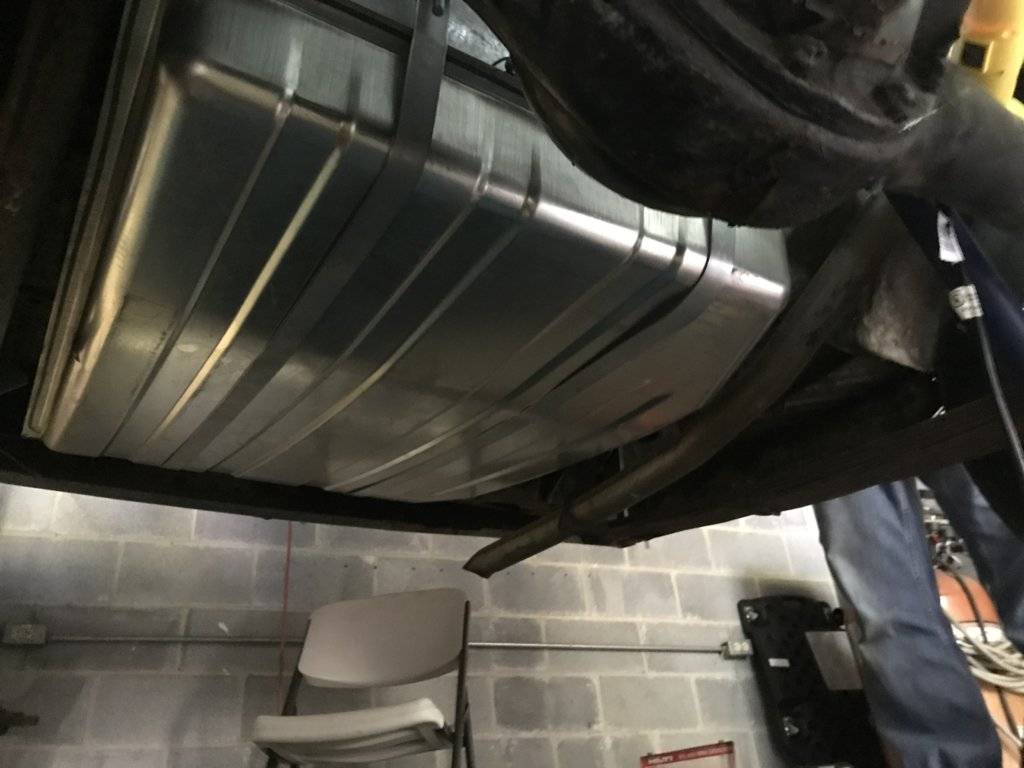

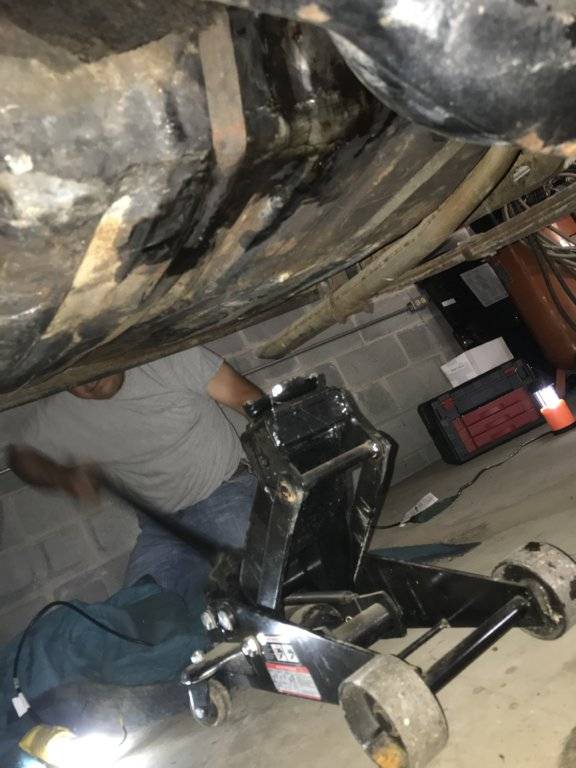

Finally shifting from dismantling the parts car to working on the Vert! As some of you know, I parked my car in the rental garage up the street and when researching why I wasn't getting fuel to the filter (leaving me with a car that wont start!!!) I came across several leaks in the old tank in the area of the vents and the sending unit when I put it on the jack stands.
So I got up at 6 am and started gathering the parts for the new tank and misc. tools and up the street I went...….
So we got the old tank out no problem. But then we realized the PO decided to delete the front and back vent lines and also the filler neck strap was not bolted in.
So while my buddy that screwed up and volunteered to help started installing the sending unit, I ran back to the parts car parked in my yard and removed the parts we needed to do it right:thumbsup::thumbsup::thumbsup:. Man that worked out pretty good!

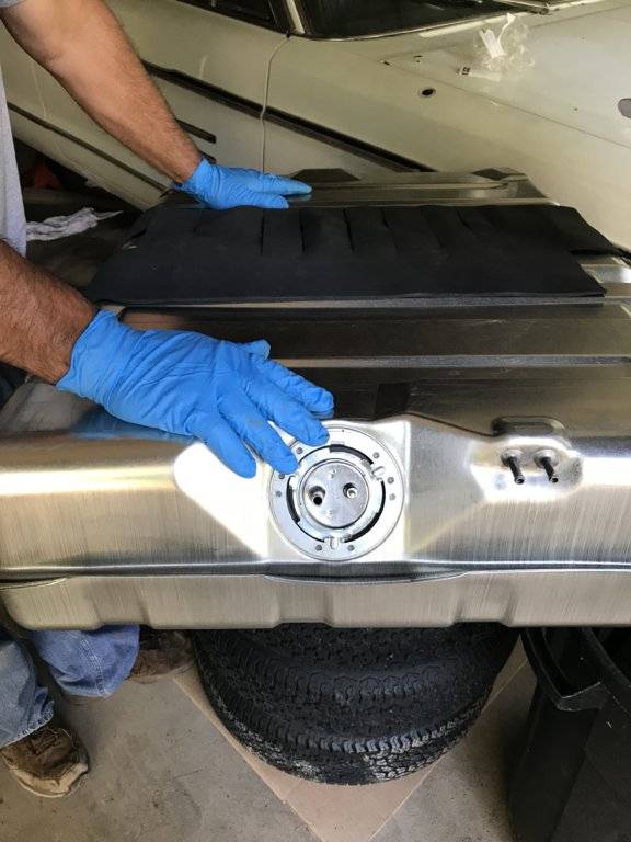

The other issue we ran into was when we added the new rubber gasket to the sending unit and installed the lock ring, it had too much play making it too loose. So we did a little field engineering and stacked the new rubber gasket on top of the old gasket and it looks like the lock ring is applying enough pressure to seal? I'll keep everyone posted on how that works out over the next few days.
We got everything back together and added about 6 gallons of fuel. No Leaks Yet!! I'm not sure if that's enough to get everything going so I'm off to get another ten gallons of fuel since we still aren't getting fuel to the filter?

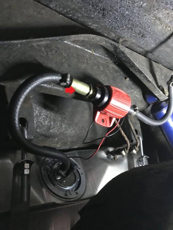

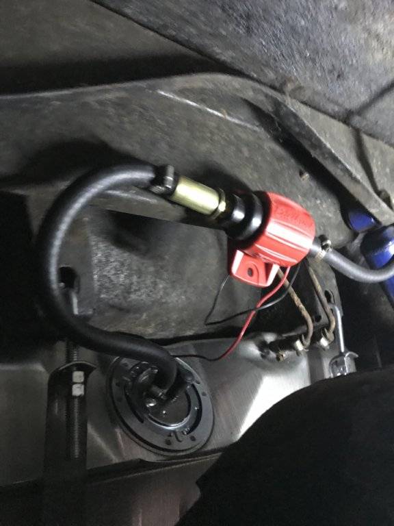

And I think maybe I figured out my problem. That right there is the in line fuel filter for the electric fuel pump. I'm gonna bet money the junk from the bottom of the old tank has it clogged?
Well the new fuel pump arrived last week just about the time I began suffering from the hacking, coughing, sneezing bug one of the grandbabies brought me. So I finally couldn't wait any longer and headed up to the garage today and swapped it out. Turns out it was just what we needed and she's running again!!!!!

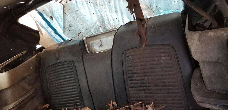

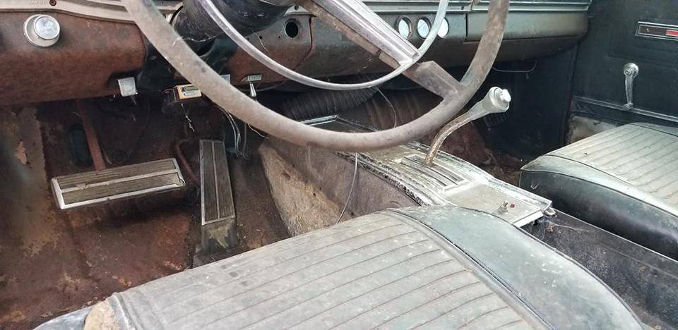

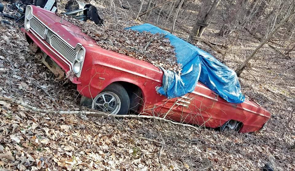

Like this one not too far from me! She wants 2K and from the pics there isn't much salvageable left on it?
Well clearly it's been setting in the weather for a long time. Not to mention holes cut in the dash for gauges, etc. Probably rode hard and put up wet but I'm gonna make another run at her and see if I can get my hands on it!

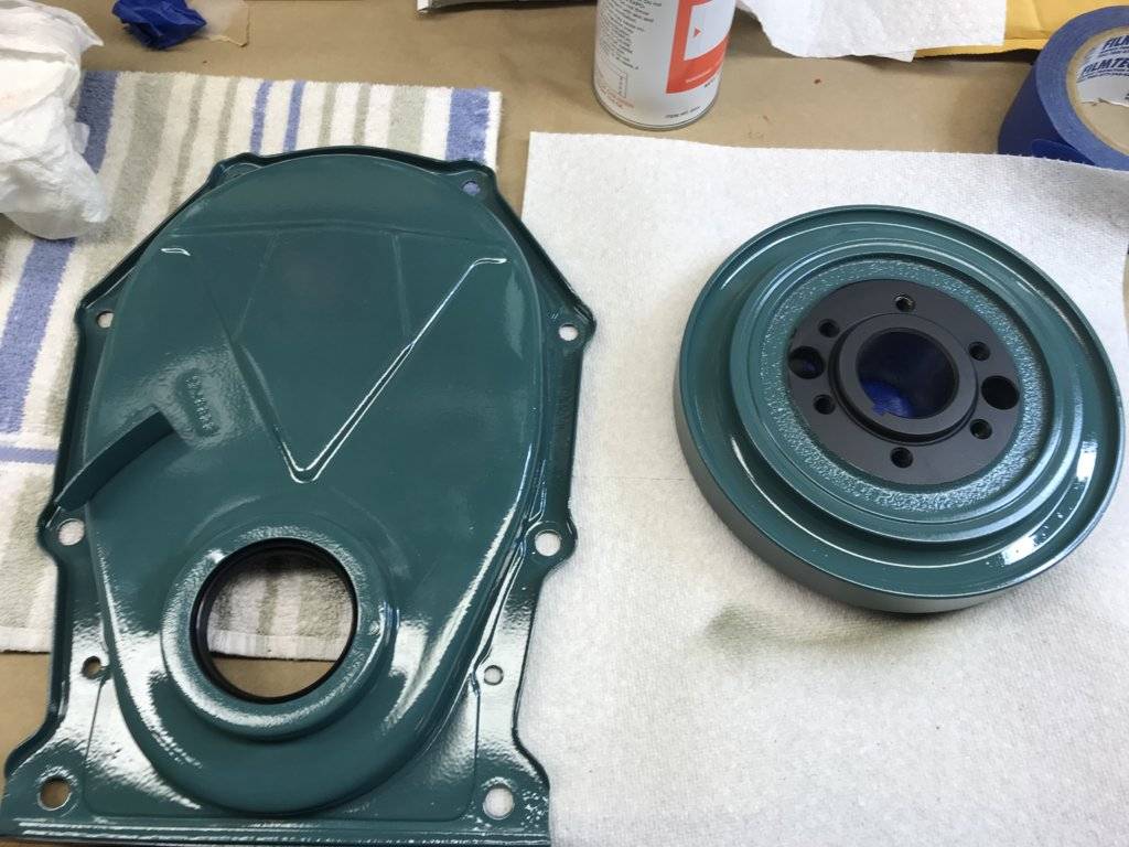

Broke out the hi temp etching primer and the turquoise paint and we now have the harmonic balancer ready to go. I'll give it overnite for the paint to set up before we start installing.

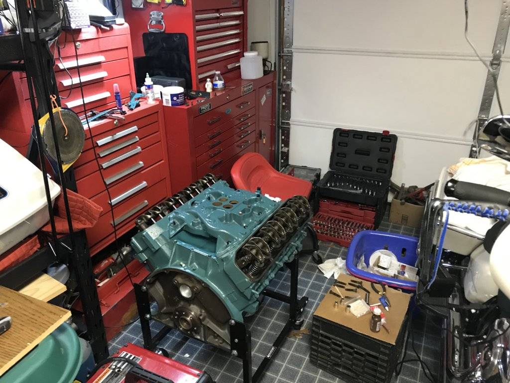

Hunting season is winding down so I spent the day yesterday rearraigning the bike shop so I could begin concentrating on the car again.

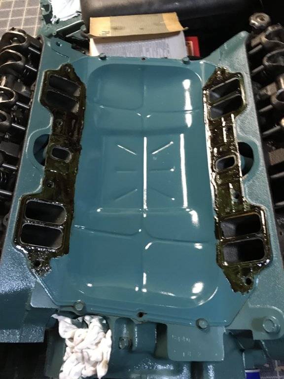

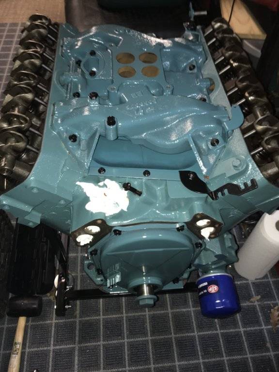

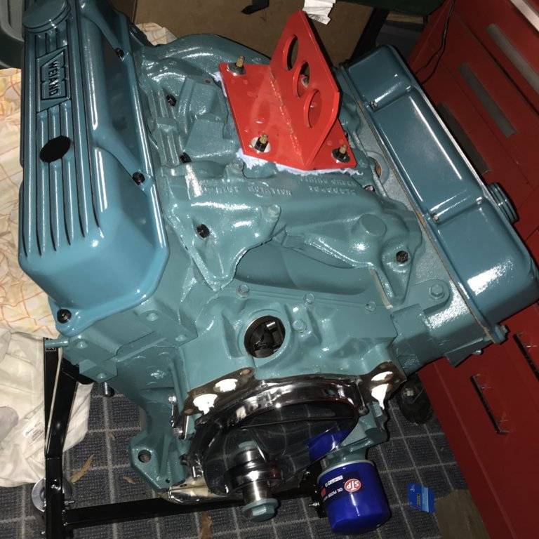

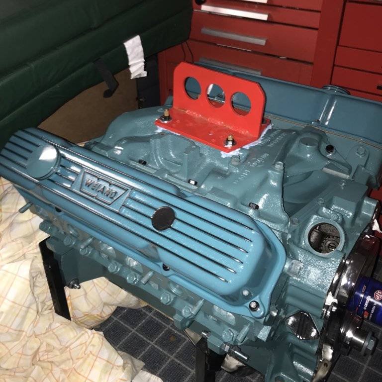

Got up today and started trying to finish off the 440. Here's a few shots of my progress....
Installed the valley pan, intake, valve covers, water pump housing, brackets for kickdown linkage & plug wires and did a mockup of the harmonic balancer, dizzy and carb just to see what it's all gonna look like. Most of the bolts are new ARP's and the majority of this stuff was powder coated by Leanna.
Carburetor and dizzy shown for effect only!
I'll be back at it after work tomorrow evening.....
