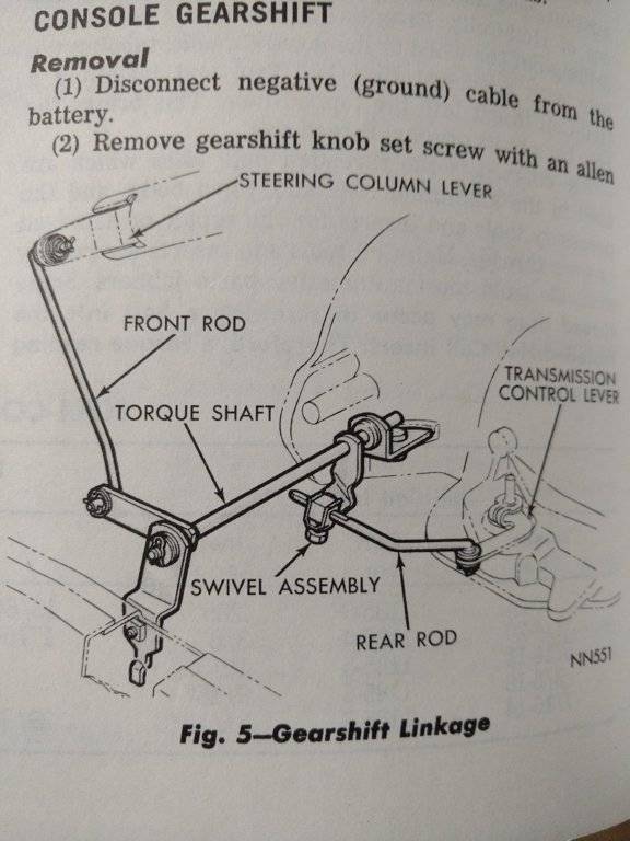

Factory service manual is your friend.

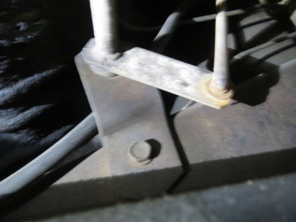

i cant find a better pic yet still lookin
across from that loop is a spot on the frame where the other side bolts to the framerail.

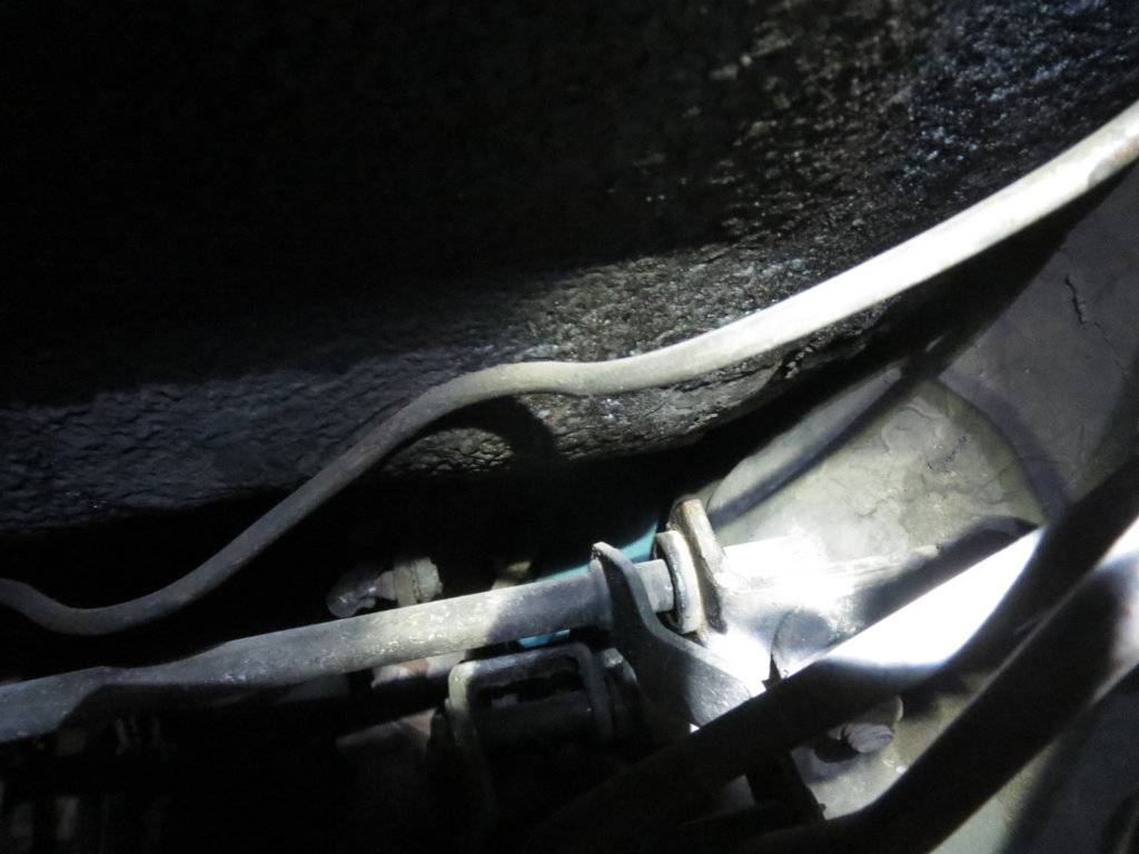

Matt i saw that pic somewhere else. But my torque shaft is below the trans mounting boss. Is pic a small block?
It doesn’t specify in the manual. I’ll have a look at my Imp right now.
Mine is on the topside of the mounting boss just like the pic in the manual.
