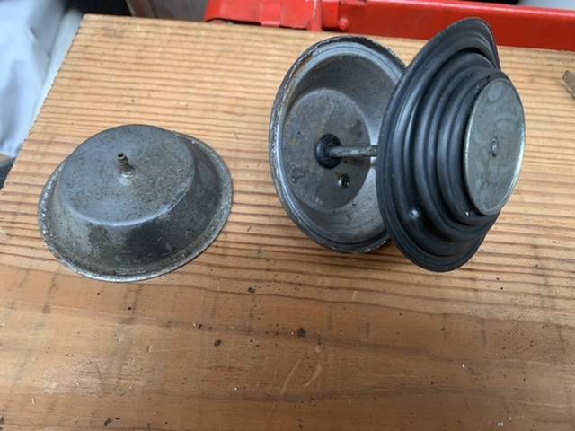

I just wanted to update so everyone has the info. Another item I just dissected and repaired was one of the vacuum actuators. The diaphragm had a tear so I siliconed it. I now have defrosters!
