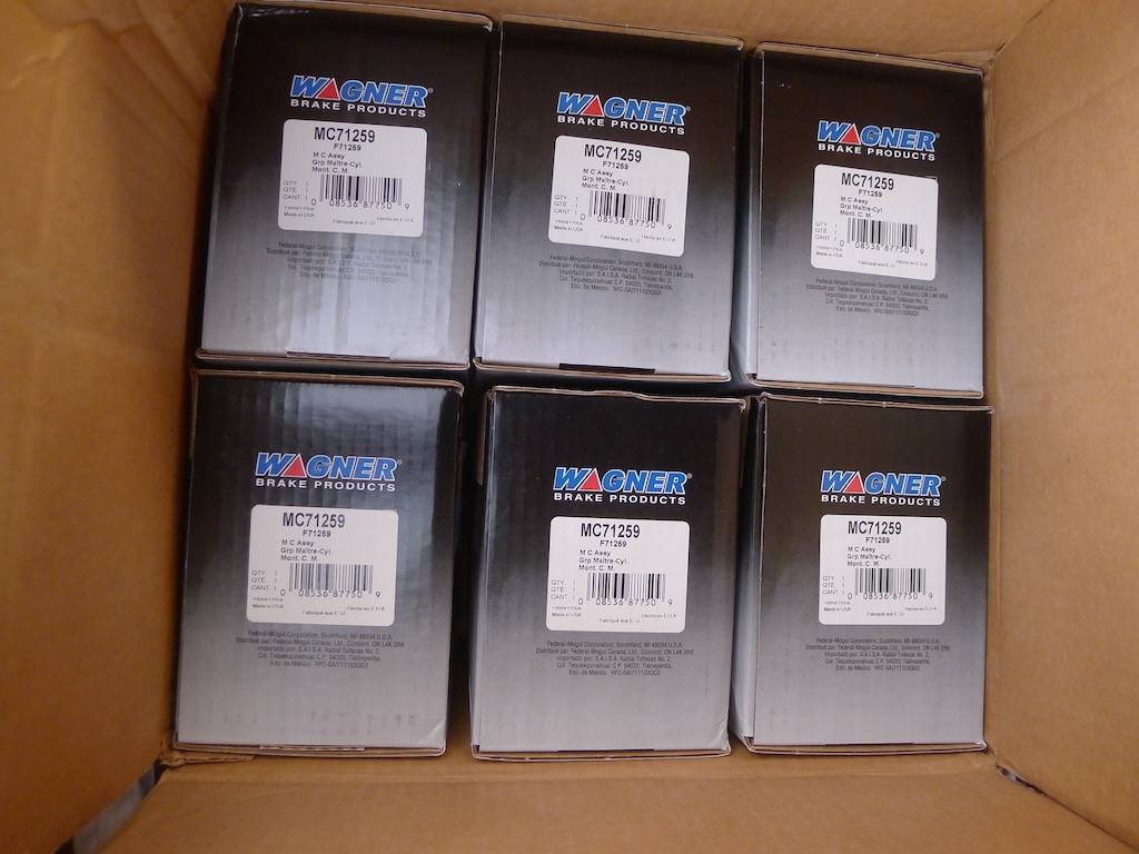

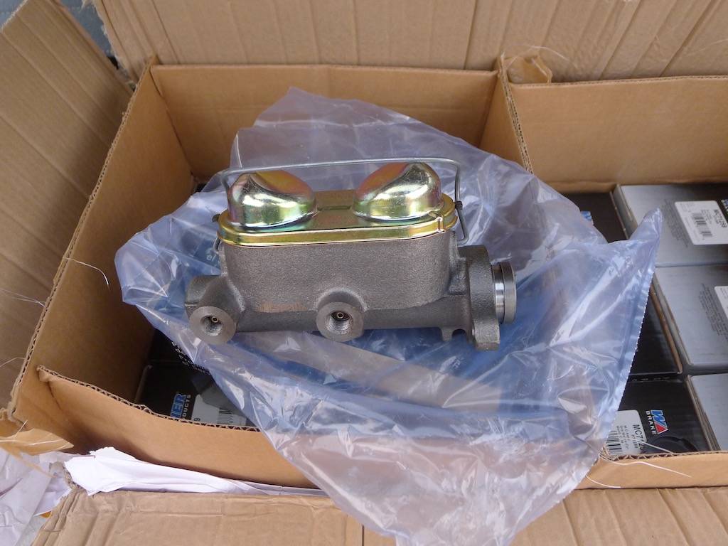

I ended up w 2 cases of 1968-69 Wagner dual master cylinders a while back. I should peddle a few but too much of a hoarder.
View attachment 559523View attachment 559524
Spiffy looking MCs! These appear to have an all drum setup too, by the lids. I'm happy w my Bendix clone, BUT, these look promising. If you think you can endure parting w part of your treasure sometime, let me know. Mind you, I UNDERSTAND the Joy of Hoarding!

Ahhh, the joy of hoarding, of "being owned" by your endless possessions...
I think I forgot I even had those for the last couple years, as they became buried by other acquisitions, and then mice moved into that - tough year for rodents - and I cleaned up, six trips to the dump later, I can see things again, like there's more things that need to go to the dump.
Application was 1969 Dodge D200 with drums all the way around, as a disc brake was something rather exotic back then, although the truck has a front sway bar, power front disc brakes wouldn't become standard equipment on American cars/trucks til the 70's, maybe the mid 70's on pickups.
I could see parting with a couple. I'll probably never need all 12 of these ;]
Brand new - not reman - Wagner, virgins.
