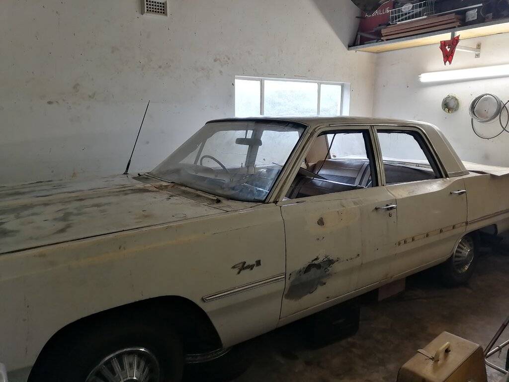

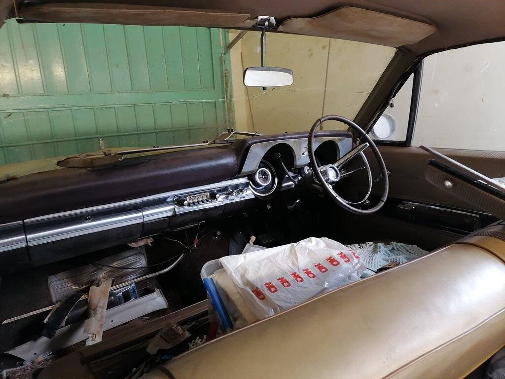

Gents excuse me if am posting in wrong section as am new to this, I reside in South Africa and am in need of some vital spares as if these can't be found then it's no use to even star restoration.
I have sent many emails to various people and don't receive any response from them, I'm trying to locate a front windshield for a 67 Plymouth fury 2, 4 door as well the rubber for both front and rear, inner and outer "cats" whiskers".
If windshield isn't available is there perhaps a universal that would fit?
From my research this is the only 67 Plymouth fury 2 in South Africa hence zero spares.
Its a factory RHD but I dou t that's an issue as the Fury 1,2 and 3 were the exact same body frame etc just different engines?
Windshield #640 fits 4dr sedan and station wagons. They are available you just have to do more networking.
Content / Tech Articles / Windshield Part Numbers - C-Body DryDock
The cat whiskers for 4 door C bodies are available through Restoration Specialties, Dante's Auto parts, or Van's.
Hope this helps.
Btw, RHD C bodies are rare nowadays. Partially assembled in Windsor Ontario Canada, shipped out and the RHD particulars were assembled in South Africa---similar process as the Aussie C bodies of that era.
Please post pics of your car and keep us posted on its progress!!
