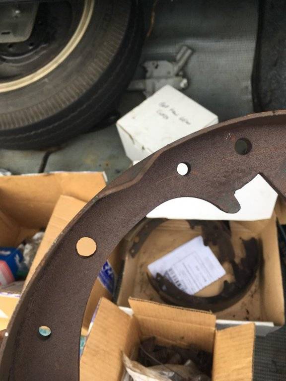

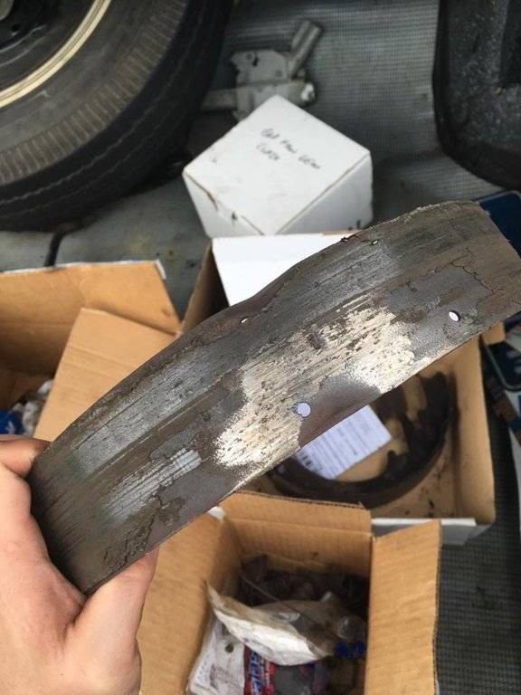

I should've asked them. They did leave the old parts in the trunk. These shoes...holy crap.
But hey, she's home and she stops! That's enough to make me happy for now.
