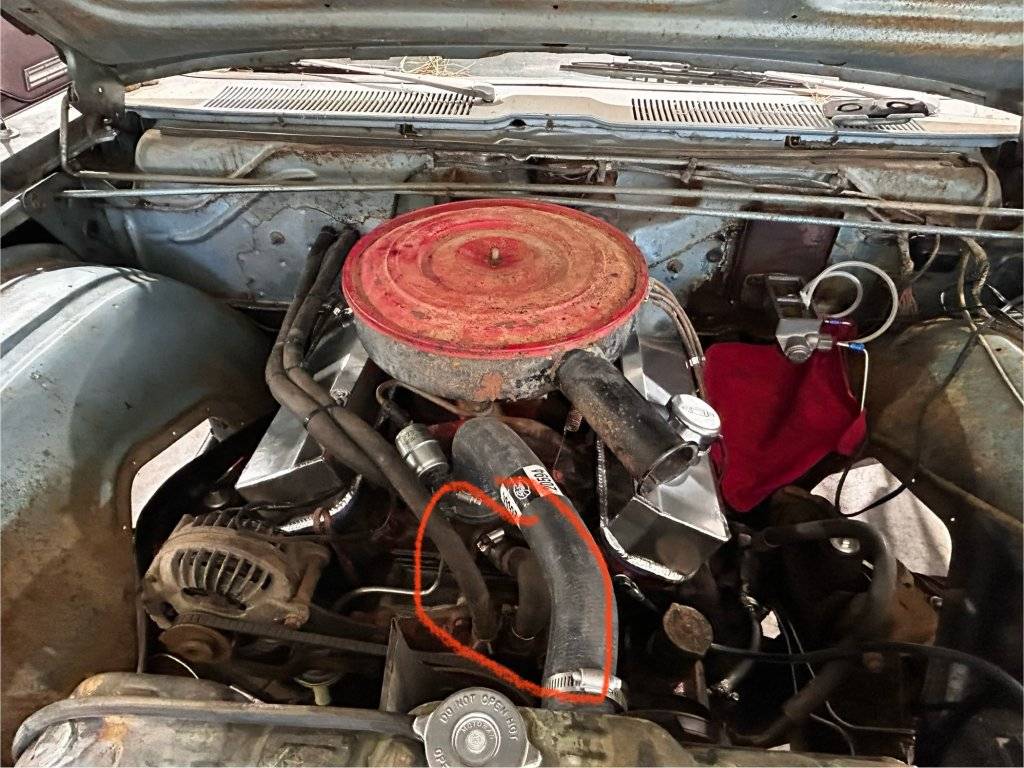

I am in the middle of replacing the water pump in Elwood, a 68 Plymouth Fury II 4 door sedan and I am wondering about the hose that goes from the water pump to intake manifold at the base of the thermostat housing.
Circled in the engine bay picture, below.

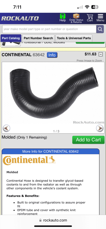

I found Continental part number 63642 and it appears to be correct.
Has anyone tried? Have I got it right?
I think that is the correct hose.
Some are "cut to fit" as they are used in a GM application too, but this doesn't look as long as those. Still might have to trim it.
You may want to double check the diameter as I have seen some incorrect listings, albeit years ago.
I didn’t see anything about diameter. It’s ordered and I will report back upon receipt and inspection.

The hose that is in there is ok, except on the ends, where gorilla tightening, bolt and hose clamp breaking me has over tightened the hose clamps to gouge the hose ends, beautifully, I might add. ;^)
