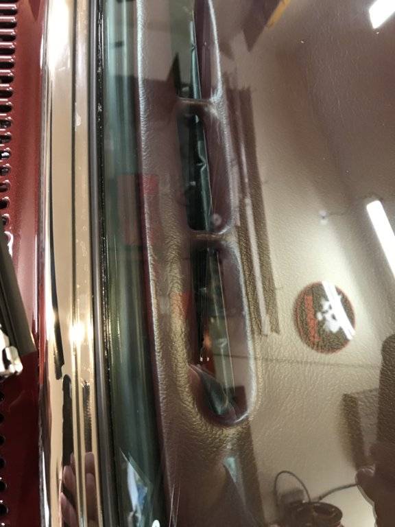

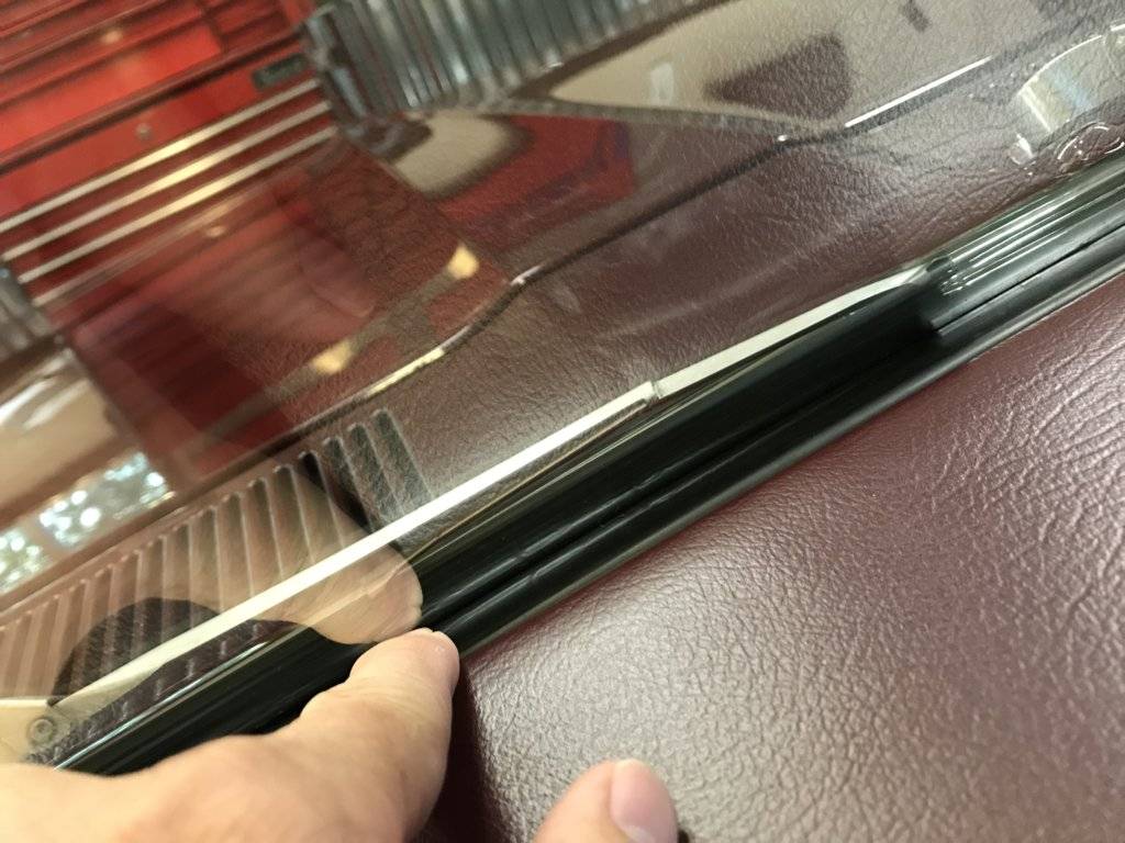

Do you have pictures of where the bolts are at?
Under the windshield seal. You have to lift the rubber seal up.

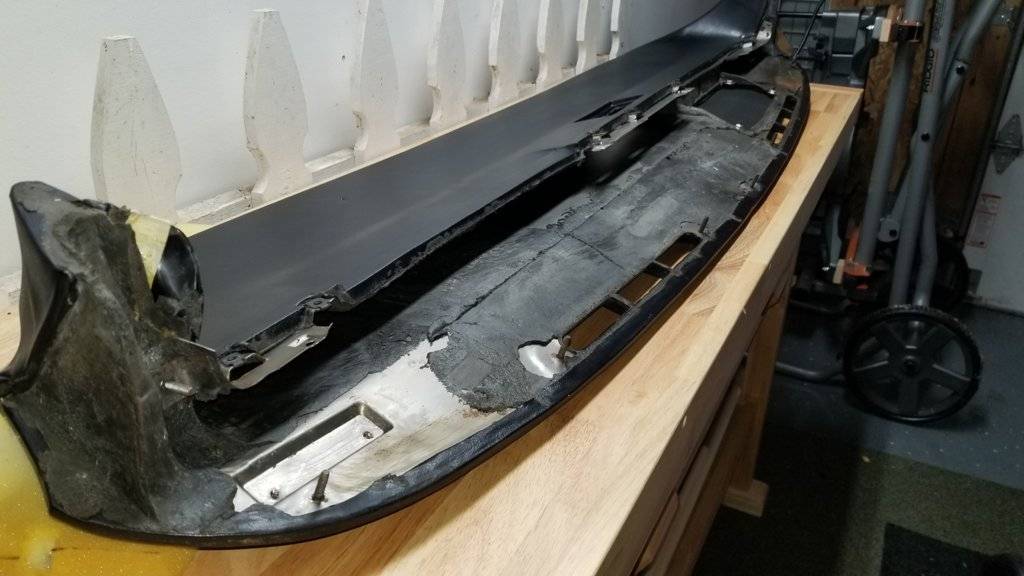

I sure appreciate the quick responses and all the great feedback. I will share where I ended up. The enclosed pic shows the stud locations on the bottom of the dash pad if anyone is interested.
