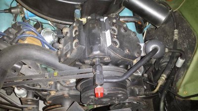

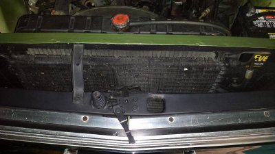

First, we need two things.
1. Was this car factory air, and...
2. We need a pic of your present compressor and condensor.

Easiest would be to replace the RV2. I recall rockauto sells rebuilds, and you see on ebay. But, I would lose that beast and change to a Sanden. You can find bracket kits at Bouchillon Performance and others for BB & RB engines. You can swap the rear head of the Sanden to get the ports you need ($20 ebay) or figure how to plumb to your tubes or hoses.

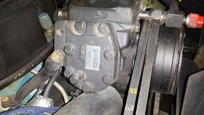

Yes these old compressors are quite a shaky and taxing burden on the whole driving experience. But on the freeway you barely notice it. I would like to keep the original style compressor if feasible, but a lot of folks have told me the one on this car is an undercut piece of junk. Here is the current setup. And yes the car has always been an a/c car. 20150511_214941.jpg20150511_215035.jpg20150511_214954.jpg
I think that you should keep it stock looking, use true R134A, not that BS Ever Freeze whatever you call it synthetic crap, and try it out. I know for a fact that adding pusher fans onto the condenser helps greatly.

Sandens are great compressors if you go that route change the condenser also to a new style triple pass with small tubes much more efficient at dumping heat with 134. I have never seen a RV2 fail that wasn't run low on oil, refrigerant, or just abused. Yours has been though a rebuilder so I could be worse than just old and worn out. I left the ERP valve in mine and it works fine your call but like Jer said in Houston I would leave it out.
