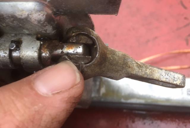

68 fury vent window pivot arm shaft connects to vent window regulator. Need 2 half moon pieces

I need the half moon pieces that slide into shaft that connects to the regulator. Does anyone have these for sale
Is this what you need
how do you get these out? i want to replace my vent window holder/trim? whatever that thing is called that the glass actually sits in and has that ball joint. How do you take the ball joint apart?
If I recall correctly there may be some stake marks from a chisel or punch. You bee to un stake or romove the burrs. Then if you hold the balljoint piece straight with the window part, you can gently tap it off. When you put it back on you will need to re stake.
