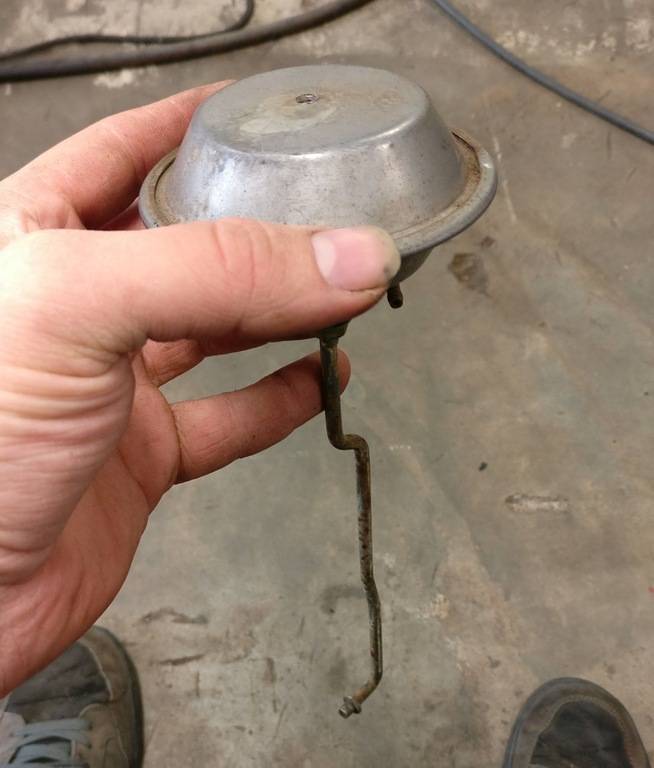

I can't get the one in the back out (with the longest rod) Anyone have any clue how to remove this? I've been able to loosen the nuts. But I cant seem to get it out.
I got the one on the bottom out (with the shortest rod). But it doesn't have any part number? Are these still available?

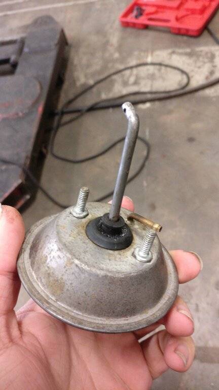

I got the one in the back with the long rod out.
The top vacuum connector broke off, wtf.
I found it still connected to the hose, so I think I can repair it :)

The one with the short hose has a small leak past the actuator arm rubber. Looks like it's fixable too. I hope so.

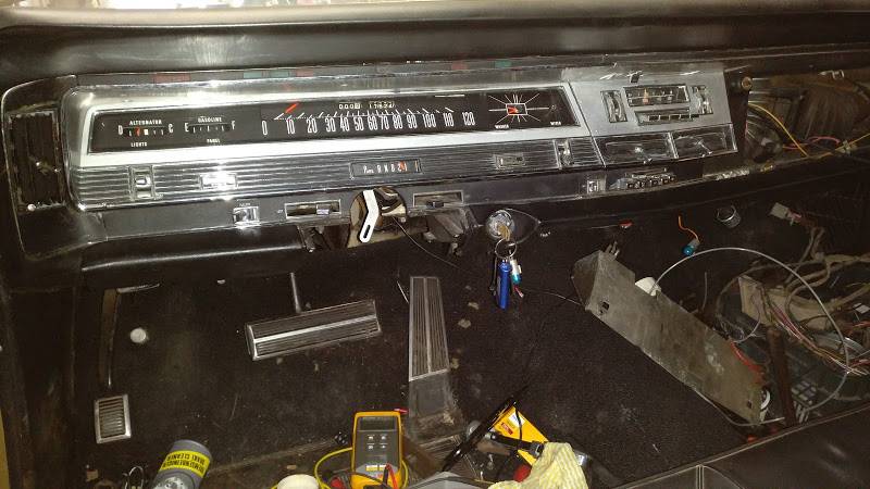

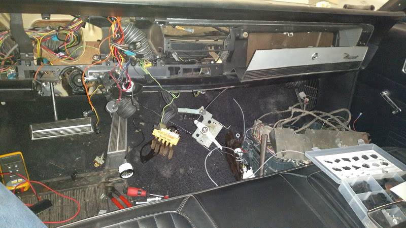

I've partially rewired the dash and the bulkhead connector. And I've fixed all the switches including the dimmer switch. I took that opportunity to install the radio since a previous owner took it out.
I got a AM/FM thumbwheel radio of Cbarge that's working well. My speaker was also toast after 50 years, so I've replaces that while I was busy.
Z6b246P8rxpqbihIvr8dyHd7FPJLD5dGhl2GbqAWYfap-QdozrNdzcklJqQHl0qL13E5gEHJ=w800-h450-no?authuser=0.jpg
zxAgj0itVoxEgVr8acpC4ohCZkyawNPQKFWeoSv32bufV5LpT584nuiKc_oX7fkCtCDZJTmY=w800-h450-no?authuser=0.jpg
Looks way worse on the picture than in real life.
I've restored all the wiring to original specs, but I did bypass the ammeter.
UDG5PIxdflGyrUzpCPSsPdyctFITXAjib3UMR949wbknCJf3EzGLgyYviLfRWhhrkxjtP4i4=w800-h450-no?authuser=0.jpg
Don't mind the mess... :P

After some testing I've noticed that both actuators have a leaking membrane :(

We're you able to fix the broken nipple on the actuator with the long rod. I have two of them that are broken off...:BangHead:
@Metalmarty
@Metalmarty
Yes I managed to fix that one, but apart from the broken nipple it also had a small leak in the membrane.
I ended up with used actuators I got from @detmatt
But fixing the nipple was easy and well worth a try :)
I still have that actuator, I'll take a picture this weekend

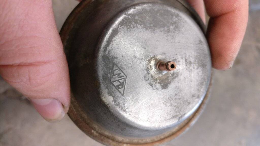

In my case the broken nipple was still attached to the vacuum hose.
I cleaned up the metal around the nipple hole in the actuator and on the nipple and made sure I knew how far It should go in the hole.
If you place it too far into the hole it will prevent the actuator from making the full stroke!
I carefully pulled the membrane away from the hole to lessen my chance to damage the membrane.
Placed the nipple in the hole on the right height, applied some flux and heated the nipple and the metal around it with a small torch lighter.
Applied a little bit of Tin (containing lead ofcourse) around the nipple making sure it flows all around.
Let it cool down, done!
Make sure no tin, flux or debris falls into the actuator through the hole, that will cause excessive wear in the membrane!
