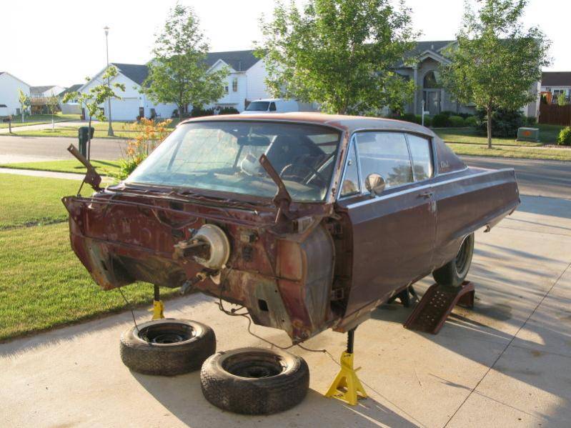

Decided to do a full restore, and to my neighbors and wife's delite (not) started the disasembly in my driveway with a goal to make every thing factory correct & new again.

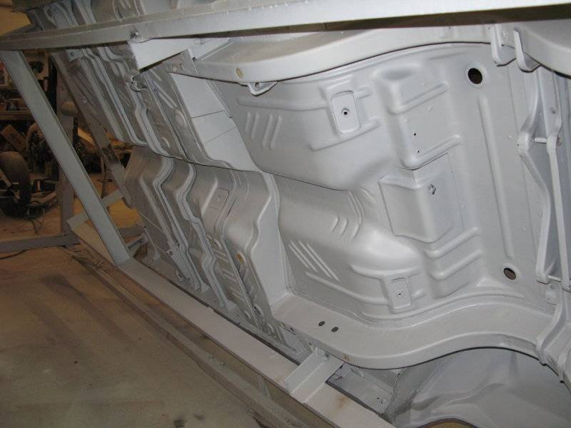

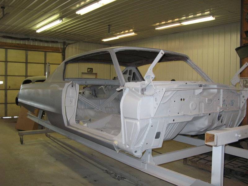

I rebuilt and renewed the drivetrain & suspension, got the body on a rotisserie and sent it off to get the gravel road dents knocked out, college fender dings repaired, and some rust cut out.
Due to kids, floods, moving, time.... Oh and the cost to fully restore I had to take a break.
It is now time for paint and re- assembly.
On wheels in 86 and in teardown mode in 2007

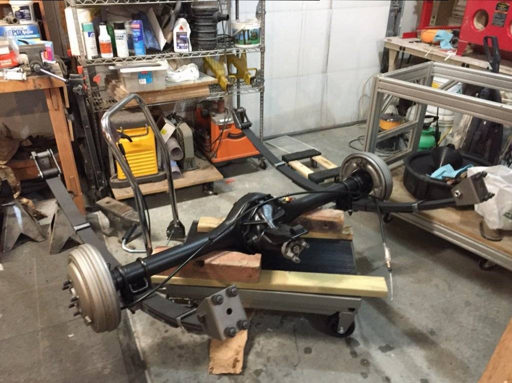

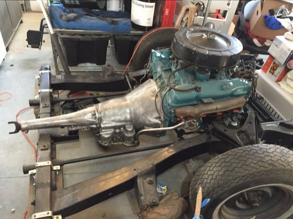

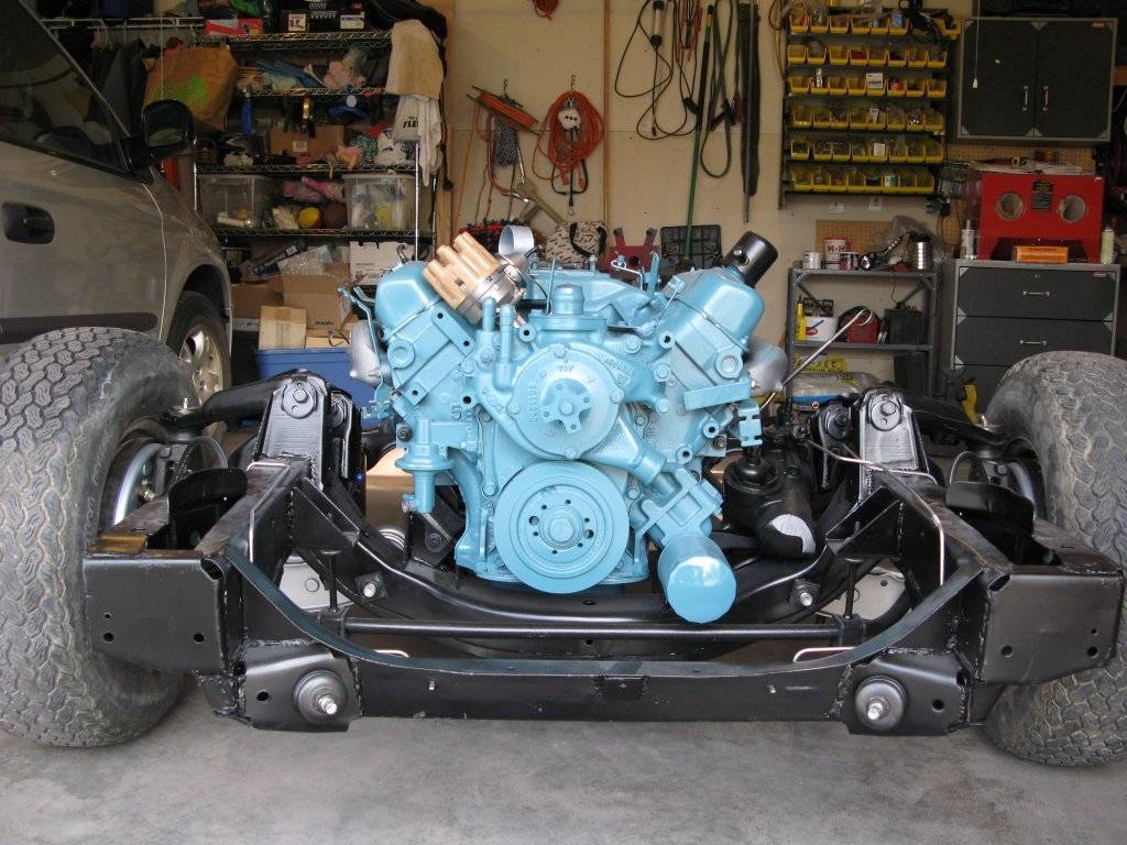

It is about time for color on the underside and firewall, then make it into a rolling Chassis to mount fenders and doors for final spray. Have gone through most of the wire harness, wiped it down, but have a couple of connections to fix plus a melted bulkhead. I am doing / did all the mechanical work myself. Every thing that turns or moves has new bearings and seals - from the power steering gear to the rear end. I don't plan on recouping my investment, beyond the satisfaction of learning about every part of the car and having an almost 50 year old car that is brand new, and been part of my life since I was 2 years old.
Initially I wanted to to the body work, but didn't have the time, and was unsure of my skills to get the body and paint to the level I wanted it.
