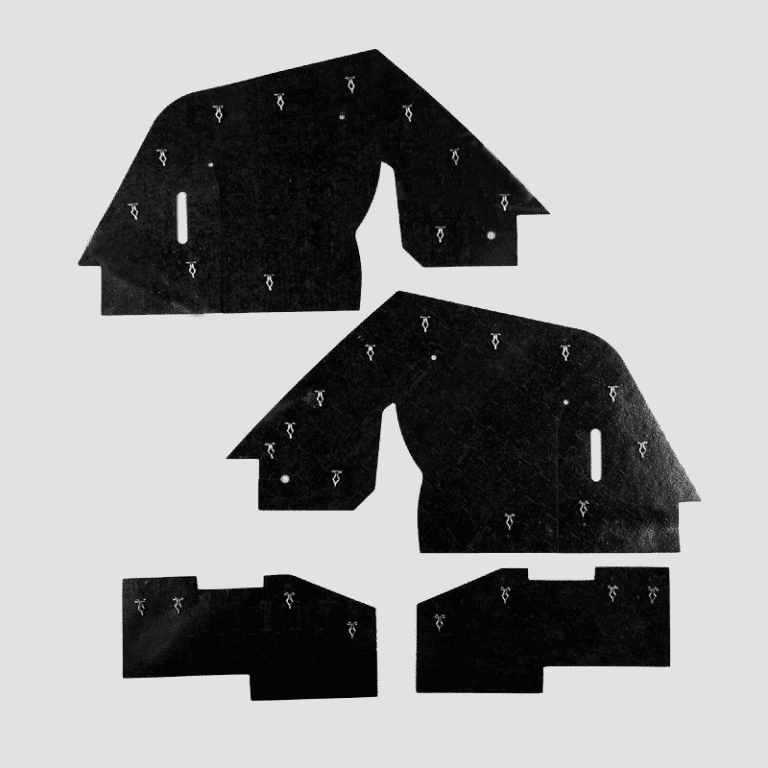

This is for a 1968 Plymouth Fury.
Where do these splash shield pieces go?
I got these from Detroit Muscle Technology and no instructions were provided.

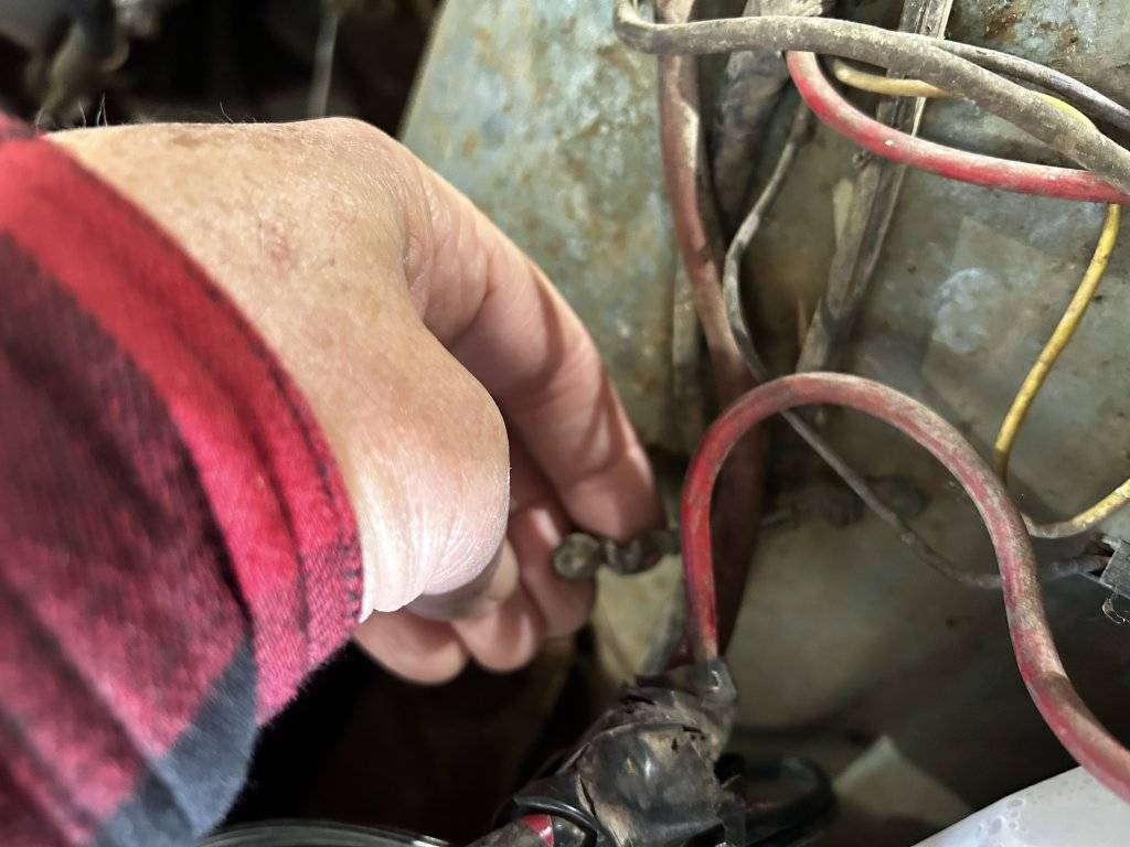

Additionally, where can I get these harness straps?
This is on my '70 300. It's by the sway bar, clips to the frame.
ame
straps...QQE ...814 509 6410 has original style flat ones...the one you are holding is the later type with the extra "humps" for 69/70 ...they are out there from multiple sources, ebay etc...idk when changeover happened may have differed by plant so no idea if yours have already been replaced with later ones 20 yrs ago or if they were factory

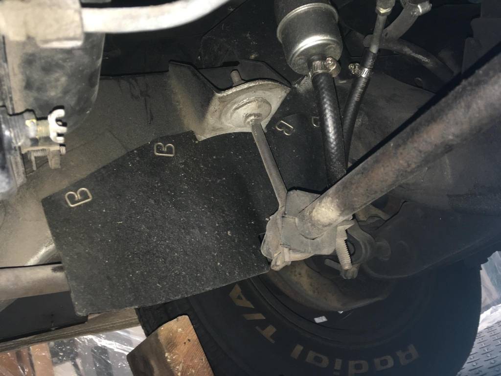

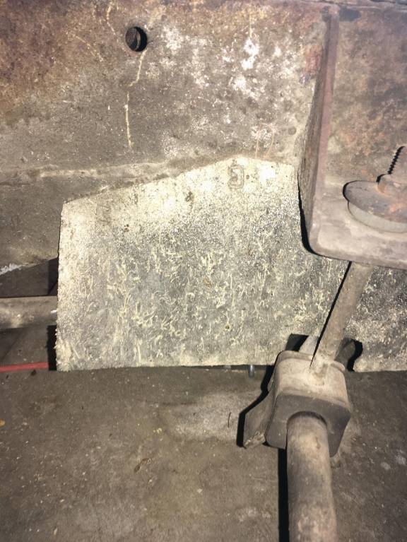

OK, I relented... and went out to the cold garage. I had to put the freshly painted air cleaner back before something happens to scratch it up and figured out I could reach down from the top... which kept me off the cold floor.
Here's a pic of the shield on my '65 300L.
The larger masticated rubber shields are for the upper control arm area. Attach to the splash shield with metal clips. Holes are already in the metal flange they attach to, IIRC.
As to the wiring harness retainers, seems like 1968 was when they changed to the "dual hump" ones? But might have been 1969. The '65-'68 items are smoother by comparison and seems like the nub holes' width is a slight bit off from the "more popular", similar looking ones?
Some of those little details can make a big difference in how things look.
