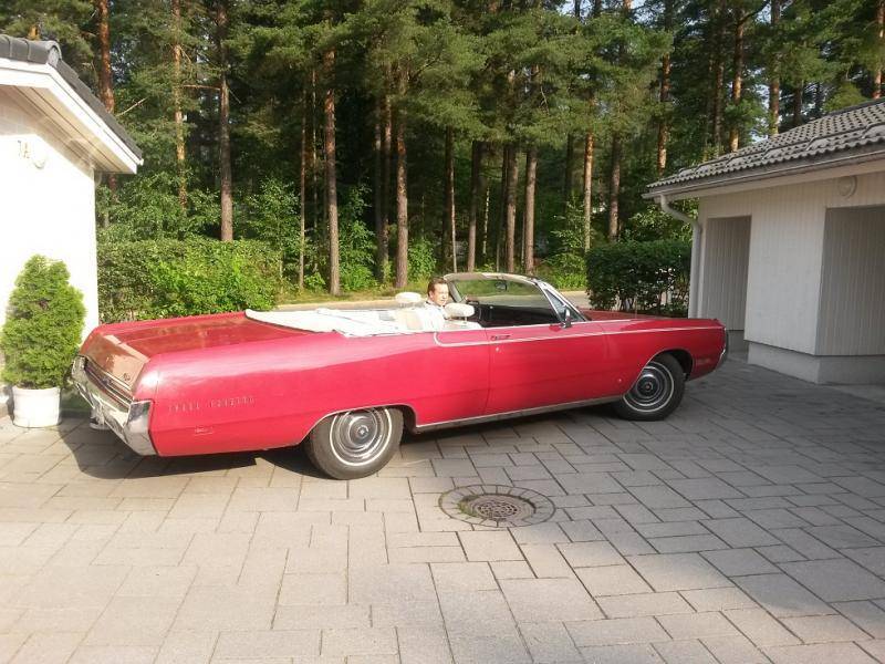

Here´s the pic about my 300... this is my first C body and it´s very cool ride!

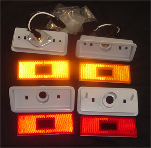

This is what my 69 Sport Fury has ..............
Now I have seen these lights from a 1970 "B" body and they look like they may fit.
I like those. I've never seen them, and they look like they will interchange with the 69 reflectors. Do you know the actual application ..... ? or are they aftermarket .....?
This is where I found them while searching .........
http://www.jimsautoparts.com/lenses.htm
1970 PLYMOUTH B BODY SIDE MARKER ASSEMBLIES
NEW!LN-VML700 1970 Plymouth B Body $ 219.95/set

Wow, I just found this thread and a pic of your car, Jymy... It looks great! Congrats!
And sorry for the off topic... ;)
Thanks for the compliment and congratulation is definetly not off topic :icon_thumright:
