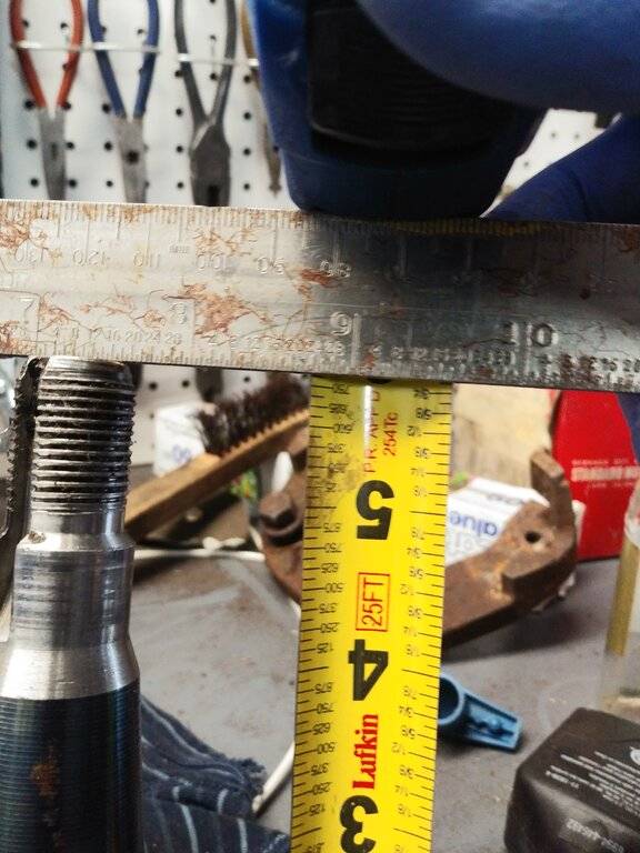

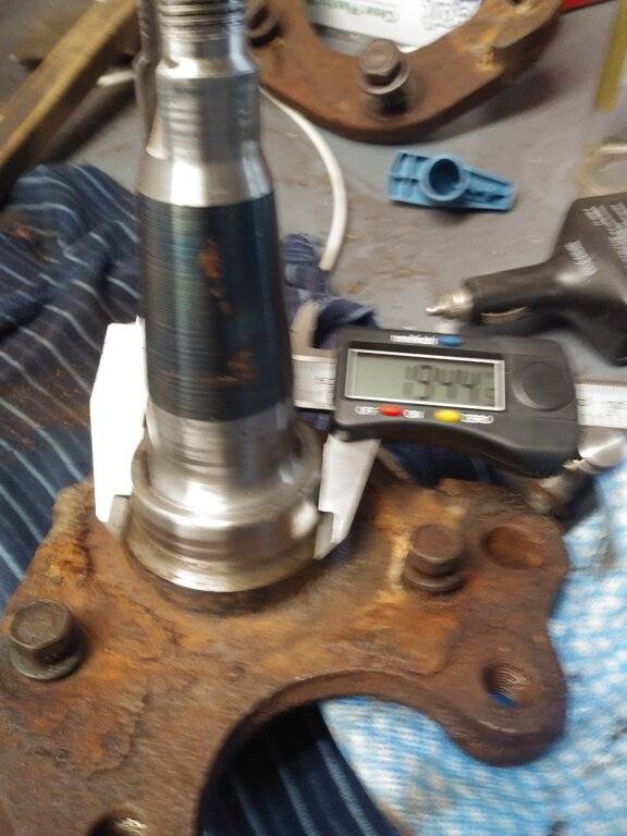

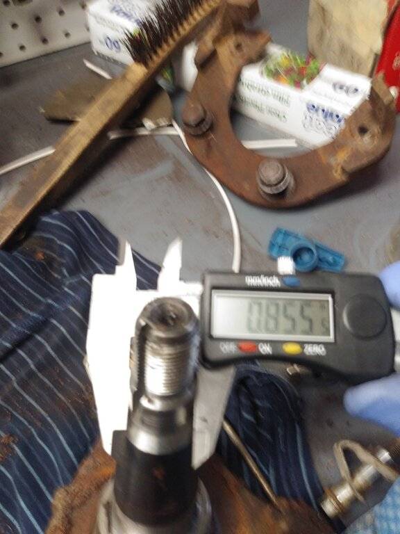

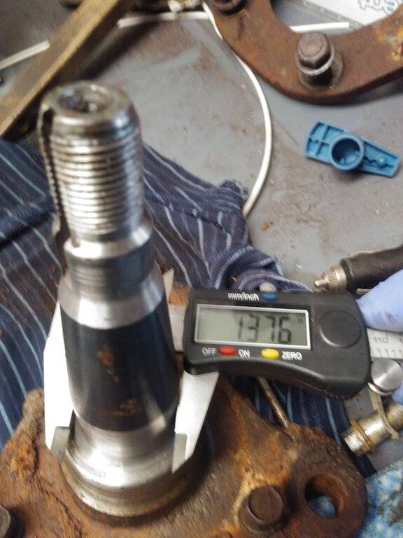

It appears as though I may have scored 73 spindles. Measurements seem to line up with data found on this forum, although I couldn't find '69-'72 spindle dimensions. Thoughts?
Your 1.375" measurement would be 1.250" if they were '69-'72 spindles. I would have no problem using the asbestos brake pads- they probably are better than anything available today.

The other verification would be to check the ID on the front wheel bearings as to model year, via aftermarket brand listings as OEM Chrysler part numbers will not yield that information.

Let's try to clear some of this up. Chrysler changed the spindles mid year 1972. So 1972 models had them also. The best way to find out is to mount the 1973 inner wheel bearing on the spindle. If it goes on without any slop, you have late 1972. If it is real loose you have the early ones. The early spindles work fine, but you do need the correct rotors and bearings.
