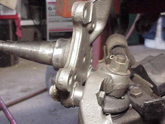

Complete setup from the Cordoba. The spindles/knuckles, 11.75 disc, calipers, caliper brackets, spindle nut, spindle nut retainer, spindle dust caps and hoses.
Retained the ball joints, tie rod ends from the 64 New Yorker.

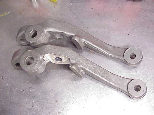

The Cordoba spindle/knuckle steering "arms" are an inch shorter than the New Yorkers. This results in faster steering response, I like it. Lock to lock is 2-3/4 turns. Much better in parking lots and turns in general. No noticeable difference on the highway. No bump steer. No detectable Ackermann Steering scrubbing problems when the wheel is turned hard over in parking lots. And I assume more stress on the steering box, idle arm, tie rods, and drag link.
The spindle/knuckle is 1 inch shorter between outer ball joint mount surfaces. The "top/upper " ball joint knuckle hole is "1 inch lower/1 inch closer" to the spindle wheel shaft. This results in 1 inch less wheel drop in suspension travel. There is no binding anywhere in the steering or suspension, not even close. Alignment is now 0-camber, 1-degree+ caster, 1/4-degree+ toe. Tires are 255/60R15 on 15x8-4 inch back spacing, no interference, could go bigger.

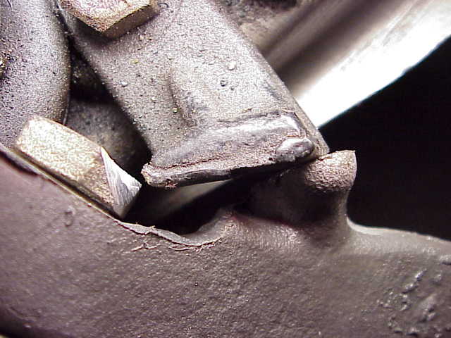

The steering stops "do" line up but the surface on the "knuckle" does need to be reduced (ground) 1/4 inch to achieve minimum turning radius.
The protruding threaded end of the caliper bracket bolts must be trimmed 1/4 inch to archive minimum turning radius.
The upper bump stop metal pad "must" be trimmed to clear the caliper and caliper hose when wheel is turned hard over. This leaves plenty of pad left to make full contact with the rubber bumper stop.

Edit, I also used the steering arm from the 78 Cordoba.

I don't know that nice is the word to describe the 78 Cordoba swap. Fortunately, it was a relatively painless install and works well but it has its concessions. Being shorter steering arms that turned out to be a very good thing, so far. And shorter knuckles that reduces travel wheel drop by 1 inch, not a problem so far, I don't think it will be.
