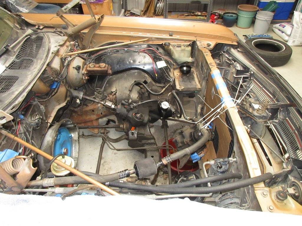

I pulled the engine, tranny, etc.. Fast forward a couple months, started re-assembly, installed engine, installed tranny (A727) and then tried to re-install transmission cooler lines. Which do not fit.
Other than bending the crap out of the new lines or removing the engine, are there any gems of wisdom on getting these lines re-installed? Nothing in the Service Manual that I could find.
Someone should really mark these "Re-install first"!
Thx
You can raise the engine on the left side if you have the exhaust out and slide them in from the trans side first.

Right here with you on this one, now that mine have been out for so long i cant remember how i got them out much less where they disappeared to. Ordered a new set and spent an hour trying to visualise how they are routed.
From the pic you are showing the lines are routed on the driver side of the car? This may be wrong? It seems like mine route along the block on the passenger side?
