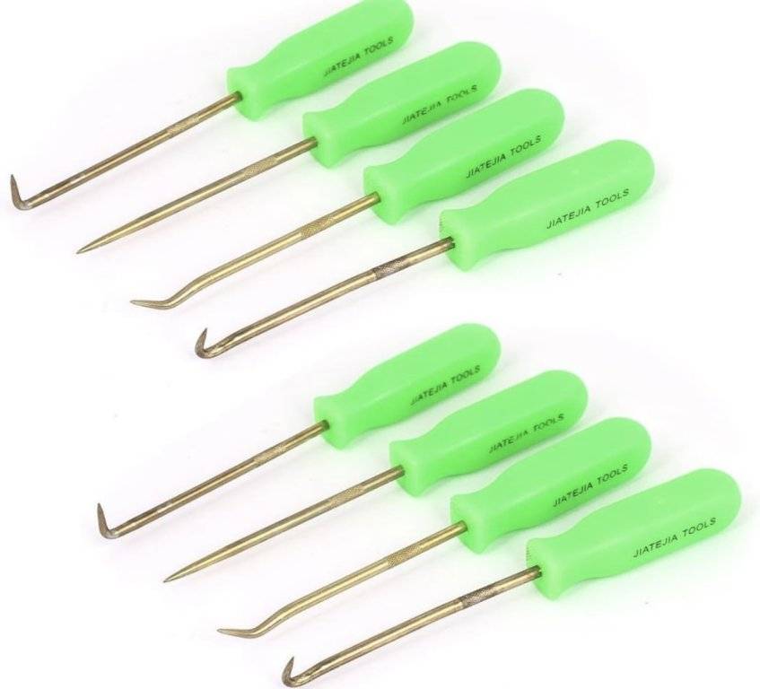

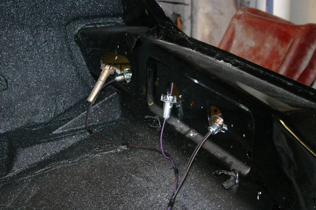

This might help
Alan
You might need a right angle pick tool (this picture is a set from Amazon) to help snap the lamp housing out of the tail light housing, after getting some penetrating oil in there (PB Blaster, Kroil, or Liquid Wrench, etc).
