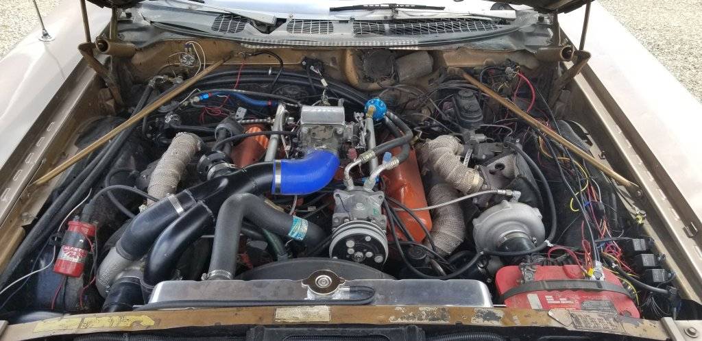

At some angles, if it has AC, there's not much to see.
My 1970 440, wrong color air cleaner but factory intake and HP exhaust manifolds.

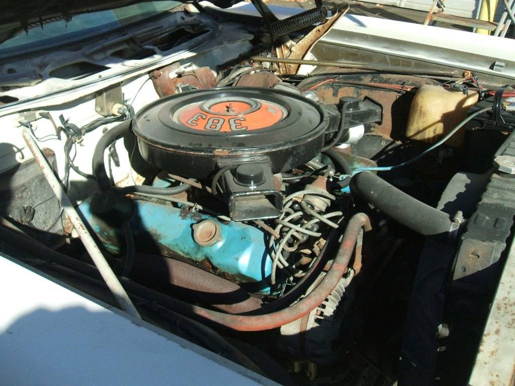

Plymouth should be Super Commando pie tin,
383 Pie Pan

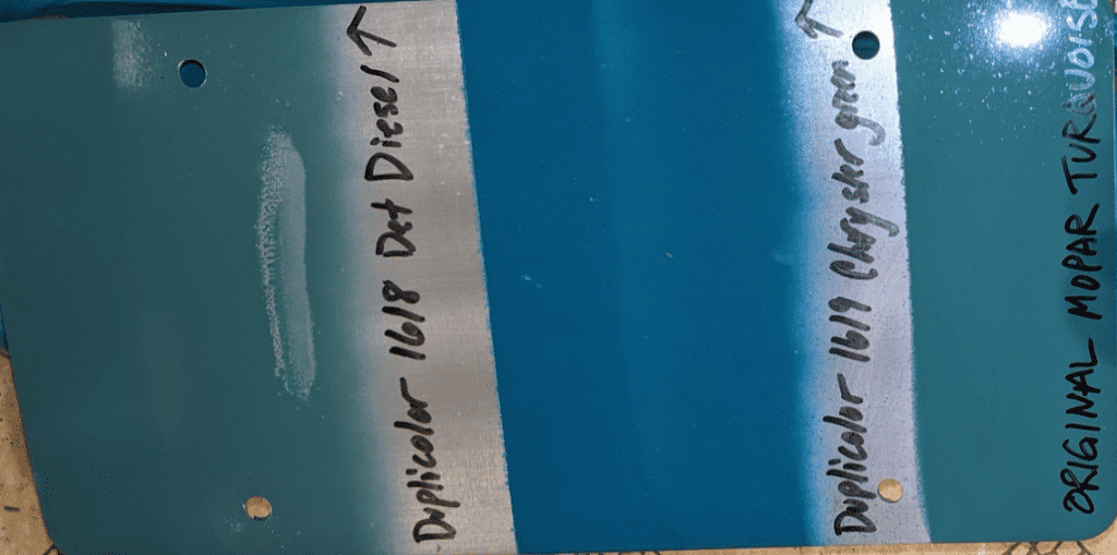

The accurate color in spraycan is difficult to obtain. Mopar's version is now incorrect hue, reportedly Bill Hirsch has a good one but pricey and/or weeks to obtain?
I've found Detroit Diesel Alpine green is a reasonable substitution unless one is a purist.

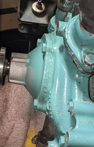

It is a bit lighter than this picture shows, though, look at the water pump vs the front cover, which is the correct Mopar turquoise from Summit.
Here are some samples I did, the 'original' is an old can of Mopar paint from Summit.

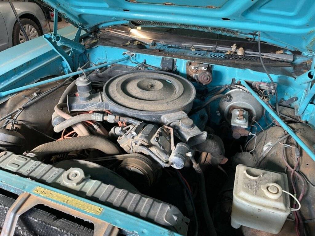

This is the closest I've got for no AC.

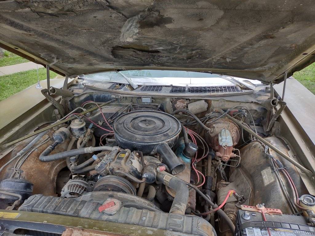

Is a 71 Polara copcar, so the paint color is iffy, breather on the passenger side VC and the aircleaner are different.
71 has multiple hoses off the breather and 1 wraps around back of the aircleaner to connect on the driverside snorkel.
