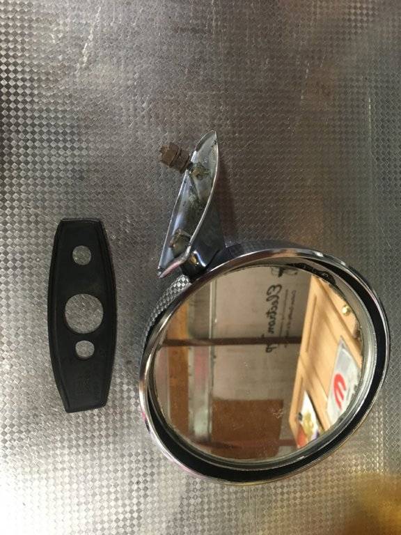

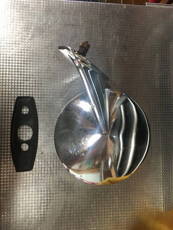

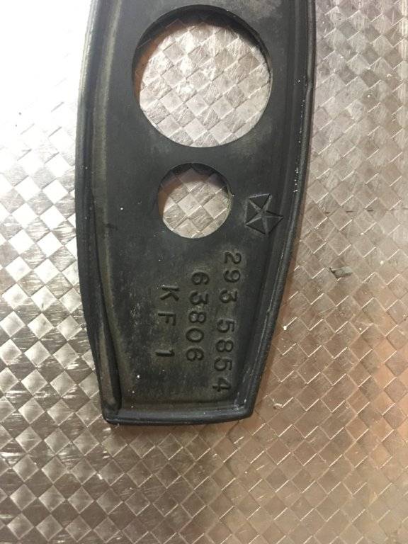

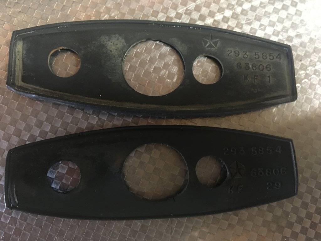

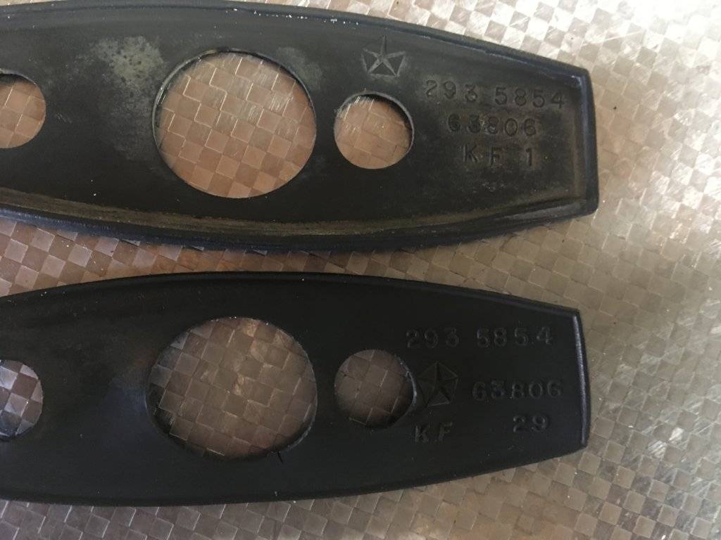

Here are a few pictures of my 69 fury passenger mirror and gasket, they are the same as the 70. I had 2 gaskets and both had the same part number . One seems a bit thinner than the other but they both fit on the mirror . Hope this helps.
Any drivers side gasket should work for the passenger side mirror and there are a lot of those out there.
The one gasket is wore though and I would like to keep the other as a spare
