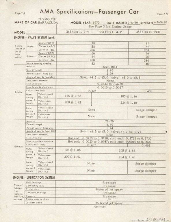

Code "N" variations, from the AMA Specs (1970 Barracuda) found in the Hamtramk Historical website. Not sure how you would order a 383/330 vs a 383/335, unless there was a separate option code to separate the two. Or if the 330 was in the non-'Cuda models?
383/330 "N" 1970 -- 256/260 cam 4732S AVS 1.44/1.69 9.5 CR
383/335 Hi-Perf "N" 268/284 cam Holley 4160 1.56/1.75 10.5 CR
Listed distributors/specs were the same for both "N" motors.
Both had the 10.75" diameter torque converter, with less fluid refill capacity.
1970 Parts listings confirms the 2bbl cam in the 383-4bbl engine and the 440/350, but only the 440 HP has the 268/284 cam listed. No carline differentiations.

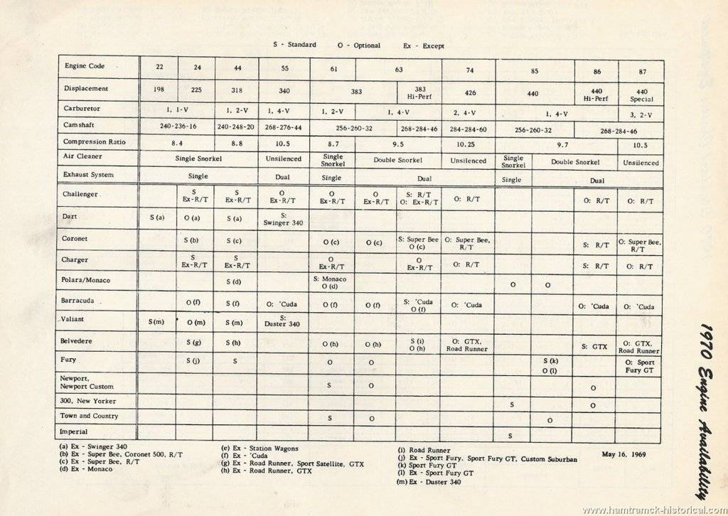

Final determination of 383 "N" E63 variations. Further research in the Hamtramnk Historical documents.
The E63 code is listed as "383 Hi-Performance" in the order guides. In the B/E-body listings, the same order code is listed for both the 383/330 and 383/335 engines. Cam variations, as noted above, are different. The "N" code in a normal B-body or E-body, is the 383/330 version. The "N" code in a 1970 Challenger R/T, Coronet Super Bee, or Belvedere Road Runner is the 383/335 version, where the 383/335 is standard. All C-body "N", police or not, are the 383/330 variation.
Police B-body "N" are the 383/330 variation, also.

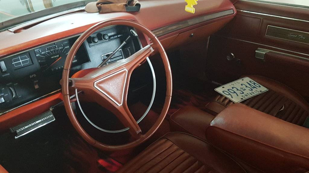

On your profile picture it looks like a 6 pack aircleaner and red /burnt orange interior.. Do you possess the holy grail of c body fusies (440-6 SFGT X9 outside K3 inside??)
I wish it was but no my car was a 383 car but now has a 440 4 barrel Dana 60 with 354 gears the car came from the factory burnt orange with burnt orange interior
