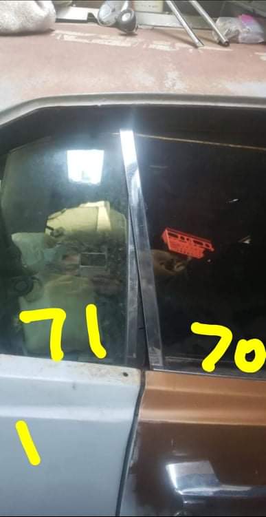

The pics below show what I found was the spare quarter windows I got with the car are all the wrong ones. The windows are the same except for the angle at the front (see pic).
So now I need a driver side tinted quarter window.
Two questions: 1. anyone have a driver side quarter window for a sport fury? and 2. Do you guys know what the spare windows I have fit?

I had a 29 body parts car, 1970. I have a 27 body, 1970 convertible. I found that the 29 body door and quarter windows are taller than the 27 body. They are also different from the 23 body. Further, I know for a fact that 1972 and 1973 door and quarter windows are different than earlier door and quarter windows. I wonder if there any factory part numbers on the glass, by which someone could identify your quarter windows.
Of course, you could ask the previous owner what cars he got them out of. If he knows something about Chrysler's, it might at least narrow down your search.
69 and 70 match then 71 changed. But I'm not 100 percent on the roof line's I don't know if 23 roof and 29 are the same in 69 and 70.
Sorry one more question do you know if they were the same for Dodge and Chrysler?

I can look in my part's book but I do believe Dodge and Plymouth were the same Chrysler might be also. The book will tell me as far as year's I believe 72 changed again.

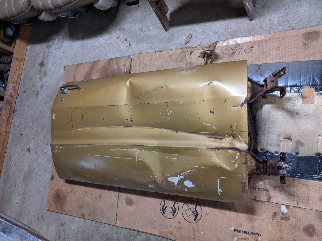

Wonder if 70 & 71 vertical runners have same arc also. I used a 70 door shell and runners with 71 door glass.
71 door picture is pretty much explains why

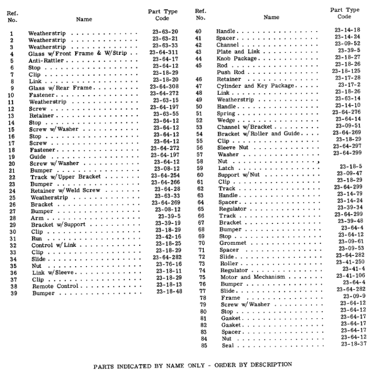

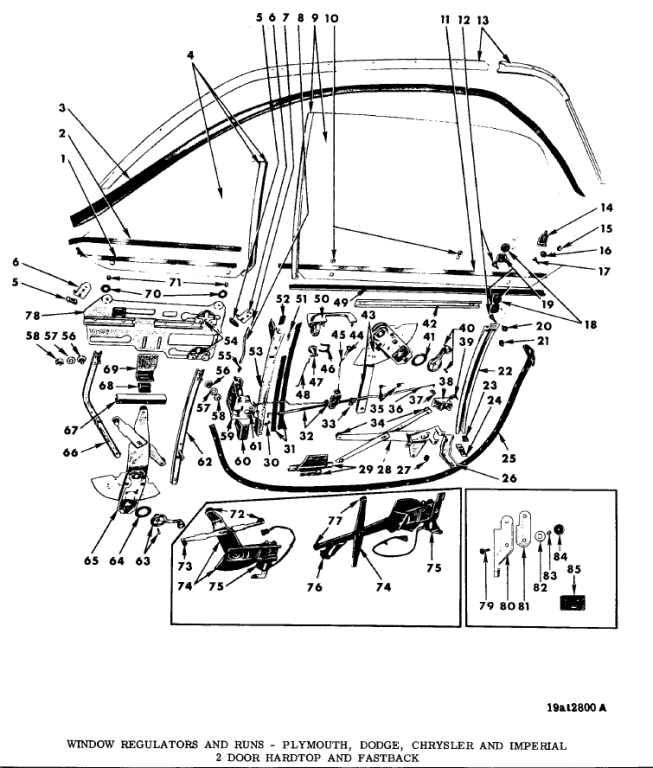

This first page of the parts books shows the runners 22, 53, 62 & 66.
The second page shows the part type code. 22 = 23-64-254, 53 = 23-09-51, 62 & 66 = 23-64-299

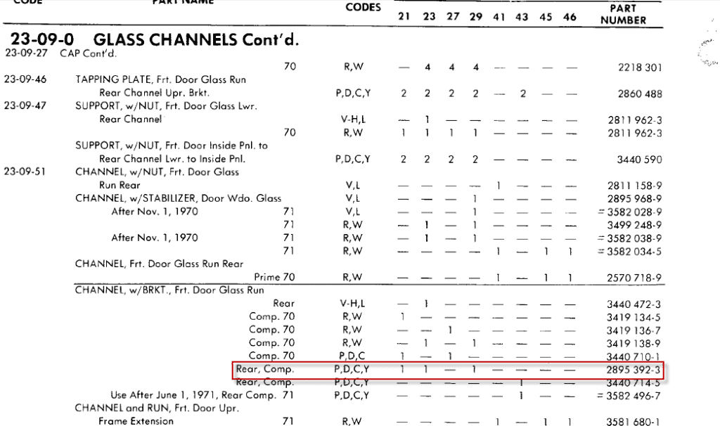

The next page is part code 23-09-51 for the rear door window track and it shows the same part number for body 21, 23 & 29
The next page shows part code 23-64-254 for the front door track and it shows the same part number for body 21, 23 & 29

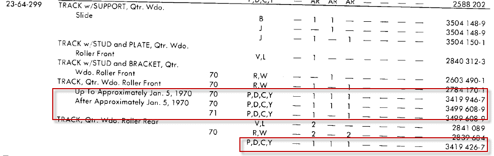

The last page shows part code 23-64-299 for the rear qtr window tracks. For the front is shows one part number for before Jan 5, 1970 and a different part number for after that date. The rear shows the same part number for both years.
I would say based on the parts books the tracks are the same for the doors and the only difference is the front track for the rear qtr window but that part number could have changed because they used a different stud of something. My gamble would be that the tracks would work from 69 to 72.
