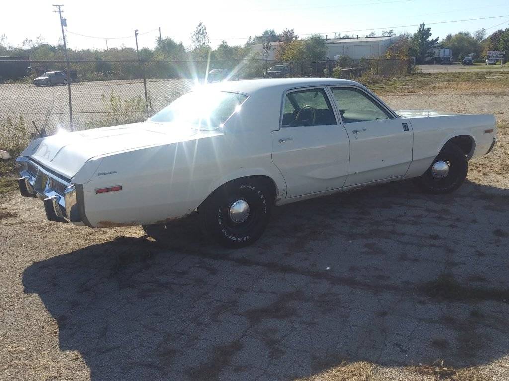

Hard to find but they are out there
Heres one I had for a short amount of time about a year ago. It was as original as it could get. Drove to Missouri and put away in 1985 shortly after it was bought at a Police auction in Grants, New Mexico. The family bought it for the drivetrain for a Charger project that never took off. Thankfully.
They are out there. Gotta keep looking and be ready to jump when you do find it.

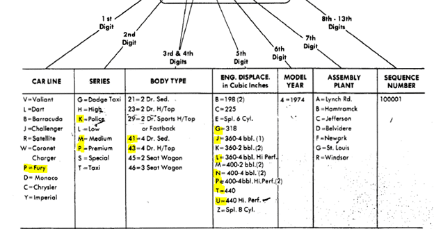

Finally, here's the brakedown of the 74 VIN. The 74 did not have the 383, they switched to the 400 by then.
