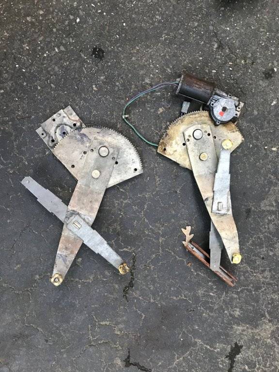

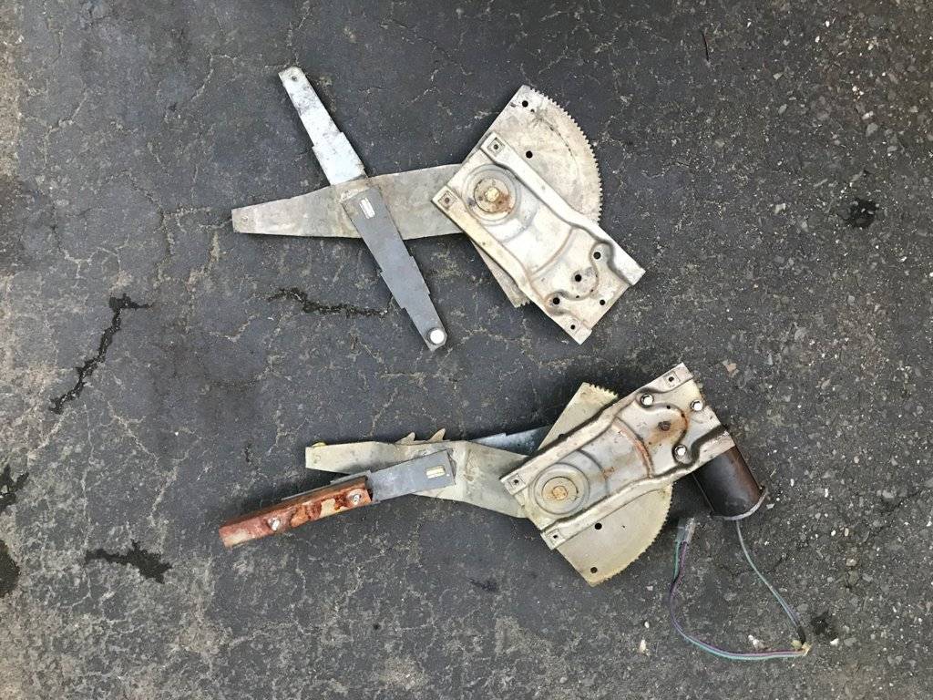

Here is what I have from the ‘73 coupe. I’m not sure how they compare, or if they would work for earlier models.
Rear quarter windows:
Doors:

Looks like I dropped the ball on this one. First I forgot all about it. Then I went up last night to look for them, and in the box that I thought they were in, were regulators from a '68 GTX. Now I have no idea where the Chrysler ones are, and it could be years before I find where I put them. I did re-check the parts book, and I was incorrect on the rear ones. They are the same for all coupes and convertibles from '69 to '73. The front ones do have a different part number for '69-'70, and '71 to '73. Anyone else have a '69-'70 coupe front door power regulator laying around?

Looks like if you and Samplingman swap front regulators, everything should be perfect. He needs the '69-'70 style.
